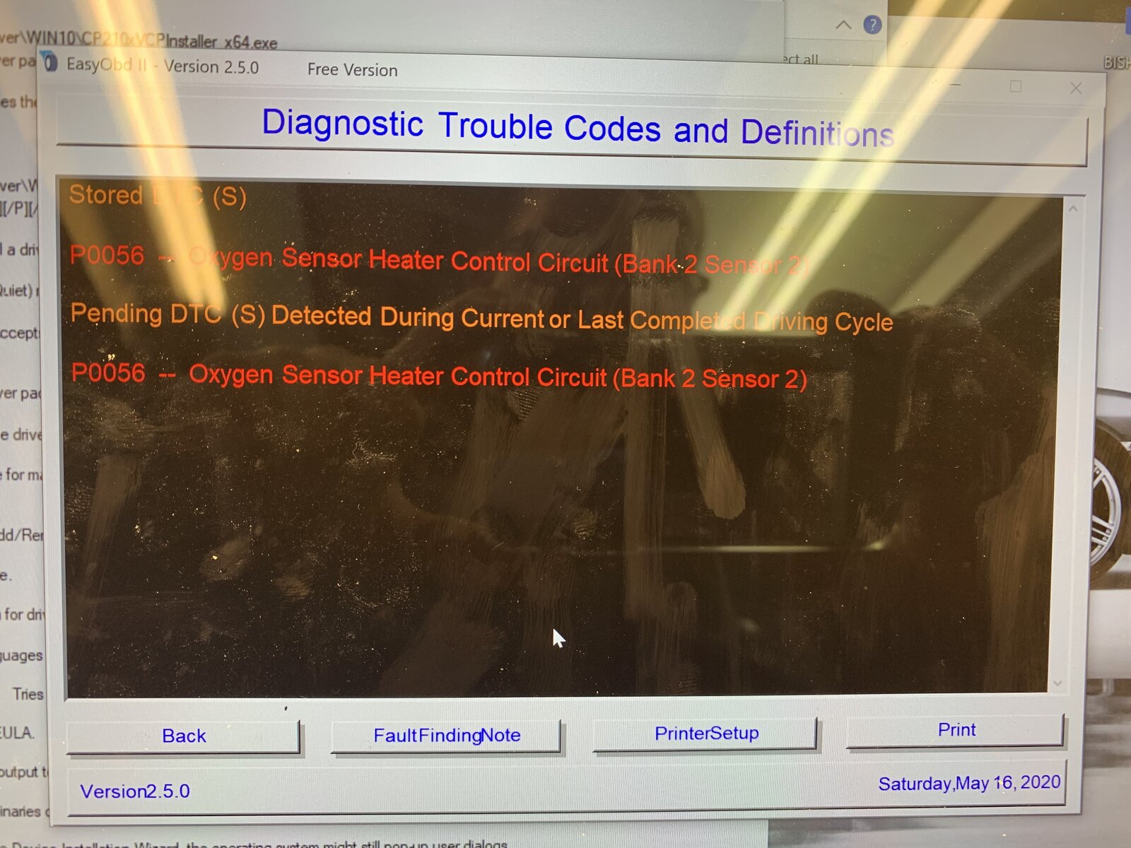

  4. Ok guys quick update I couldn’t get the Ducati software to work with the units I bought however the odb unit did come with software on a cd rom so popped that onto the laptop and plugged her in
    The unit showed codes (see photo) and a few other options as well including reset eml light
    I didn’t do the reset as I’ve got a Ducati dealer replacing the o2 sensor as their system said it had failed permanently and didn’t want to skew any results they had however the fault code is pretty accurate, I may need to muck about a bit more to get the Jpdiag stuff working with this unit but the fact that it talks to the bikes ecu and retrieved fault codes means it does work up to a point
