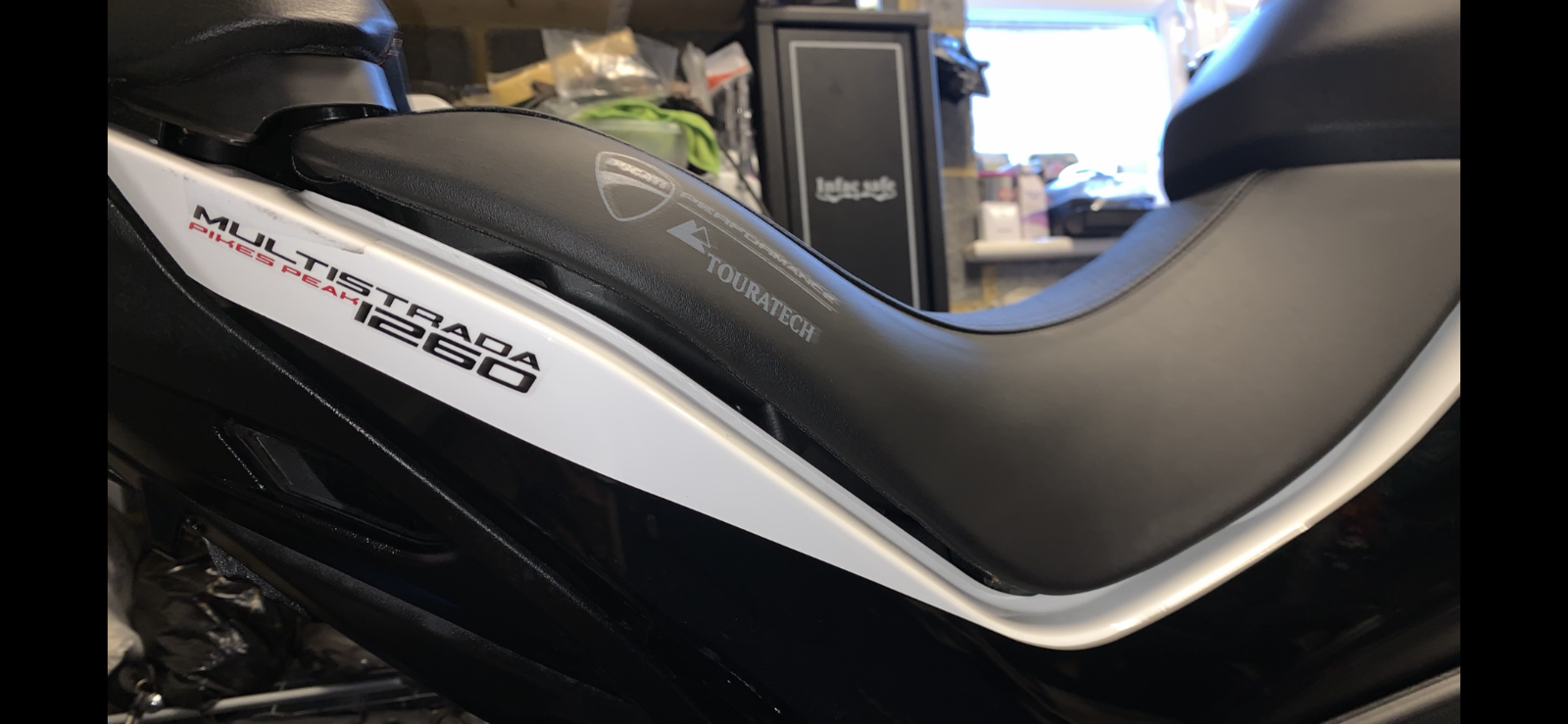

  10. I’ve just fitted the Touratech comfort seat and noticed a gap that I can’t seem to fix. Is it me or the fit of the seat?
  11. That doesn't look right. I have my seat in the raised position with the spacer and there is a gap between the spacer and the side panel from a low angle but nothing like that.
  12. Make sure the front lugs are properly engaged, it doesn't look as if they are. If they are then it is definitely not right. I have mine in the lower position and there is little gap if any.
  13. Think it is engaged at the front and must admit there was a similar but smaller gap on the standard 1260PP seat :(
  14. But there are two slots on the part that the seat engages with; one for the higher seat setting with a spacer and another lower one for the low seat setting. Are you sure it's not in the upper one? Pretty sure that's what VeeTwin means...
  15. Ah I’ll look at that tomorrow. It does look a very snug fit at the front though. It’s also a bugger to get off once it’s on!
