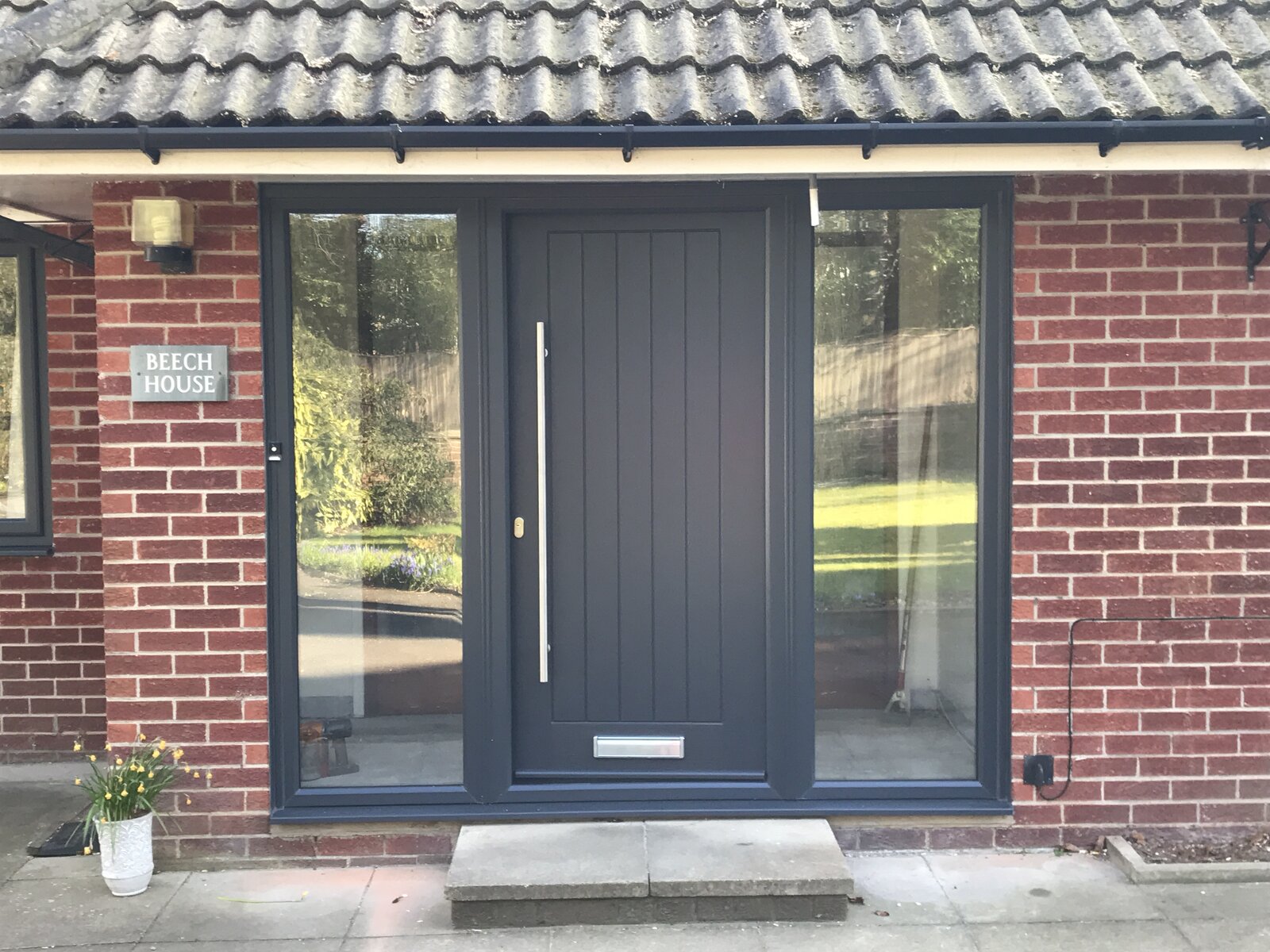

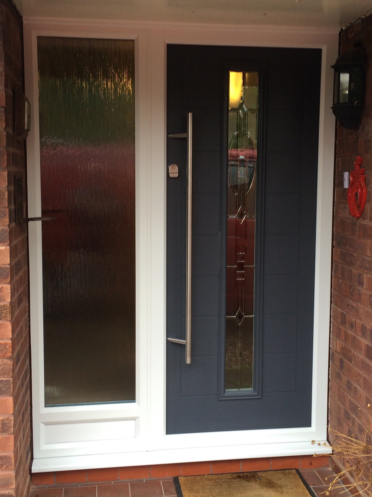

  3. Supplied and fitted from £1500 inc vat, you will need a Fensa/Certass registered installer. fitting should take a day, prices vary alot, look here https://www.eurocell.co.uk/homeowners/upvc-doors/the-dales-collection-composite-doors , get a price from them online, i get 30% discount pre vat, that will give you a good idea on actual cost, fancy glass options are expensive and the in fashion colours are more expensive as they are a white door slab sprayed, they are well worth the extra over a upvc door.a few i have fitted below.

  6. I bet your postman must hate that your letter box is so low.:)
  7. I did apologise actually :)
  8. That's about the size of my opening, but my door is to the left :):upyeah:
  9. Went for 900 door,makes all the difference imho
