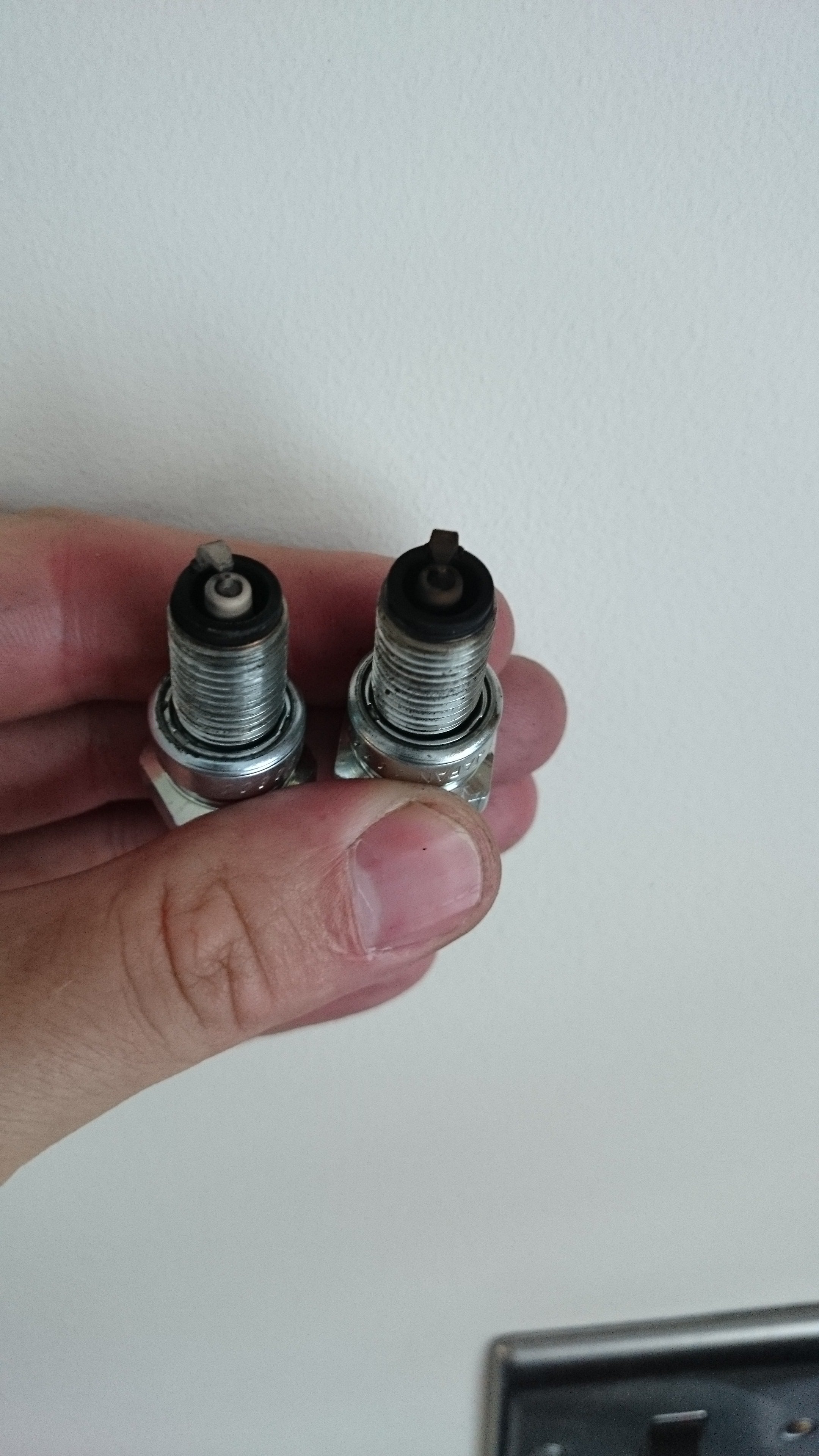

  6. So I got some Lucas engine oil stop leak, put it in and went for a run then checked compression yet again.
    Engine got and this time I twisted throttle ( suggestion from this forum) which helped and guess what, it have me 150psi on rear and 160 on front. Attached is a pic of the plugs too.
  7. one looks not bad the other a bit rich
  8. My 750 has 32K
  9. 150/160 is more like it, throttle wide open, engine hot and no plug in the other cylinder is the way. :upyeah:
    As for the plugs, I'd be checking the carbs...
  10. For starters, I say turn the pilot screw in one turn on the sooty cylinder (don't expect pilot screws to be set the same -- float level can affect them) but also check the main needle is on the same notch (You would be surprised how many people can't get the clip in the same place on each needle)....
