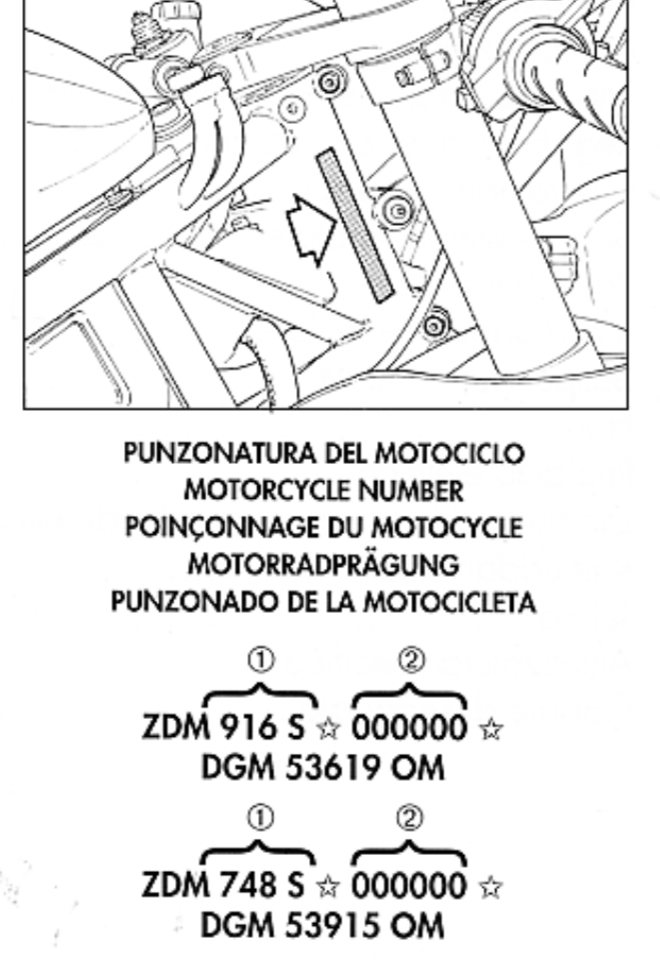

  5. Sorry for thread resurrection/hijack.
    My friend has just bought a 748 and the VINs on the head stock are:
    ZDM748S*xxxxxx*
    and
    DGMxxxxx OM (also shown on a sticker on the frame as DGMxxxxx BOM
    I can't find anything that matches - any ideas out there?
    #25 bigjimmyb, Nov 13, 2023

  7. VIN should be 17 chars?
  8. Yeah, every site I've tried says same, but that is all there is - I have a photo of the headstock to go by and am 100% that is all there is.
    V5 has same number.
    Has he bought something 'different'?
    #28 bigjimmyb, Nov 13, 2023
  9. ZDM748S*xxxxxx* Is the VIN, including the *’s. The older bikes didn’t have 17. Maybe a more recent standard? I don’t know.
    #30 nelly, Nov 13, 2023
  10. Thanks Nelly. It's a '98.
    As I understand it:
    Z - Italy
    D - Ducati
    M - Motorcycle
    Then '748s', then the number (009004)?
  11. Normal 13 digit VIN from a mid/late 1990s non-US Ducati 748. I think I remember something about the DGM number being the homologation number for the type of bike (« OMologato »for « Approved »).
    Here is an extract from the 1994 916/748 Workshop manual :
    The 17 digits system was later extended outside of the US exports (1999, when TPG took over, maybe?) but the coding remained different between US and non-US bikes.
    Extract from the 2002 998 Workshop Manual: BB6B9A1B-DB69-4FD3-980F-F140FFA56F54.jpeg
    #32 Guillaume69, Nov 14, 2023
    • Useful Useful x 2
  12. Merci mon ami. That is very helpful.
