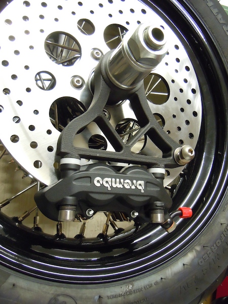

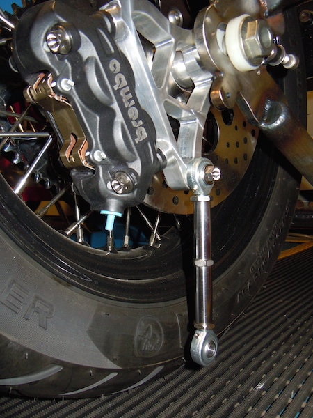

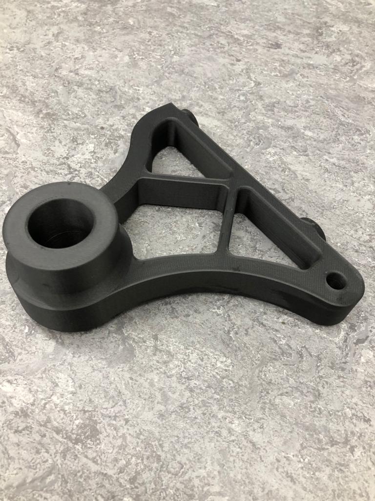

  7. Went round to a mate's yesterday who has done a drawing for me of a rear caliper mounting bracket. The 3D printer has just finished printing one so I'll get it tomorrow & see how it aligns with the caliper & disc before getting the final version machined.
    This new fangled 3D printing thing is brilliant, I love it :upyeah:
  8. Got the bracket today & fitted it to my back wheel. Everything seems to line up OK & clearance either side of the disc, between the caliper, seems good too. Measurements must have been good ! ;)
    The two white plastic spacers will not be there on the finished part, we had to trim the bracket down somewhere to get it to fit on the printer bed, so we took 5mm off the two mounting posts.
    I'm quite happy with that so the next thing is to get one machined.

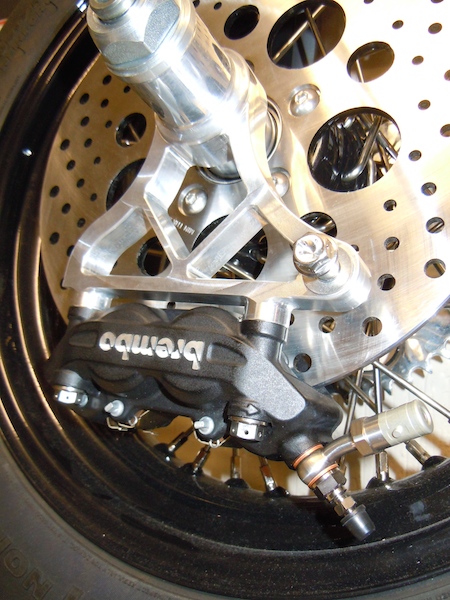

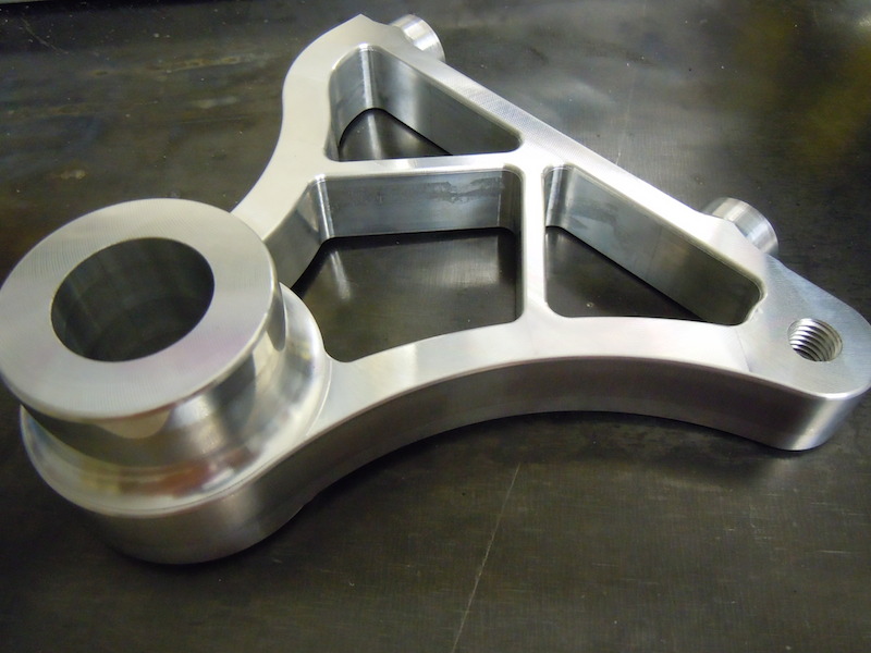

  9. Progress is very slow at the moment, but I have ordered my frame, which should be ready in August & today I collected the rear caliper mounting bracket that I've had a local engineering shop make for me. Very pleased with the result & it all fits & lines up correctly.
    It needs anodising, but that will have to wait until all the alloy parts are finished because there is a minimum charge the anodisers have.

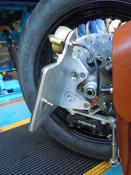

  10. And on the wheel with the caliper fitted ........

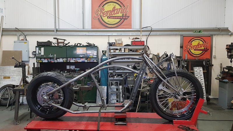

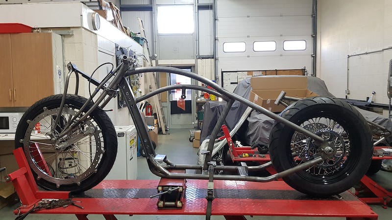

  12. It's been a while, but my frame is now ready for collection !
    Now I can get going, but it will still be slow !!!

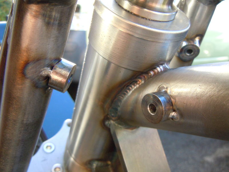

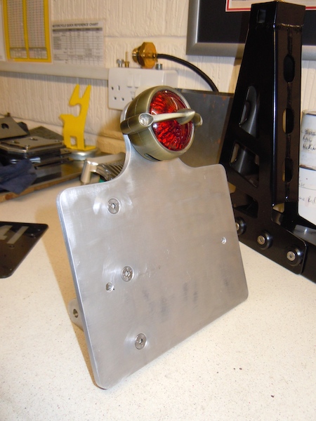

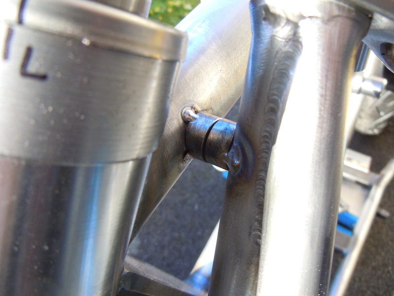

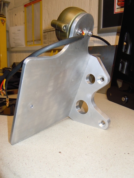

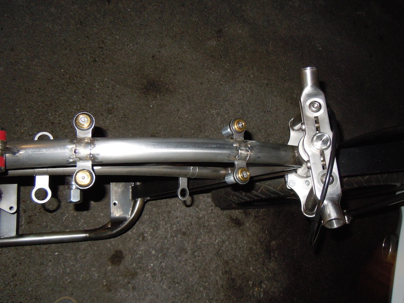

  16. Just waiting for some brackets to be welded, but in the meantime I made the number plate mount & rear brake torque arm.

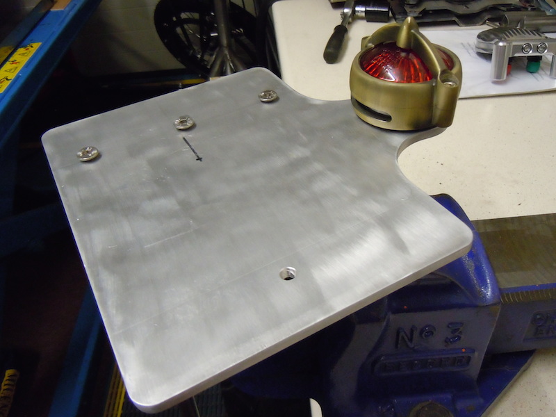

  17. Number plate mount is almost done now, just need to open out one hole to 30mm diameter.
    Saddlebag mounts are tacked in position too.
    And, upper fuel tank mounts are also tacked in position.
    My welding isn't good enough for final welding so I get a mate to do that for me.
  18. Number plate holder is now finished apart from final rubbing down, anodising & extending the wires to the light.

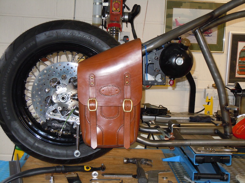

  19. You lost me on the saddle bags.
  20. He has matching chaps.
