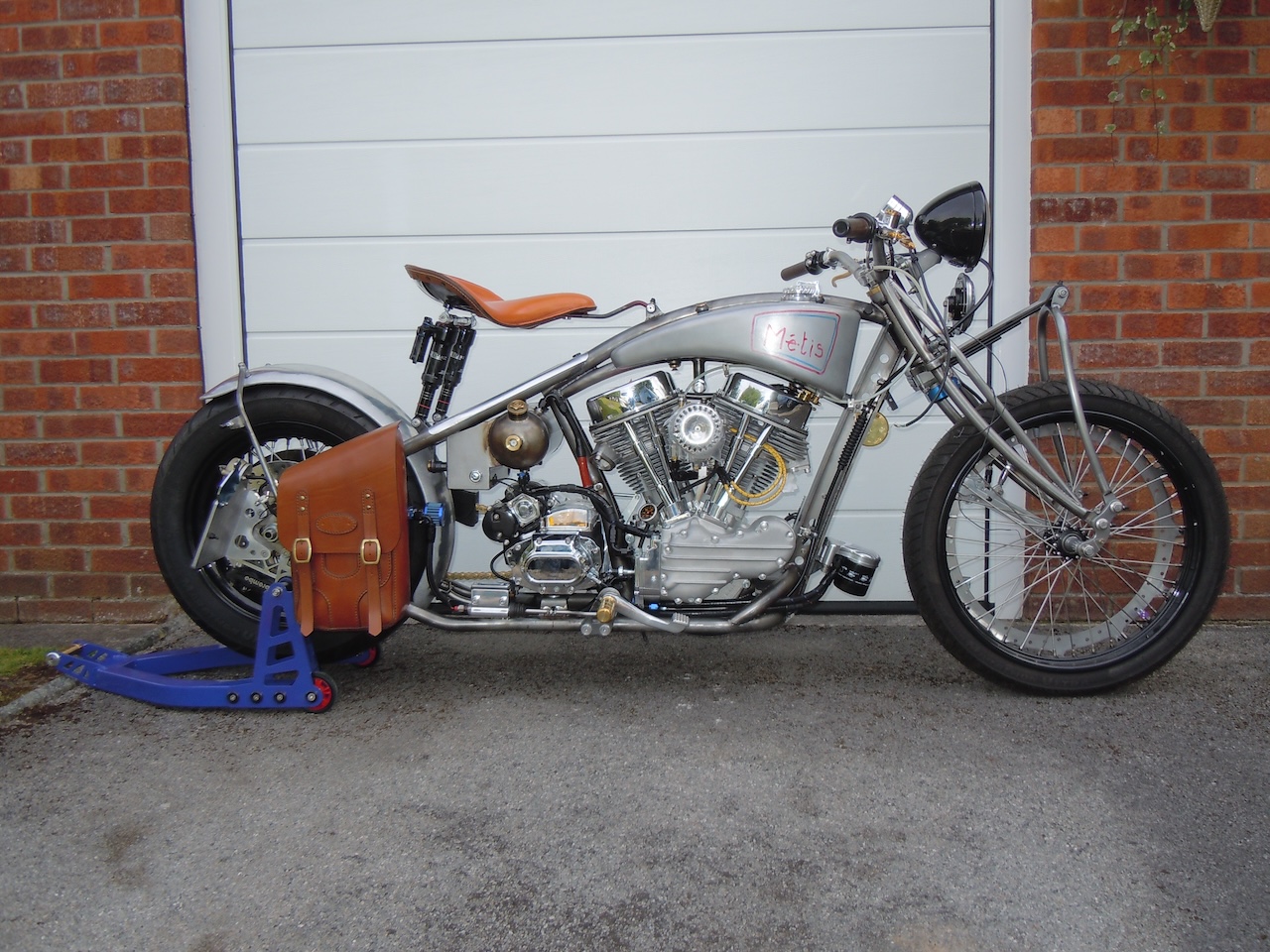

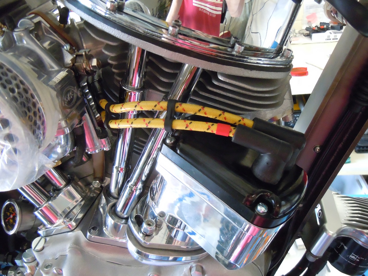

  1. It's starting to look like it's getting there now, just need to save some money & then get the exhaust system made now that the engine is in it's final resting position, i.e. aligned with the rear wheel, gearbox & primary drive.

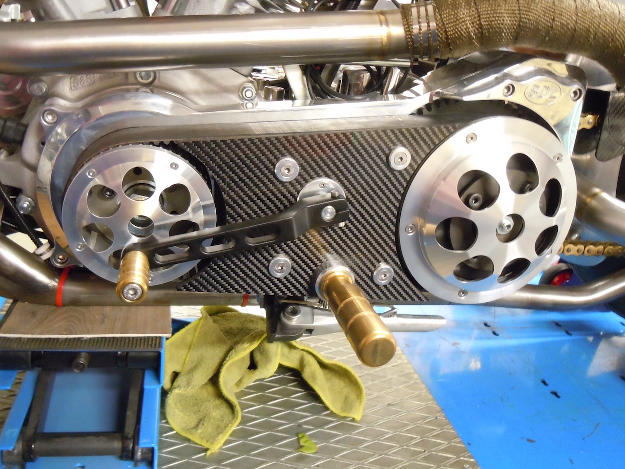

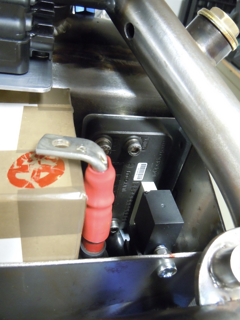

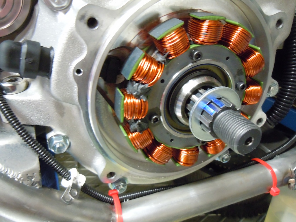

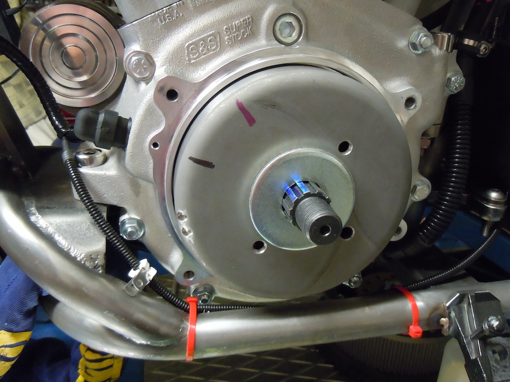

  2. The charging system arrived yesterday so I got that fitted today. The kit comes with the stator, the rotor, the regulator/rectifier & shim kit.

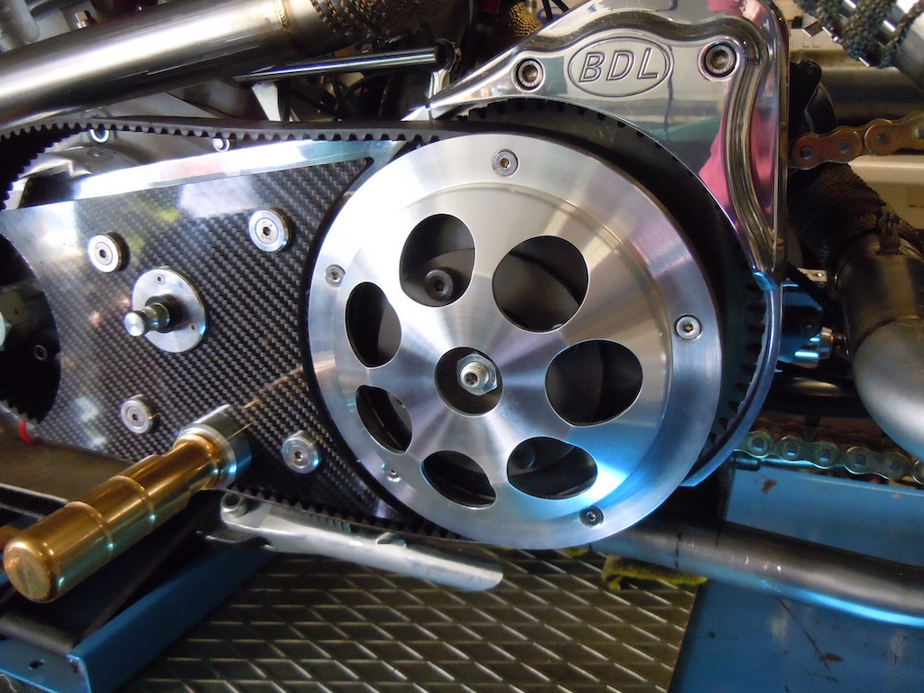

    The large diameter washer that fits between the rotor & engine drive pulley was too thick to give me the correct pulley/clutch drum alignment so I'll make a suitable sized washer from a piece of stainless steel. Hopefully that will give me perfect alignment for the primary bely drive.

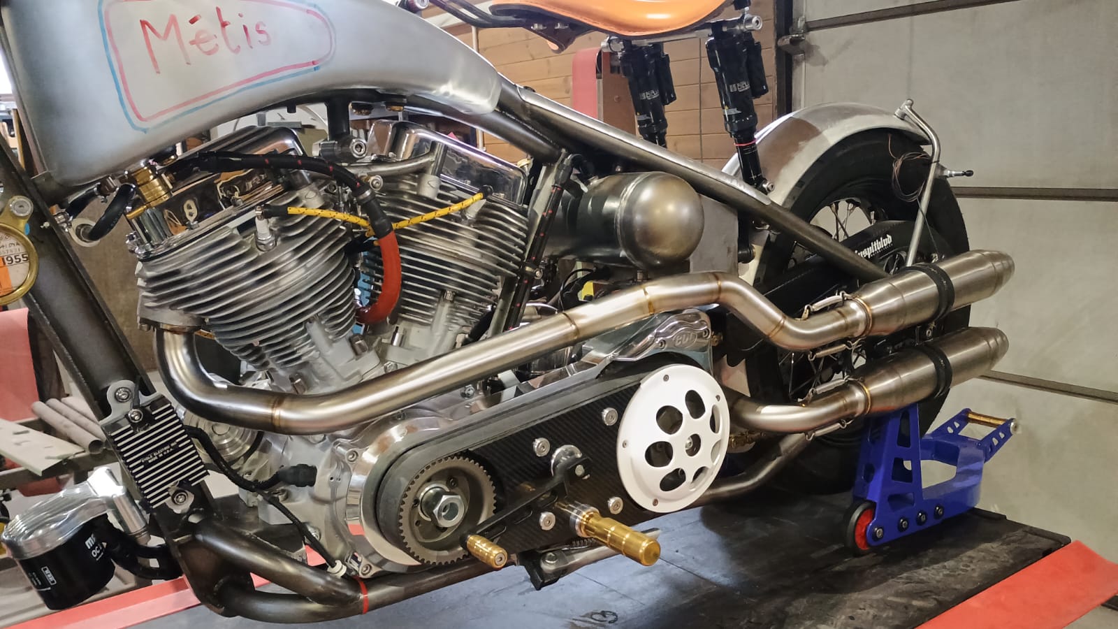

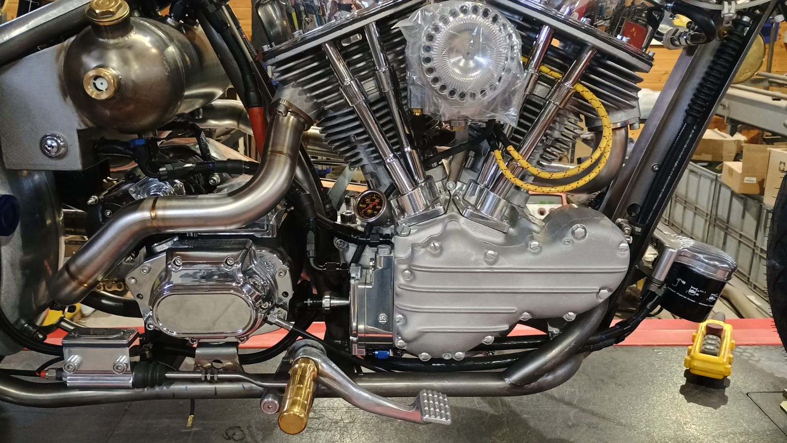

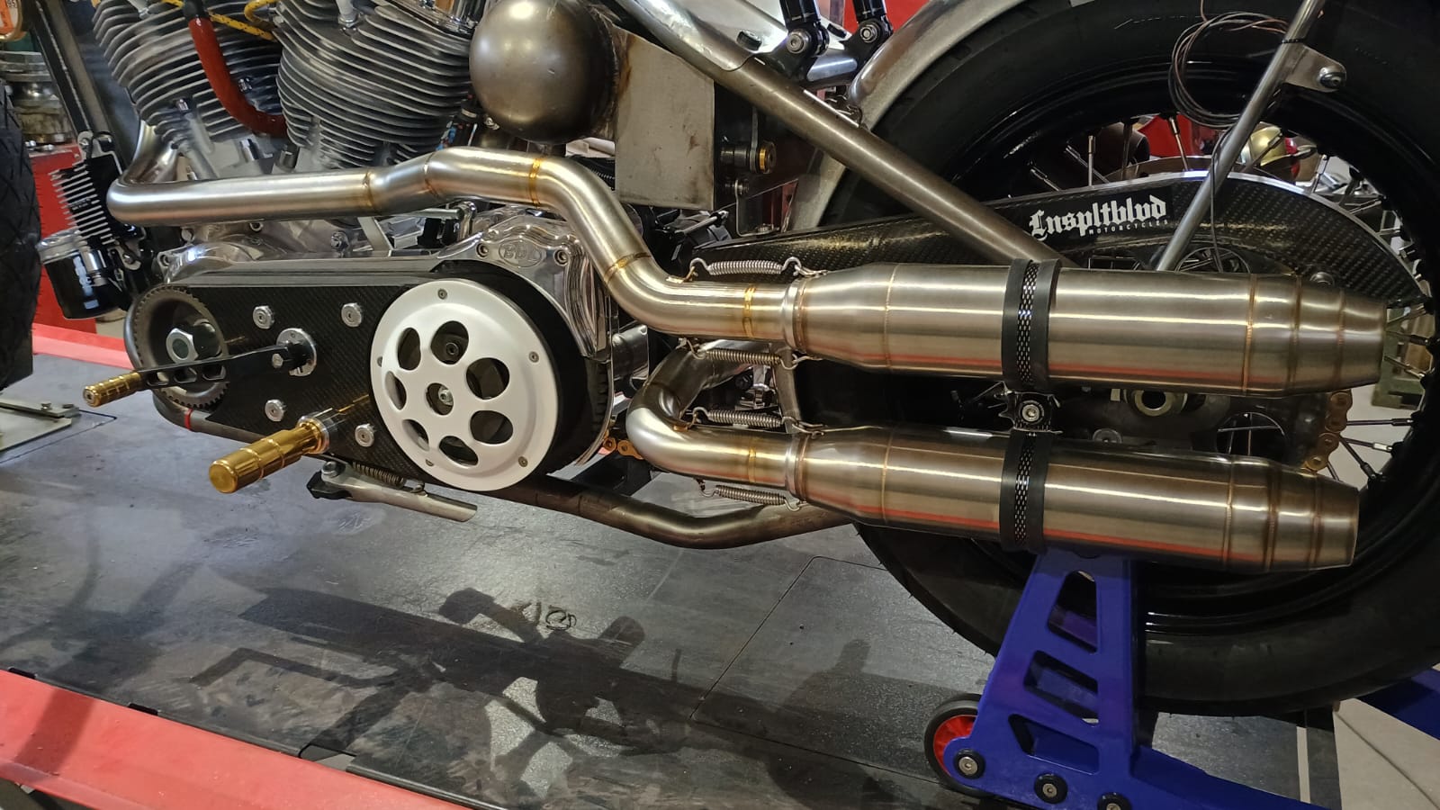

  3. Got a call to say the bike is ready for collection after having the exhaust made. Another job ticked off the list !!
    • Like Like x 8
  4. Sorry for the late reply, I've been a bit busy lately !
    The exhaust was made by OJZ Engineering. If you want to see him at work he has a YouTube channel, "Lancethegass".
    He, Lance, made the exhaust for the first bike I built & his work is excellent so I had no qualms about getting him to do the exhaust for this build too.
  5. :upyeah:No worries... I was in no need of an immediate answer. I'm presently refurbishing the V-Raptor and am keeping me eye open for exhaust fabricators for future reference.
    So Lance has been duly noted.
