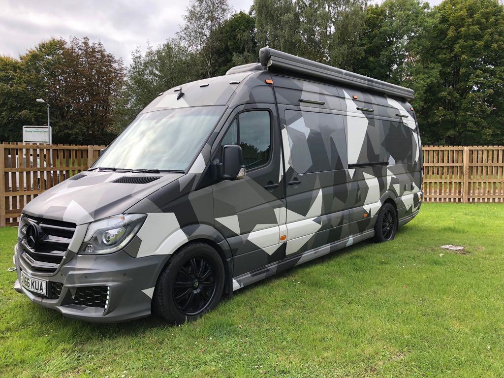

  10. I might just buy a new van anyway..... I like this...
  11. What would happen with that in a "sorry mate, didn't see you" scenario? :D:rolleyes:
  12. I have that now with a white van and driving lights on!
