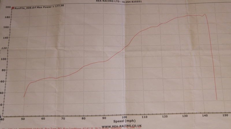

  10. 2012 1199s just about to nudge 10k miles.
    Full decatted 1299 system
    Sprint Filter
    Rapidbike Evo
    43t Rear
    Doesn't really produce any more power, dyno saw 178 RW BHP which should be there or there about 195 at the crank.
    But what it does do is smooth out the power delivery and it has lost the jerky horrible low down throttle.
    It picks up far better than standard, its low end grunt reminds me of my 999. It will if you want sit at 30 in 4th and still go without bogging down.
    On track it shoots out of corners much better and feels more predictable as the 7k jump in is smoothed out. I saw 164 down the main straight at Brno and it still had more to give.
