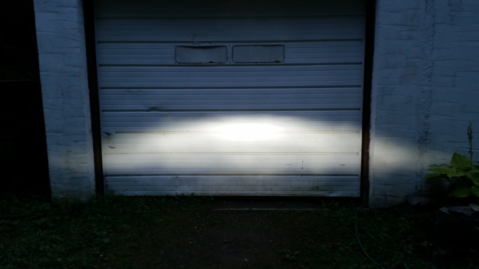

  3. Here are photos taken at 20 ft from the surface. Low is bright, wide, throws light nicely into the corners (not talking about the useless cornering lights here).
    The high beam is, well I don't know what the high beam is. It's certainly useless to me.
  4. Yes - I would say your low beam is where your high beam should be.
  5. The bike is on a hill, they are not actually aimed that high. The photos are just for beam pattern
