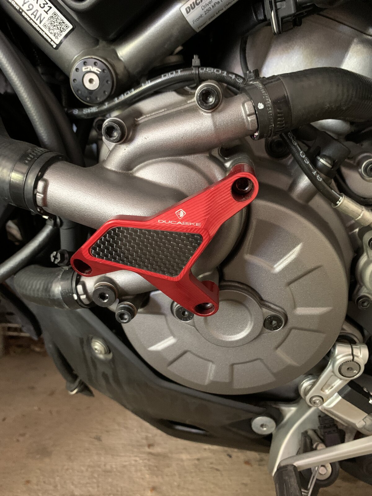

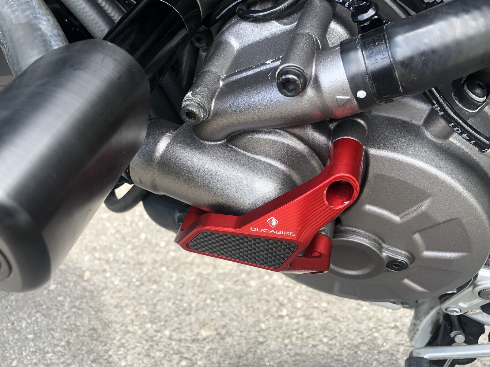

  6. Going to ditch the plastic cover, any recommendations do an alternative which also looks better?

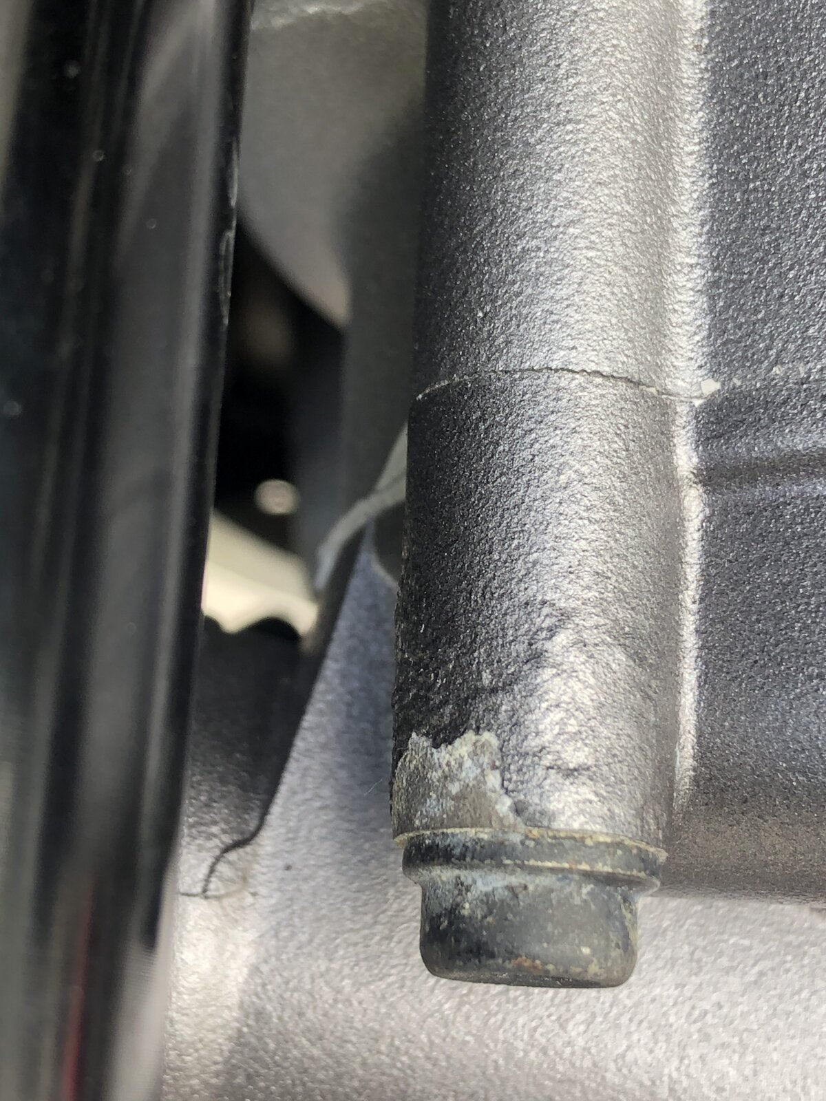

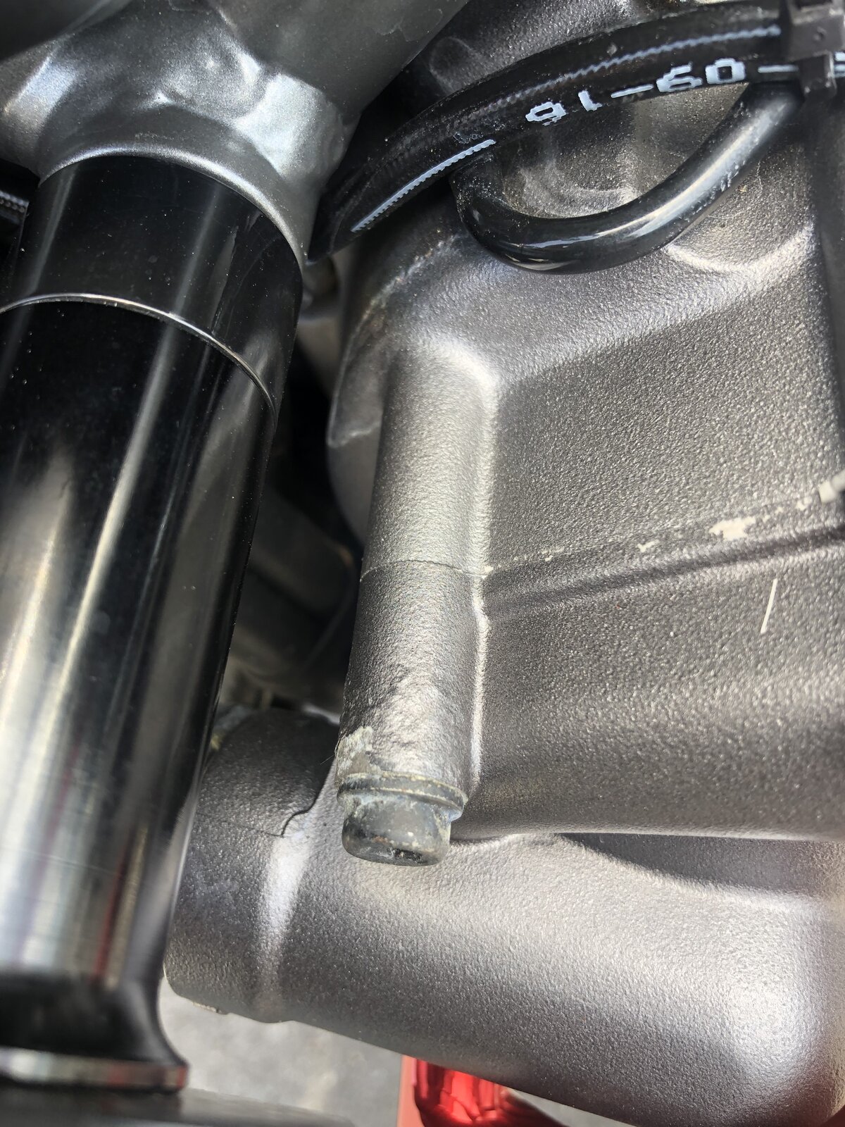

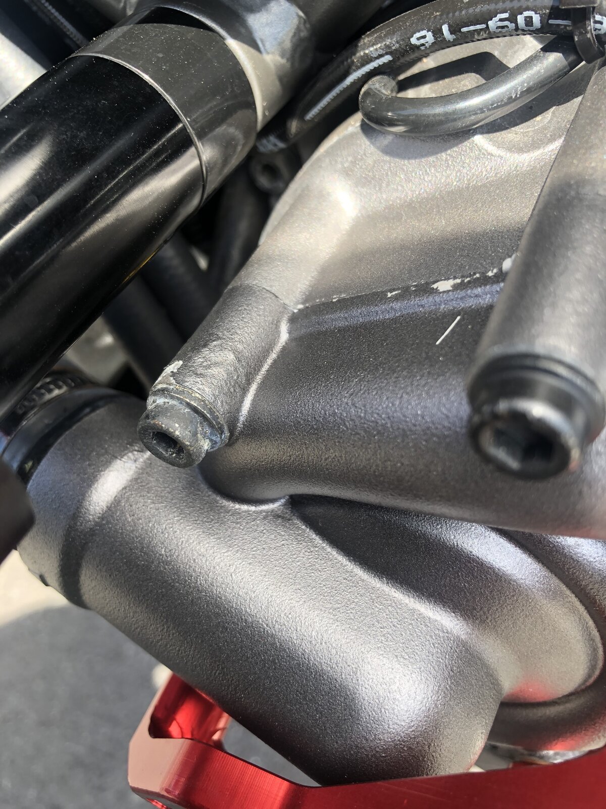

  8. Bought my 2018 1260 5700 miles looked in good condition Took my cover off after reading this forum posts lo behold corrosion paint peeling ducati aylesbury replacingunder warranty thank you 4 he job !! What how did you guys protect this from happening again - its not just the foam is it but poor paint quality ?
  9. Photo now in sorry removed extraneous photos BD268C37-637B-4F02-B697-466443BE80D0.jpeg
  10. Holy fuck, that's a mess! Get it replaced.

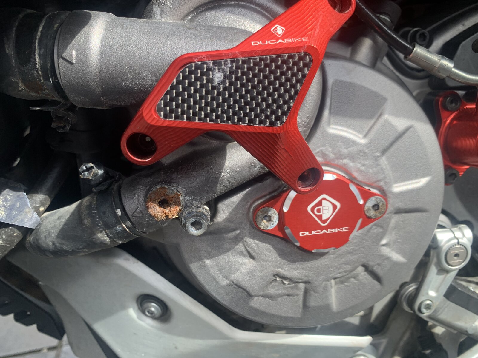

  15. Unbloody believeable, I picked up my bike from the dealers this week, took off the plastic cover to fit a Ducabike water pump protector only to find that the new replacement case was already corroded!!!!, Cant believe that they would fit a corroded one as a replacement, to say Im pissed is an understatement IMG_6248.JPG IMG_6250.JPG IMG_6251.JPG IMG_6252.JPG
  16. Absolutely incredible. Get back onto them, demand rectification as well as full reimbursement of all of your costs for travelling and the time spent. Disgraceful approach....
  17. Already been onto Ducati Italy, Ducati UK warranty dept and the dealers, Dealers say they repalced what was authorised (*come to that in a bit) and Ducati say it was an oversight by the dealers and have given them the go ahead to replace it
