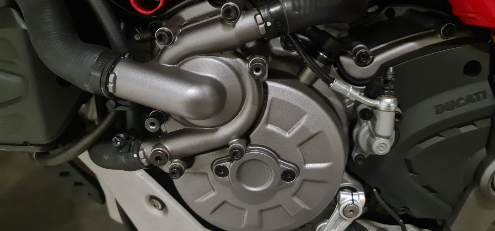

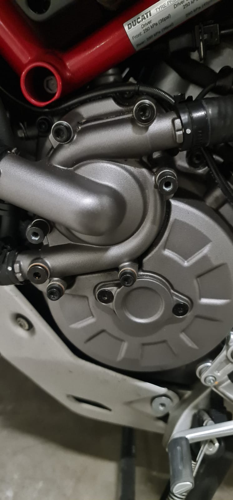

  3. Welp, I must have not noticed it, but yea, sponge has been removed. Anyway, I put ACF 50 on the bike (removed covers) on day one last year. Have ridden through some horrible rain storms and salty roads. This is what mine looks like. Always rust prevent your bikes!!! It takes 30 minutes once a year and saves so many headaches.

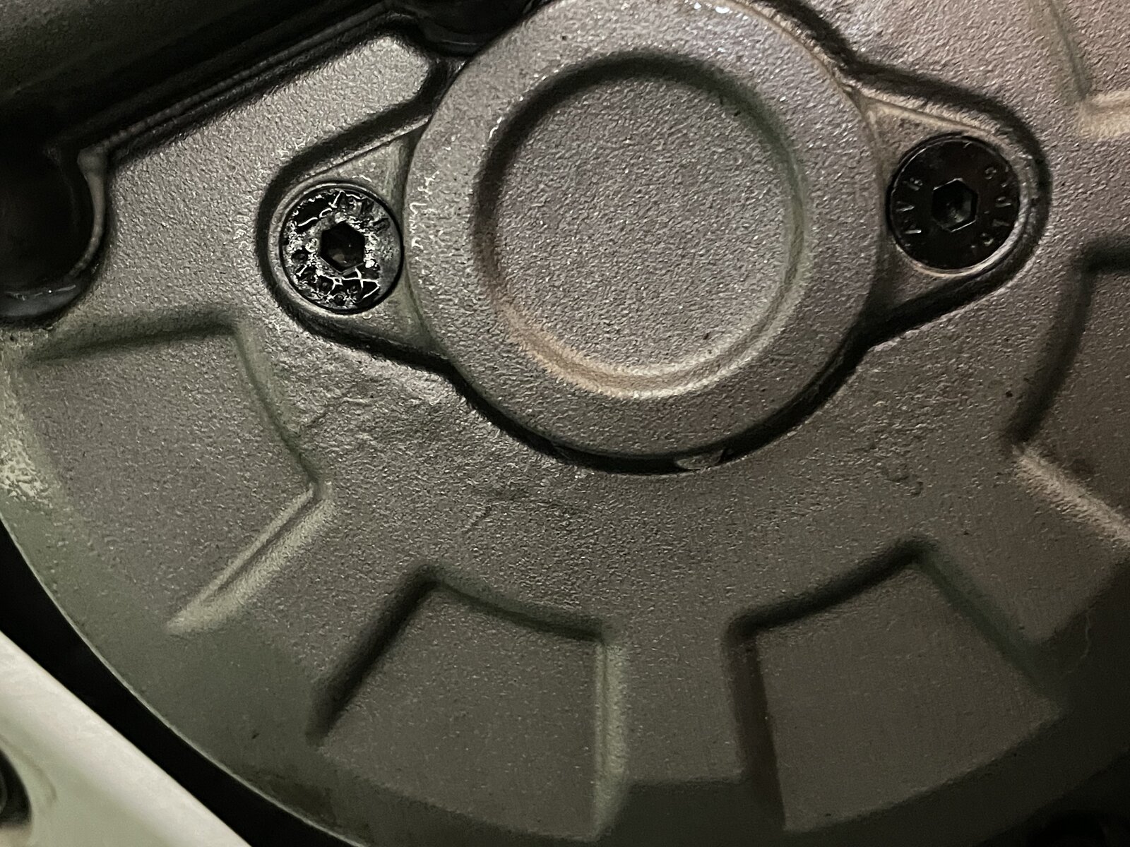

    photo here - bad enough to try to get a warranty replacement?
  5. Several questions. How old is the bike ? If it is within warranty, did you buy the bike from your local dealer ? How good a relationship do you have with your local dealer ? If the bike is out of warranty and you have a strong relationship with your dealer, they may be prepared to argue your case. Andy
  6. Thanks - it’s 2019 and I’ve had it since Nov. It’s still under 4ever warranty.
    Only relationship at the moment is to buy the bike.
  7. If it’s still under warranty then you should be ok for a claim
  8. Thanks - it’s in on Fri for the check engine light, so have asked them to look at this too. Fingers crossed.

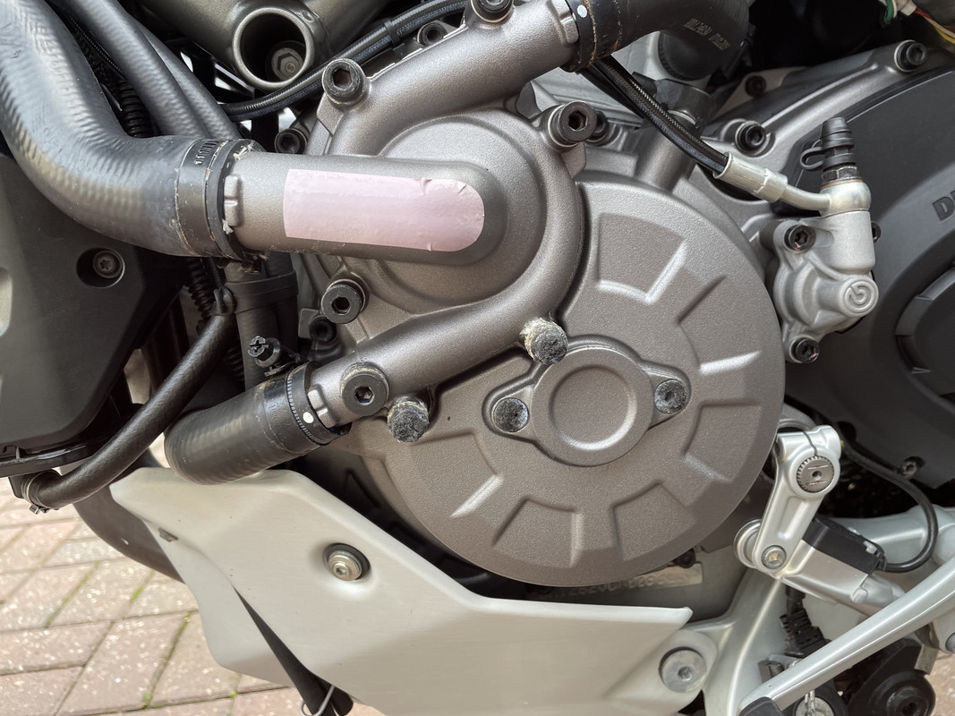

  12. Happy to report I whipped the cover off and found this...
  13. Hmmm, what's the happy part?
  14. Jealous!
  15. Not sure why. This one should be getting a new water pump cover and new bolts at a minimum
  16. “Sad face” I thought it looked in so much better condition than mine.
  17. Looks OK, take off the sticker, clean the bolts up, spay with Anti-corrosion (I use Wurth 20/40) and fit a metal pump protector such as a Rizoma (others make available).
  18. Yes, that's the plan. Won't be using it much for the next month anyway.
  19. I’d be seriously pissed if I saw that.
  20. I didn't think it looked bad compared to others. Need to clean it up a bit and see what the bolts look like as the foam was stuck to them all.
