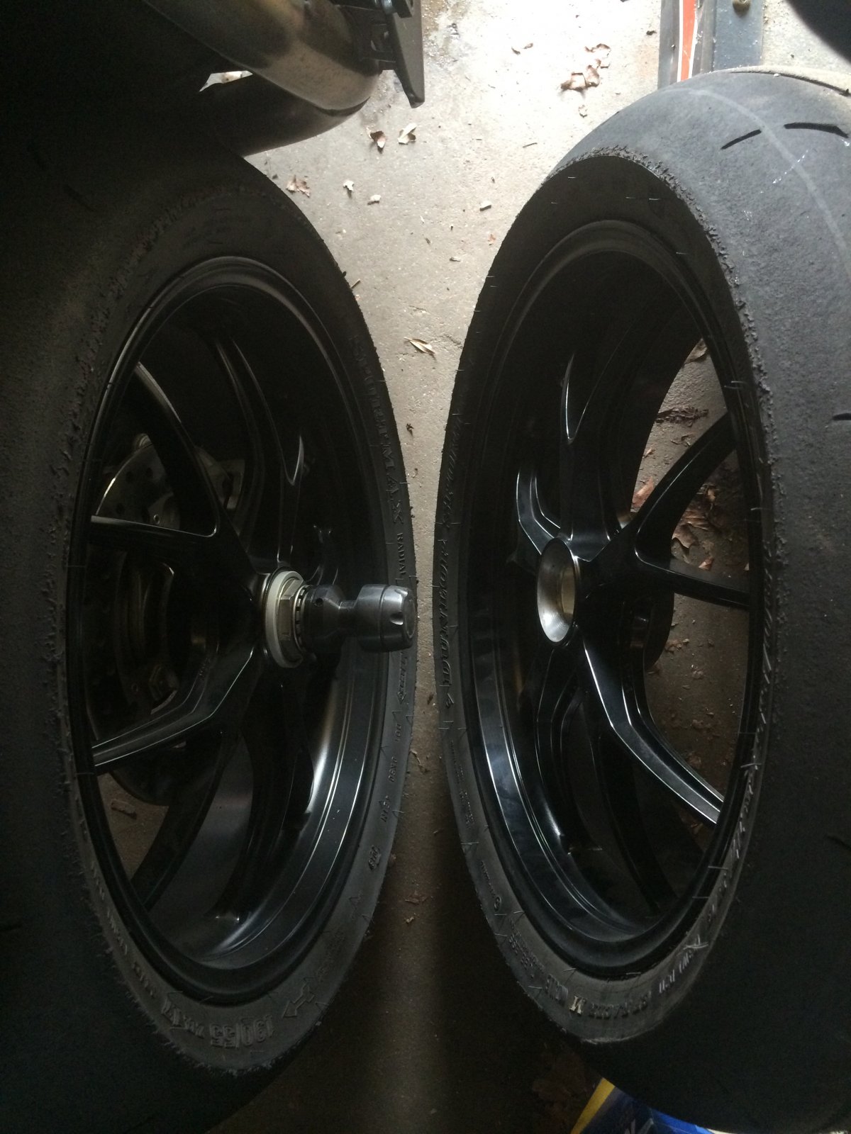

  12. 190 on the bike, 180 on the loose rim. There's not much in it as far as ballooning goes. image.jpg
