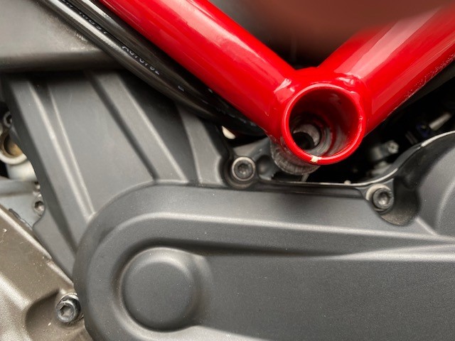

  1. Update for you, Ducati inspected it and apparently the previous owner had removed crash bungs from that bit and not replaced a bar of some sort (between both sides I think, dunno 'cos that's where the subframe bolts on on my Enduro).
  2. I realise you are getting second hand info but I cannot reconcile that assessment with the photos provided. Crash bungs do not fit where the frame is circled in the third photo. Andy
  3. I can believe that removing the tie bar from the lower frame attachment point and not replacing it with the purpose made crash bung rod would put a great deal of strain on the lattice weld as shown.
  4. Ah, that makes more sense. The R&G aero crash bungs just replace the OE engine bolt. Doesn’t add up. Andy
  5. That is an expensive mistake to make hope it wasn't sold to the current owner like that with the bolt missing!!
  6. Sounds like the OE engine bolt wasn't put back in when the crash bungs were removed. He did say something about the engine having dropped a bit.

  7. Yes sounds like it was.
  8. So who has to pay for this all putting right ?
  10. Replace the bolt, MIG the frame, respray, jobs a good'n!
