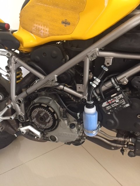

  2. I had the same, thought was the clutch seals leaking but no its the standard catch can that cant keep up with it, you can try and clean it and so on but as soon it has a bit of oil it tends to leak a bit and due to the clutch is just behind it leaks onto it..
    Mine doesn't use any oil at all and only does TD. I made my own catch can as I believe the original design doesn't help as the reed valve doesn't allow the oil in the pipe to return and the little hole in it is just not enough, I removed the valve at the crank, a different hose that goes up instead of horizontal then closer to the return to the airbox I put a one way valve.
    I also read somewhere that this is a common thing for xx9s that are only riden properly ;), on track.
    Hope it makes sense.
    Ric

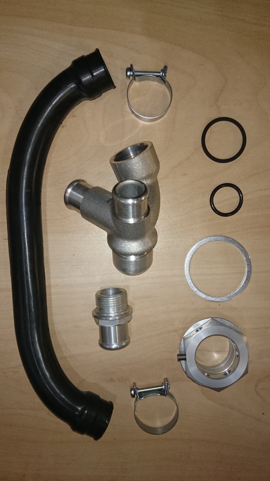

  5. kit came Friday and was on yesterday. A very simple job apart from one fiddly seal in the breather. Hopefully get it tested next week ( probably on the dyno as it needs to be done under power ). Only slight criticism is the kit only comes with one securing grub screw. I think I'd prefer two more - they are only 99p on eBay for 5!

  6. Please show some photos when it is fitted, very keen on how that contraption loks like and also interesting to see how it works.
    Did you order it from Moto Rapido, i couldnt find anything when i looked and that why i did the tank.
    Cheers
    Ric
  7. Will do. Yes, got it from Moto Rapidio. If you're a Ducati Sporting Club member you get 10 % off too!

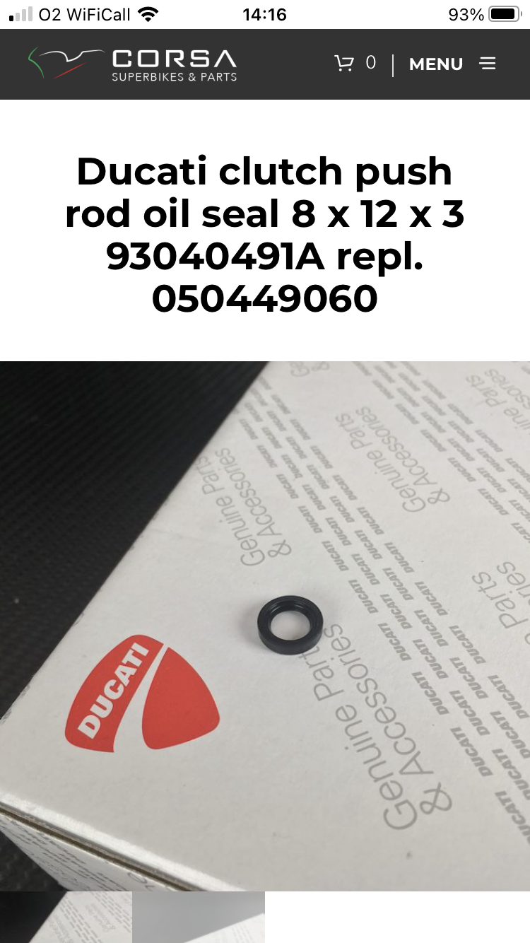

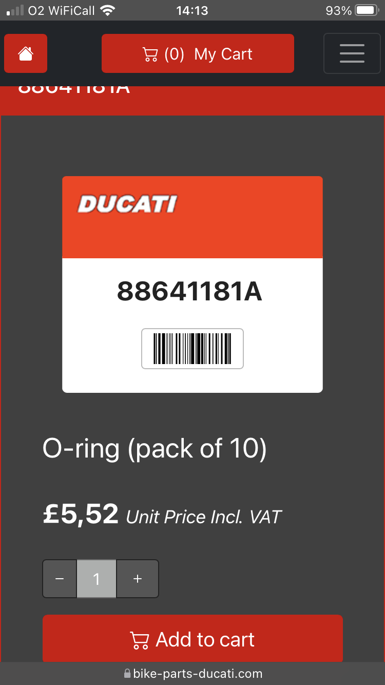

  15. The “excessive” crank pressure is still giving me grief under high revs. It blows oil through the clutch push rod seal / o ring. Changed ALL clutch side seals including the large one on the clutch housing. I’m going to check the little oil seal on the push rod should be a spring seal (8/12/3) not an o ring and modify the crank breather. I’ll keep you posted as I don’t want to waste another track / race day.
