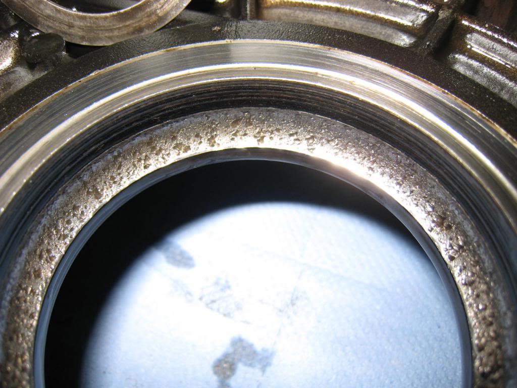

  13. There's a general belief that a lot of these motors are over preloaded at the factory. My 851 LHS main is fuc3ed as you can see.
    the bearings are not just ball races but angular contact bearings. The preload is a cold figure. The cases are alloy and the crank steel. alloy expands more than steel, so if you set them with 0 preload cold they will run too loose when hot. As someone mentioned you can measure the run out on the crank as you bolt up the cases, if it starts to run out you have too much preload and the crank is actually starting to bend. So preloaded correctly and when warm the preload should just be very slightly
