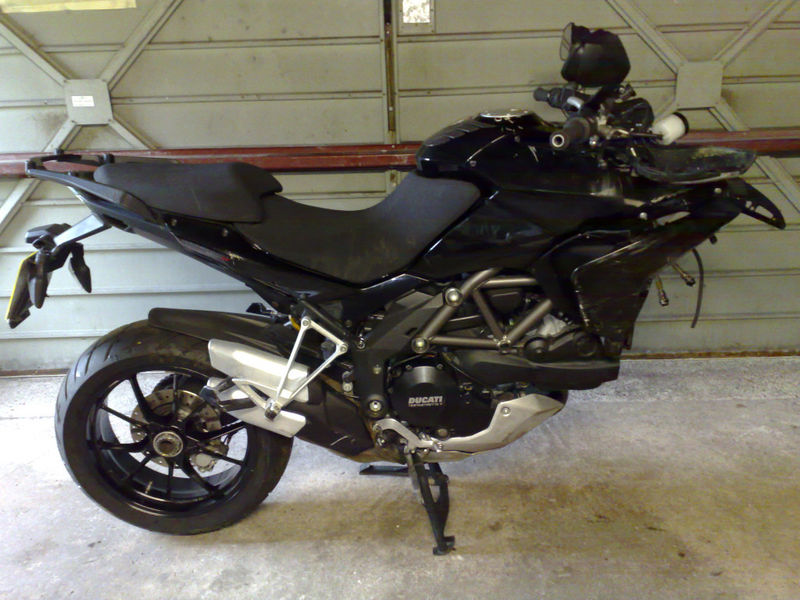

  3. I appreciate the positive comments chaps. I'm not going to let the naysayers get me down!
    Just need the rear tool tray/pillion grip thing, the left side subframe cover, and some standard mirrors!
    Won't be long now!
    Next set of pics will be the disassembly of the front end :)

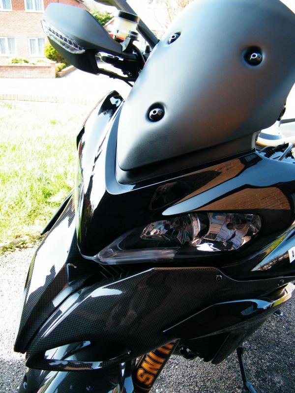

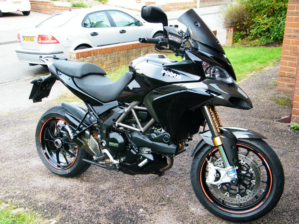

    Hi Stretta. Been away for a fair old time as I am now finishing off a smashed 2013 Gen2 ZZR1400. Just looked in and see you have taken on a Multi project. I too took one on a couple of years ago. You can see it was a fair bit more damaged than yours.
    Total front end gone. All the electronics ripped out including the tops of the Ohlins. But hey, I had such a great time rebuilding it and learned so much. It ended up a magnificent beast, dripping with carbon fibre and powder coating. The colour I had sprayed a Kawasaki blue that looked black but sparked blue in the sun. Ended up touring round the Italian Lakes and all sorts! The only bike that caused a tear in my eye when I sold it.
    One thing I would say, even though the front end had a massive bash, the frame was tested dead straight. As you can see all the stress was taken in the triple trees that were totalled (but an easy replacement). After selling her I bought a Cat C Triumph Explorer with no where near the same sort of front end damage. The worst thing I ever did. Found the frame had totally bent, and the yoke housing the bearings had concaved. But the forks and trees were ok!!! Think the Multi trees are designed to be sacrificial.
    Anyway, all the very best of luck with the build. Any questions just ask.

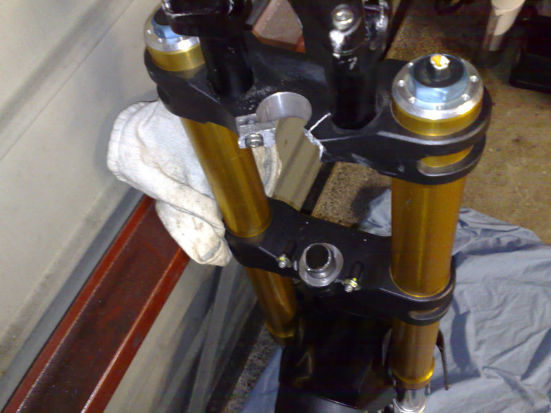

  18. I haven't had lots of free time to work on the bike, but made a little progress nevertheless:
    Front end disassembled now. As I expected (and thankfully!), everything is straight and/or within tolerances.
    Next step is to put it back together again, and finally get round to sorting the rear wheel out!
  19. I would be tempted to put a set of tapered bearings in while it's apart.
    I did mine on the Hypermotard as they were less than £30 delivered from M&P.
