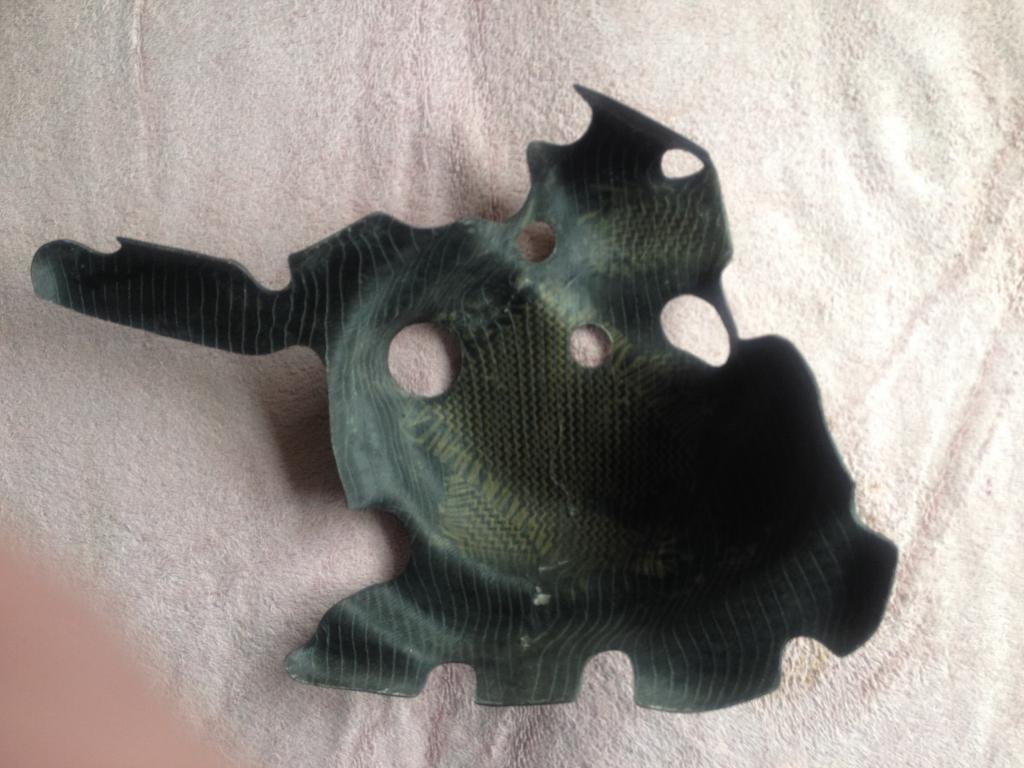

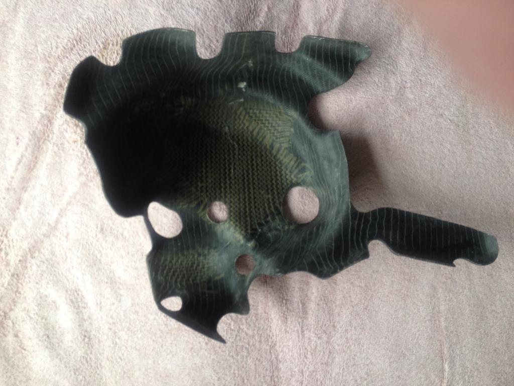

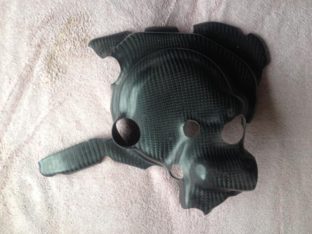

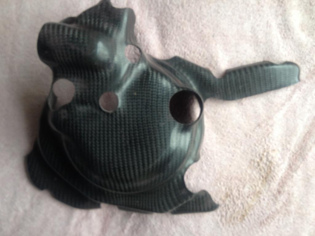

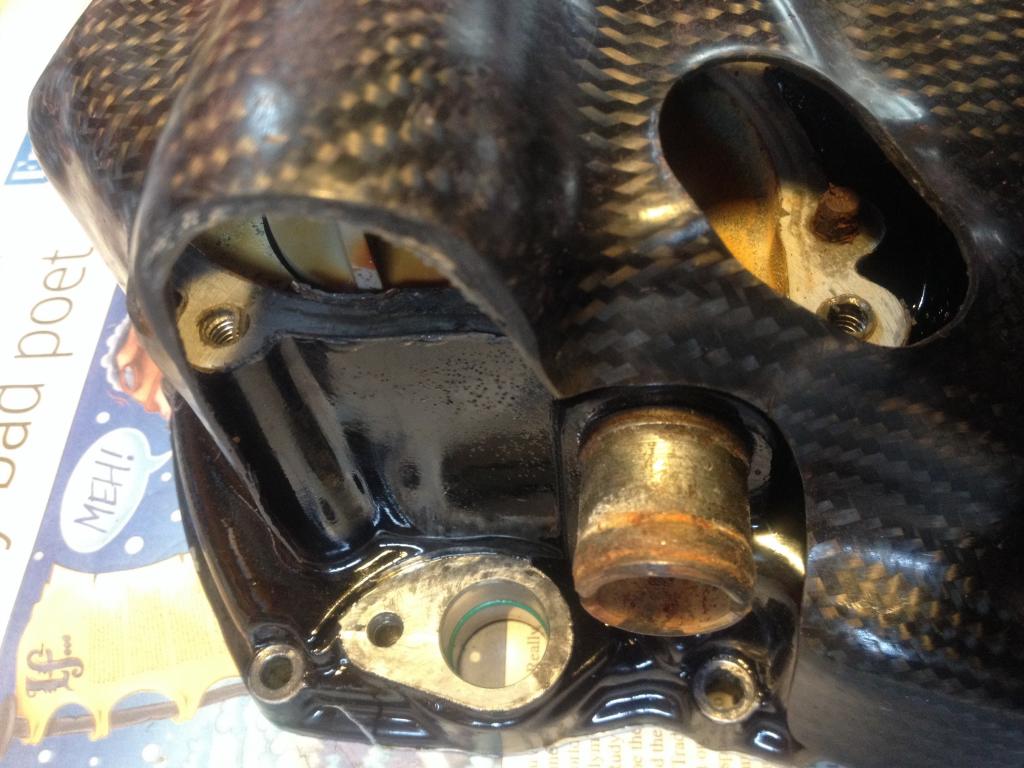

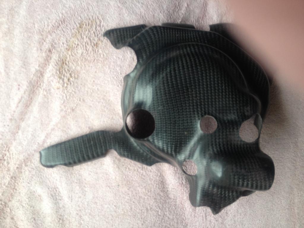

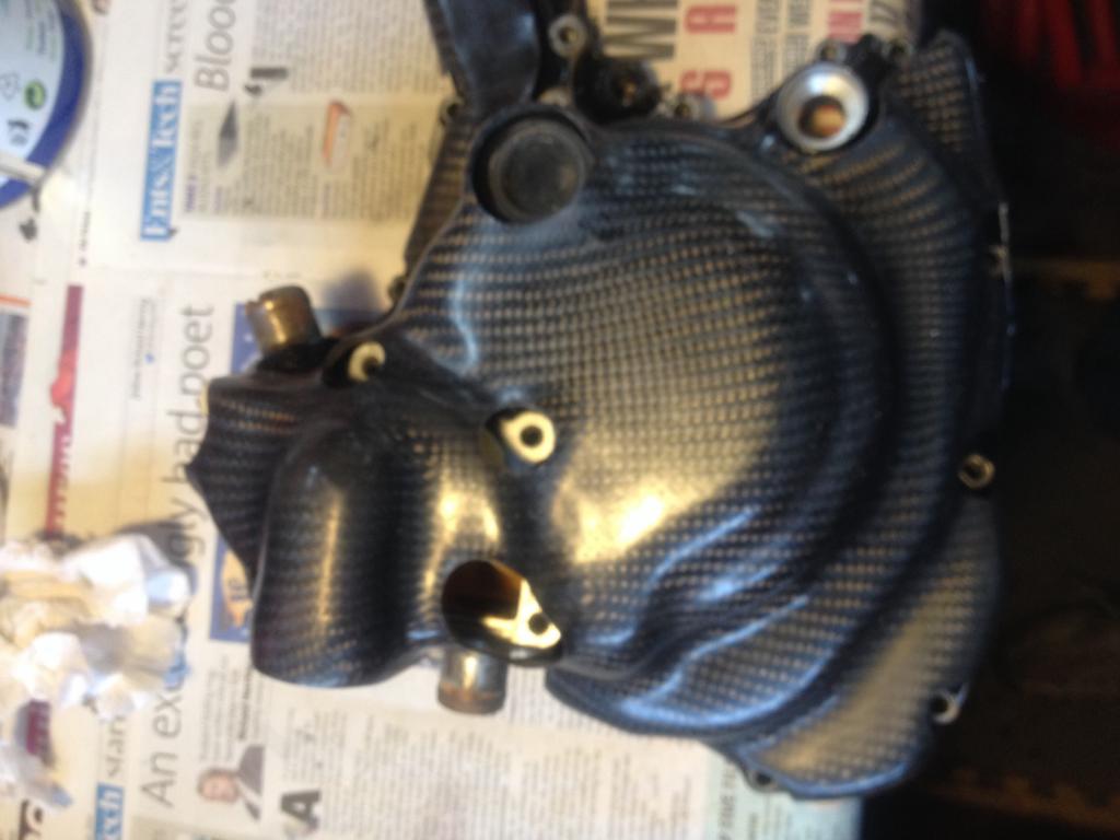

  4. This is a nice case saver that is very rare, it is an original Ducati Produced item that was given to those competing in the Ducati Monster challenge quite a while back. It will fit 748-9*6 cases, I know as I have tried it on to check the fit, it's held by silicone normally. I reckon it might fit 998\999 etc but I would need to check that.
    It's Carbonfibre with a Kevlar centre backing. Looks good in that it will save the case bottom and the water pump up to a point. If this could be reproduced what would be the interest? as I might look into it if there were enough takers.
    It fits pretty nicely under a fairing although it was not originally designed for that as the bikes were naked. I reckon it would add that bit of extra protection.

  5. ^ I like that. Maybe CC could run something like this...

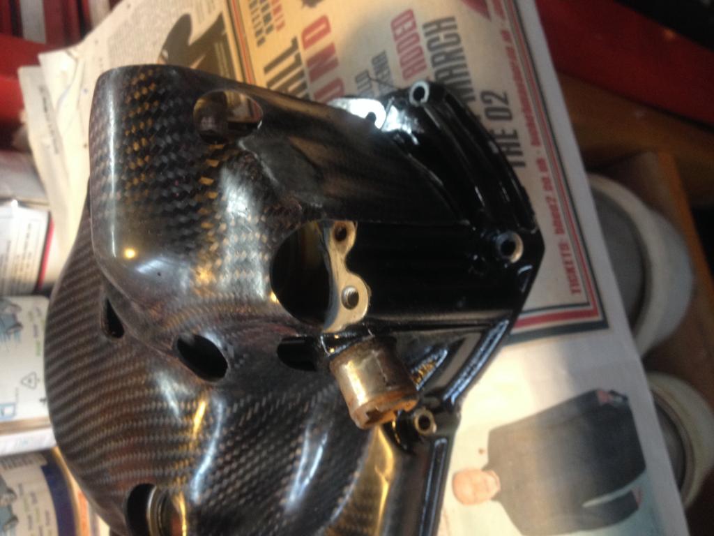

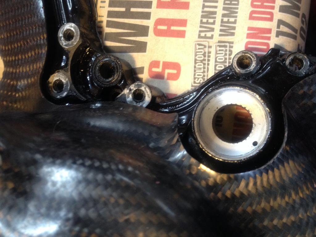

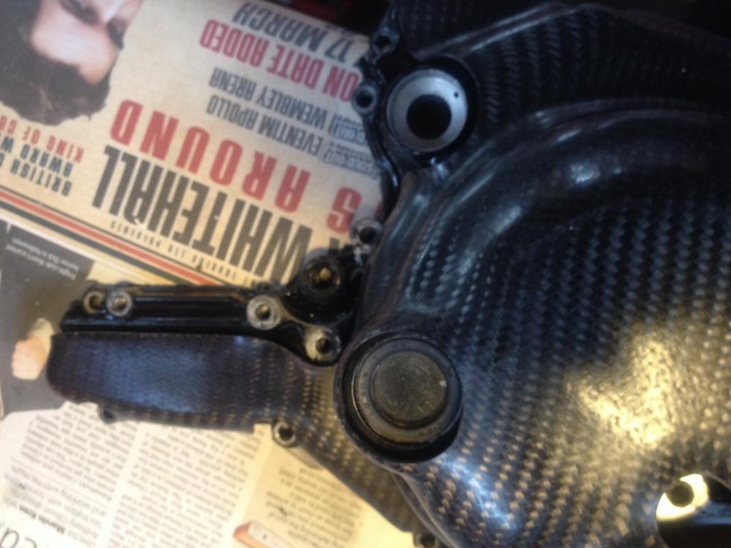

  9. Here's a few photo's of it sitting on a spare 748R case.

  10. I would be interested in 1 possibly 2 :upyeah: keep me posted if things progress
