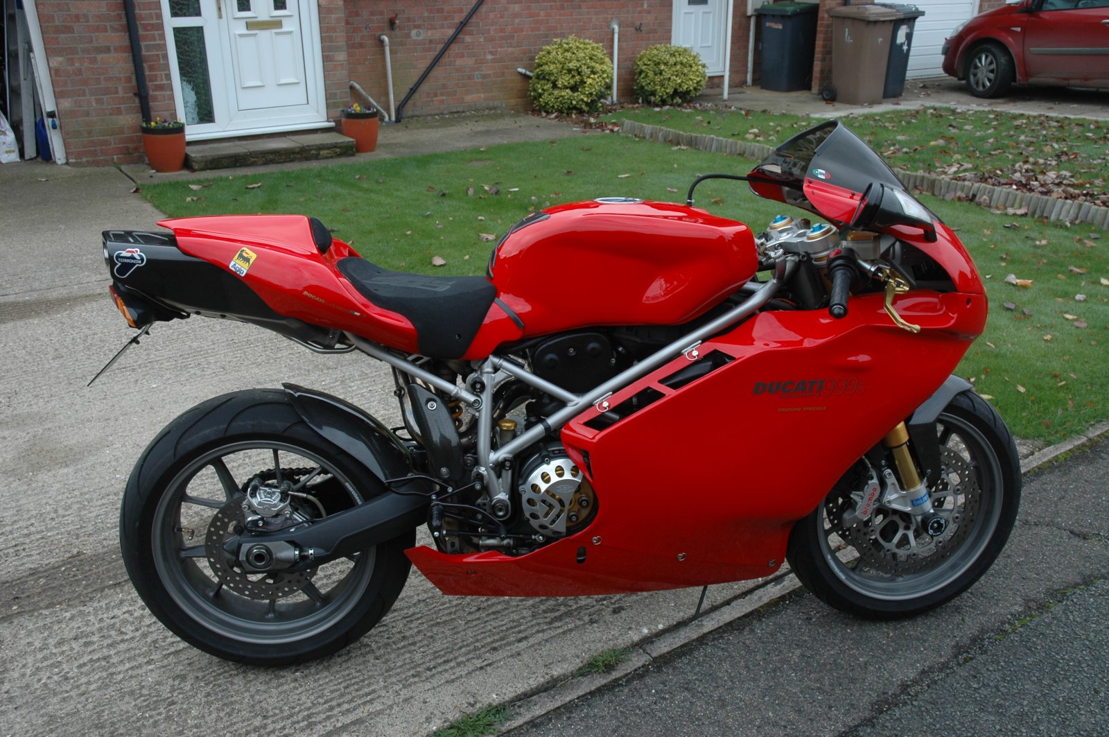

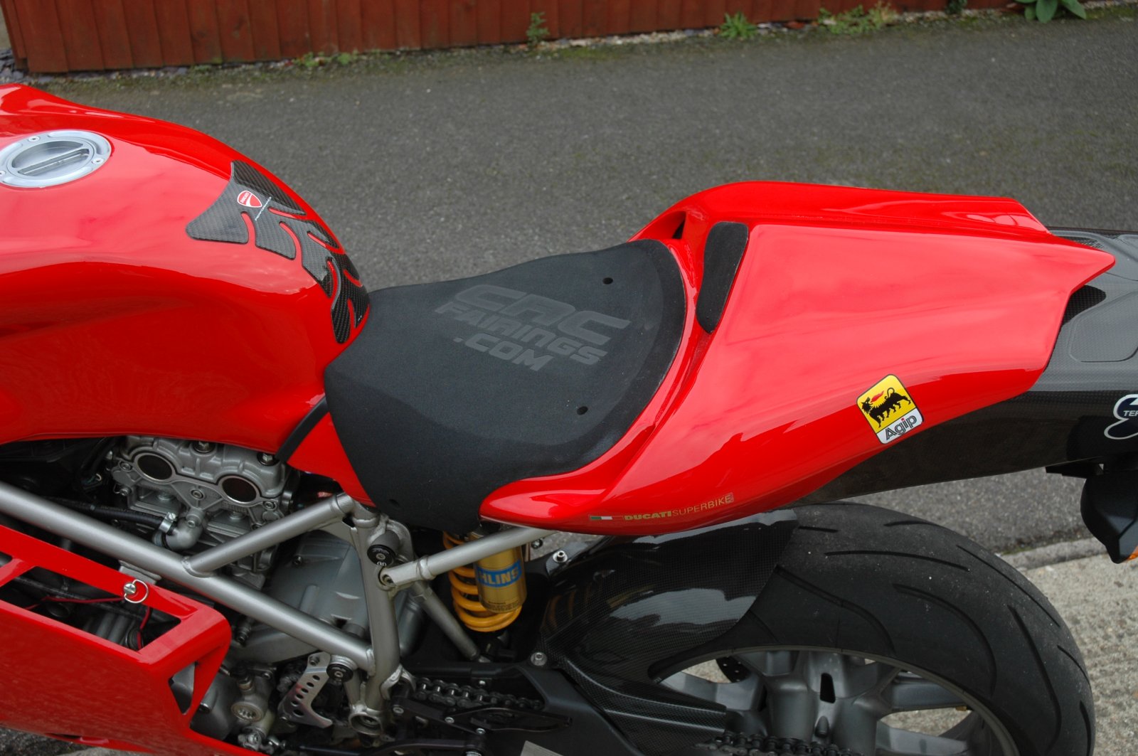

  6. Almost finished ,just got to shape the foam to go underneath it for a bit more support, went out for a quick ride this morning and the seat height is slightly higher than the OE, meaning a bit more pressure on my wrists and neck...I think its worth it ,its not everyones cup of tea but I like how it looks :D DSC_0674.JPG DSC_0673.JPG
  7. Looking good. Nice paint job. Worth it in the end. Although the tail unit is slightly different it still retains the same shape as the OEM rewards of the rider seat.
