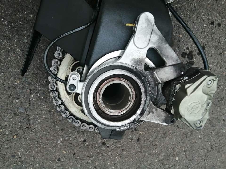

  2. Frightening isn’t it. Hopefully Ducati and some engineer boffins carry out a thorough post mortem on the bike and get to the bottom of it ASAP

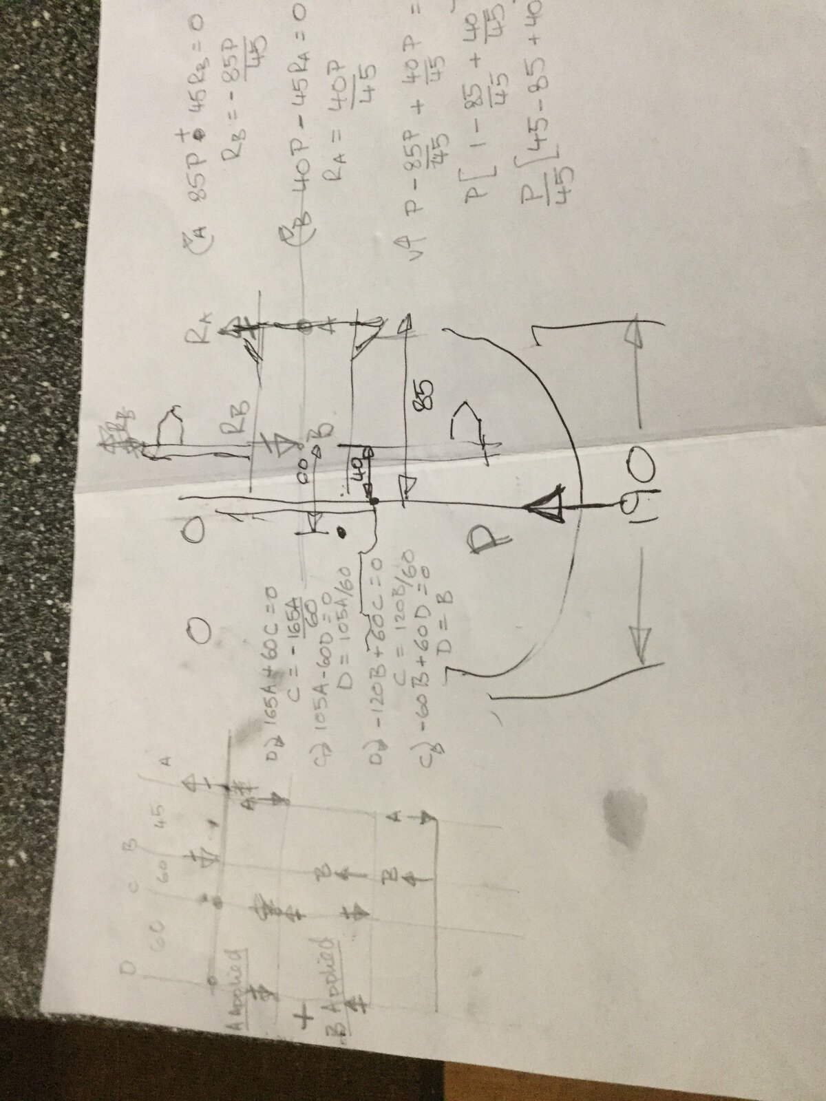

  3. This one? Didn’t op say no one was badly hurt?
  4. All evidence etc, if serious injury or worse happens to someone else due to a similar failure.
  5. Started some fag packet sums based on approx geometry of my 1098.
    Gotta cook family dinner now so will finish tomorrow hopefully.

    ps Extensive back of fag packet calculations:upyeah:

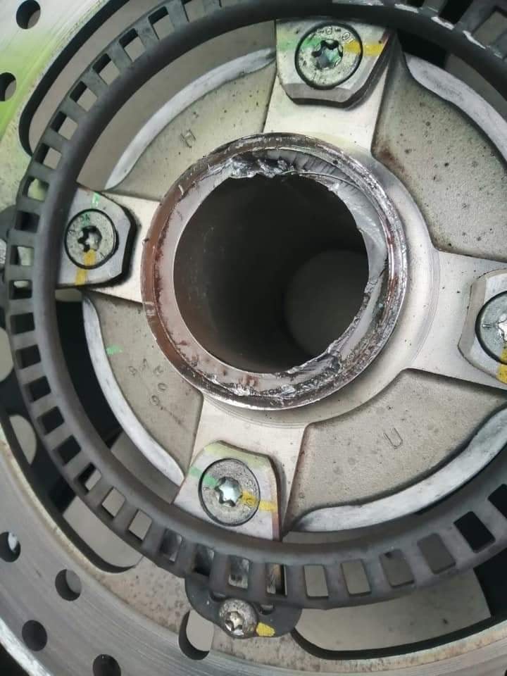

  7. Here’s my fag packet calculations: it broke. hth
    • Funny Funny x 6

    • Thanks Thanks x 2
  9. You must smoke superkings then judging by the size of that packet lol

  11. And more luckily no sign of blood either :upyeah:
  12. You can see (iirc) the beach marks showing progressive fatigue failure running CW from 12 o'clock to around 3 0'clock when she let go. It would take close metallurgical examination to show what started this sequence off !
