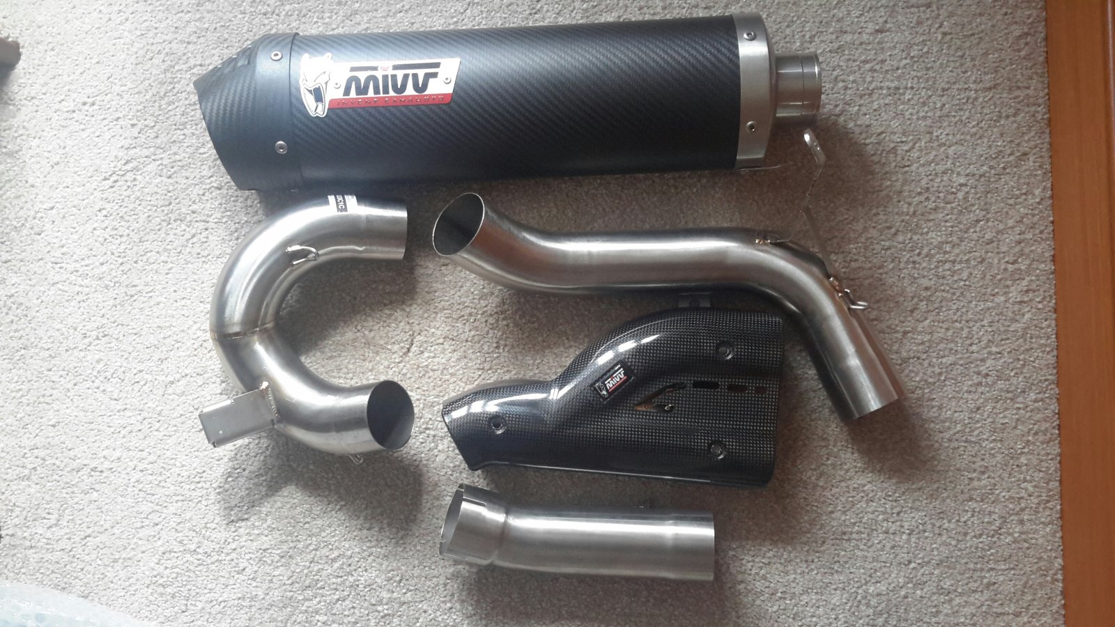

  6. Just about to pack my MIVV system to take to Thailand....
    Not sure whether the can will go on or just the Decat and leave the Termignoni can..
