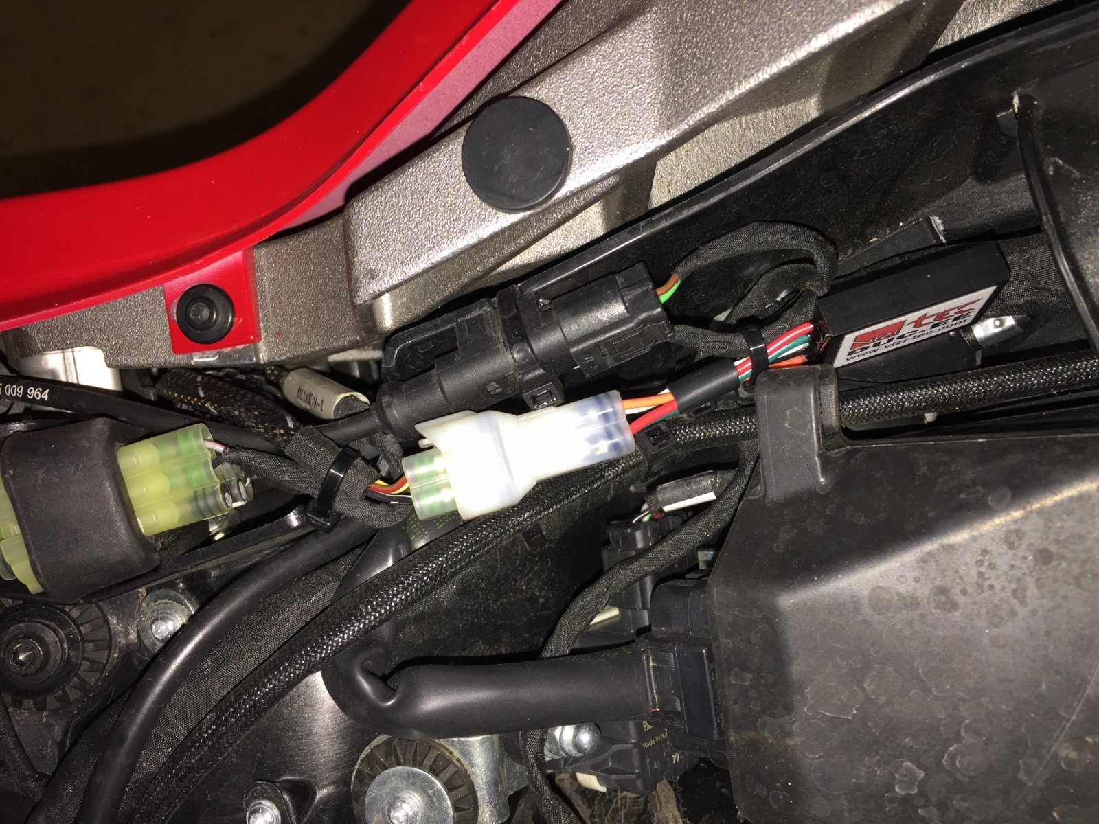

  7. Well, plugged in the little gizmo this morning & the bloody light is still on
    Can someone confirm I've unplugged the correct plug & fitted it into the gizmo plug correctly
    It's really pi££ing me off now, I've got a feeling I'm going to have to refit the standard exhaust & pleed ignorance as to why the management light has come on
  9. Mine looks to be connected up exactly the same as yours !?

  17. Steve m, I just used the same connector as in your picture and it works fine no lights.
