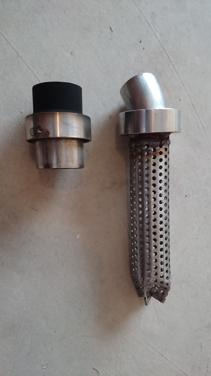

  5. I recently moved to a townhouse and was looking for a way to quiet down my Mivv Suono decat, without going back to stock. The dinky exhaust baffle didn't do much, and it was still WAY too loud on cold start at 6am.
    I noticed Mivv only has a couple different muffler part numbers, so I started looking at the schematics for other bikes. I found a baffle for the R1200GS and ordered it up. GS people don't typically like hella loud, so I figured it would be a good starting point, rather than fab up something custom. I installed it yesterday and I love it! The roar is still there, as are the pops and burbles, but it took the edge off enough that I don't think my neighbors will be out with pitchforks on Monday morning. I can't comment on power, as I didn't get a chance to open her up, but I'm sure I lost a few hp. Oh well, I'll trade a couple hp for a great exhaust note. It used to be loud with ear plugs in and I did a quick drive around town without ear plugs and it's a pleasurable volume level.
    The R1200GS part is: 50.DK.042.0

  12. They both mount the same. The muffler is the same part number for multiple bikes. They just have different baffles. There is nut spot welded to the baffle and then you thread a bolt into it from the underside of the muffler. You can see the threads on the stock baffle (on the left). The the threads on the GS baffle are out of view in that photo.
