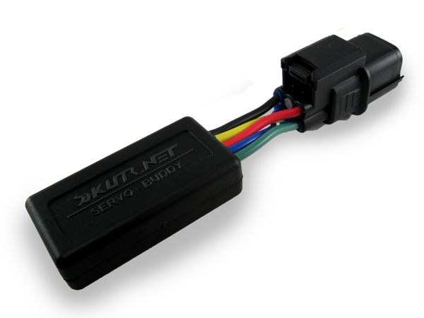

  1. Junking the exhaust valve is just one benefit of any decat kit.....but you will need to have the bike's ECU updated by someone like Chris at CJS Racing to get rid of the EXVL errors on the Dash or buy a device such as the Servo Buddy (Speedycom Performance Ltd that fools the ECU into seeing the valve as present and operational.

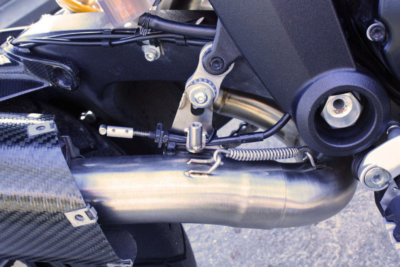

  7. Sound/performance = decat :D ........both dependent on what silencer/end can you go with. Both the OE and Termi Carbon stubby make for LOUD although there's various optional baffle choices with different decat kits.
    As soon as the exhaust valve is removed (e.g. cat box removed) you'll get EXVL errors on the Dash....

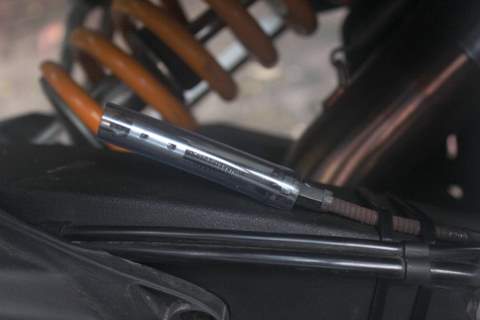

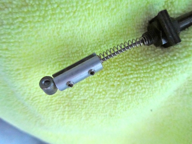

    Quick and free/cheap fix.......DIY fix with a spring and cable clamp to fool the servo motor sensor that the valve is still in place and connected to the cable:

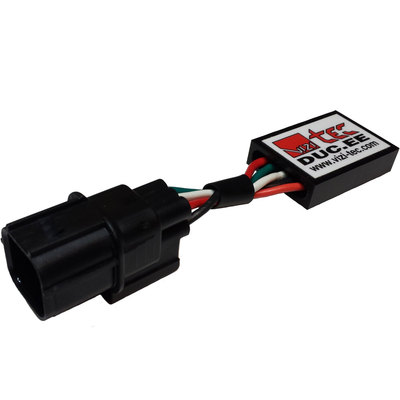

    ....or disconnect the connector from the bike's wiring loom to the exhaust valve servo motor and connect a DUC-EE (no UK reseller, so buy from the USA) or Servo Buddy - cost around £50. Speedycom sells the Servo Buddy but although I know there is a variant for the MTS1200, it's not listed on their site (contact them....scroll down the pagefor product enquiries;-))

  9. Bit of trial and error to get the clamp position right for the correct spring tension and you'll be sorted.

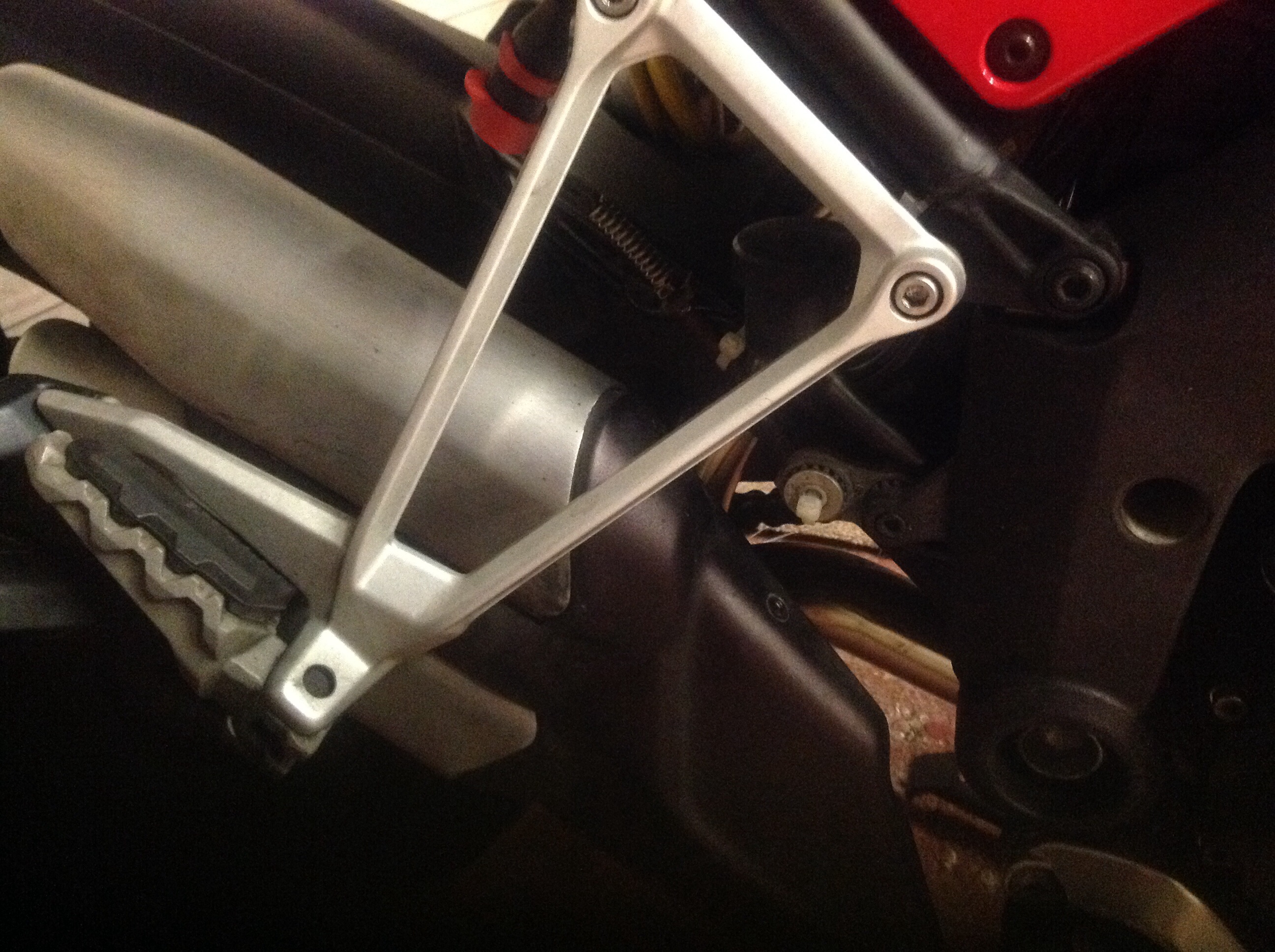

  12. Great, used just a heavy spring from a ram mount, plus cable ties and we're in ;)
    Alas I dont think it will make your website pmsl
  13. Too embarrassed to post a photo?! lol
  14. Copyright bodger bradbury 2014
  15. You don't know how lucky you are with your obvious laid back approach to these things...........that'd irritate the hell outta me! lol
    ......and you've a screw missing from the exhaust cover ;-)
  16. There are two missing...because there is nothing to screw it in to !! ;)

  18. Mate I've hust added a spring to the end and its sorted! Why spend 50 notes when it really is that easy
