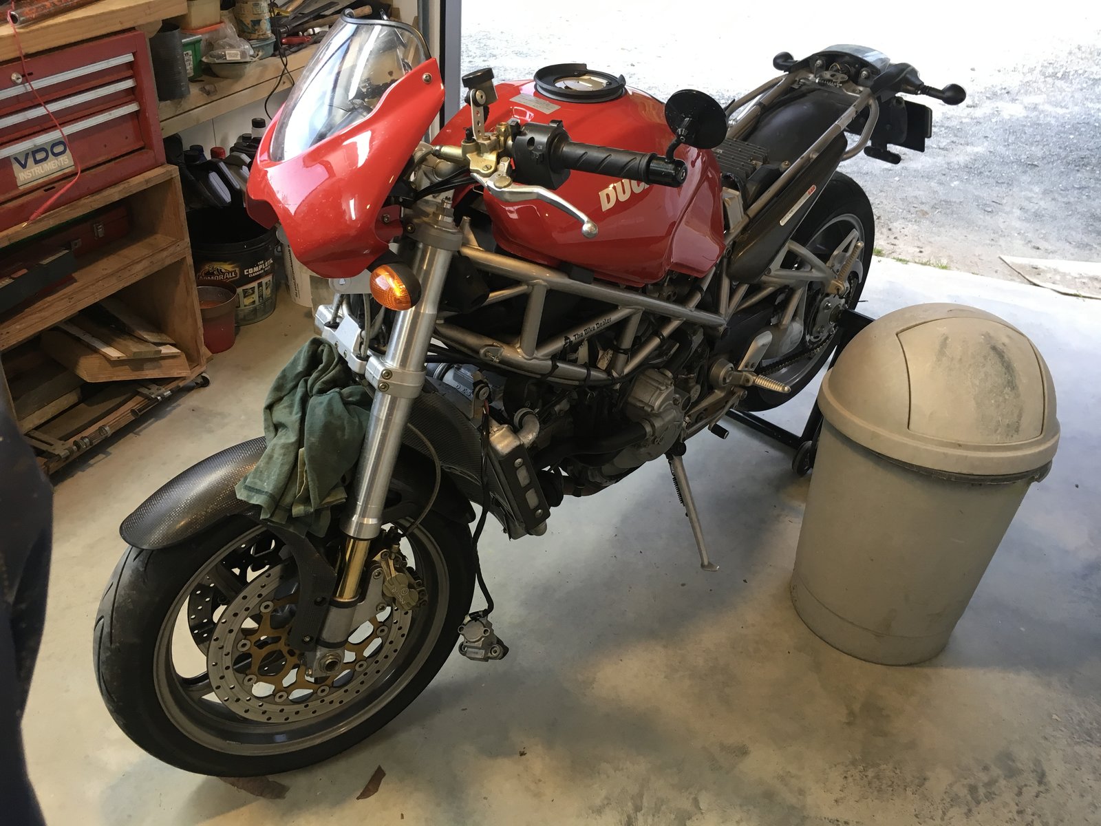

  1. IMG_1025.JPG Right, so I appear to be on top of the issue although I may not have seen the end of it. I refitted the key and antenna and no different. I wiggled and jiggled loom around the steering head, opened and inspected every plug connection around the front area and tried again. After turning the key on and off several times it lit up and motor started as normal. Turned off and it reverted to "wink off" mode again. Right so lifted the tank and removed ecu plugs and inspected, removed relays (left breast)and sprayed all terminals with CRC 66 electric spray. Then removed reg/rec fuse (right breast) and it was a bit schmootzy so I sanded off the legs and put dialetic grease on and replugged. Tried key again and nothing, nothing nothing etc but left key on and pulled right breast fuse again and lights came up immediately. Pushed fuse back in and it stayed lit up, started bike and ran for a bit then turned off and re fitted all the stuff lying on the floor. Cycled switch several times with no problem then started it up and rode it to shed ready for weekend ride fingers crossed. So, if it happens again, I will lift tank (thankfully easy!) and pull reg fuse. I know it is charging so I am not going to touch anything else in case I jinx it....
    Thanks for all your suggestions, comments and interest!

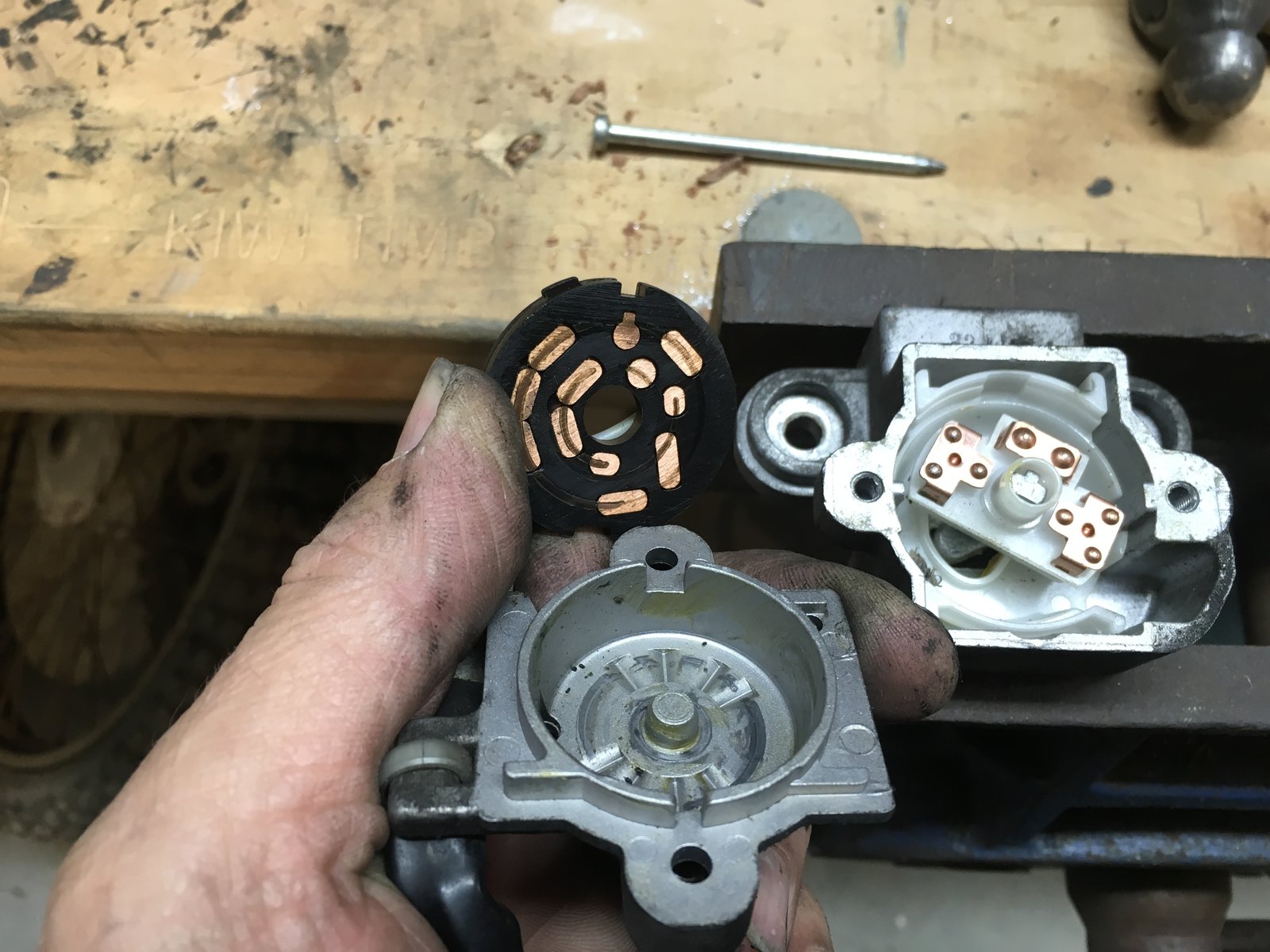

  6. IMG_1014.JPG Just as an aside, it may be useful to someone to know how to open the ign switch. Basically, you need to dot punch and loosen the screws (they look like a rivet but are a snap-off type set secrew) with a concrete nail and then use your handy vet-lab relieved forceps to back out. Then you use a mini hacksaw to put a groove in the screws so you can re-use them. Easy.
