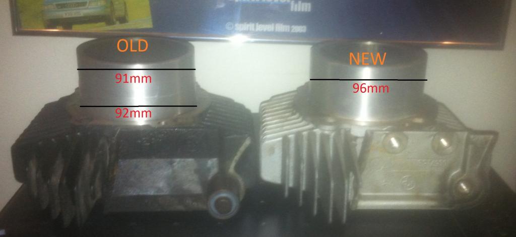

  5. I think I've made a blunder here chaps. I bought what I thought was a 600 Monster/SS bottom cylinder bore and piston only to find they're slightly different, the piston is slightly different in shape, but only 5grams lighter so I figure it will be fine (some bore/piston dimensions) but the bore is different to a point where it's unusable.
    I've included a picture to help describe the problem. The outer diameter of the bore cylinder is 96mm, not the 91mm and 92mm diameter respectively of the one I'm replacing. And, subsequently doesn't fit in my block! all the oil galleries are correct, have a got a slight older or newer model bore/piston?
  6. Looks to me you have a larger capacity cylinder and piston there...900...or even 1000cc

  7. I think the clue is in the '96mm' as opposed to '91' or '92'.......:wink:

  9. What is the bore diameter of the new cylinder? 92mm will be a 900 pot?
  10. 96mm as per picture...what's that from?
  11. The dimensions he gave aren't the bore diameter, they are the cylinder spigot diameter.....
    AL
  12. So they are Al.....so he most likely has 900cc Cylinder.
  13. Not familiar with the aircooled varieties but looking at the photo it appears that the thickness of the liner on its botttom edge is greater hence the 96mm dimension?
  14. Sorry guys, you're getting confused. The picture I posted shows the OUTER sleeve diameter, not the inner PISTON diameter. Both barrels have the same 80mm bore and 63mm stroke, but the sleeve diameters differ. I gave my buddy in Bologna a call and he's identified it as the barrel from a 1998 - 2001 Monster M600 Dark fuel injected engine. He confirmed what I already knew that it wouldn't fit in the block. So, I hope my mistake will help anyone in the future, if you need a new barrel, then they are year specific. 1994 - 1997 Monster/SS for carbs, 1998 - 2001 Monster M600 Dark for FI. And obviously, the 620 model is completely different all together.
  15. So my comment 'The dimensions he gave aren't the bore diameter, they are the cylinder spigot diameter.....' was correct, then....
