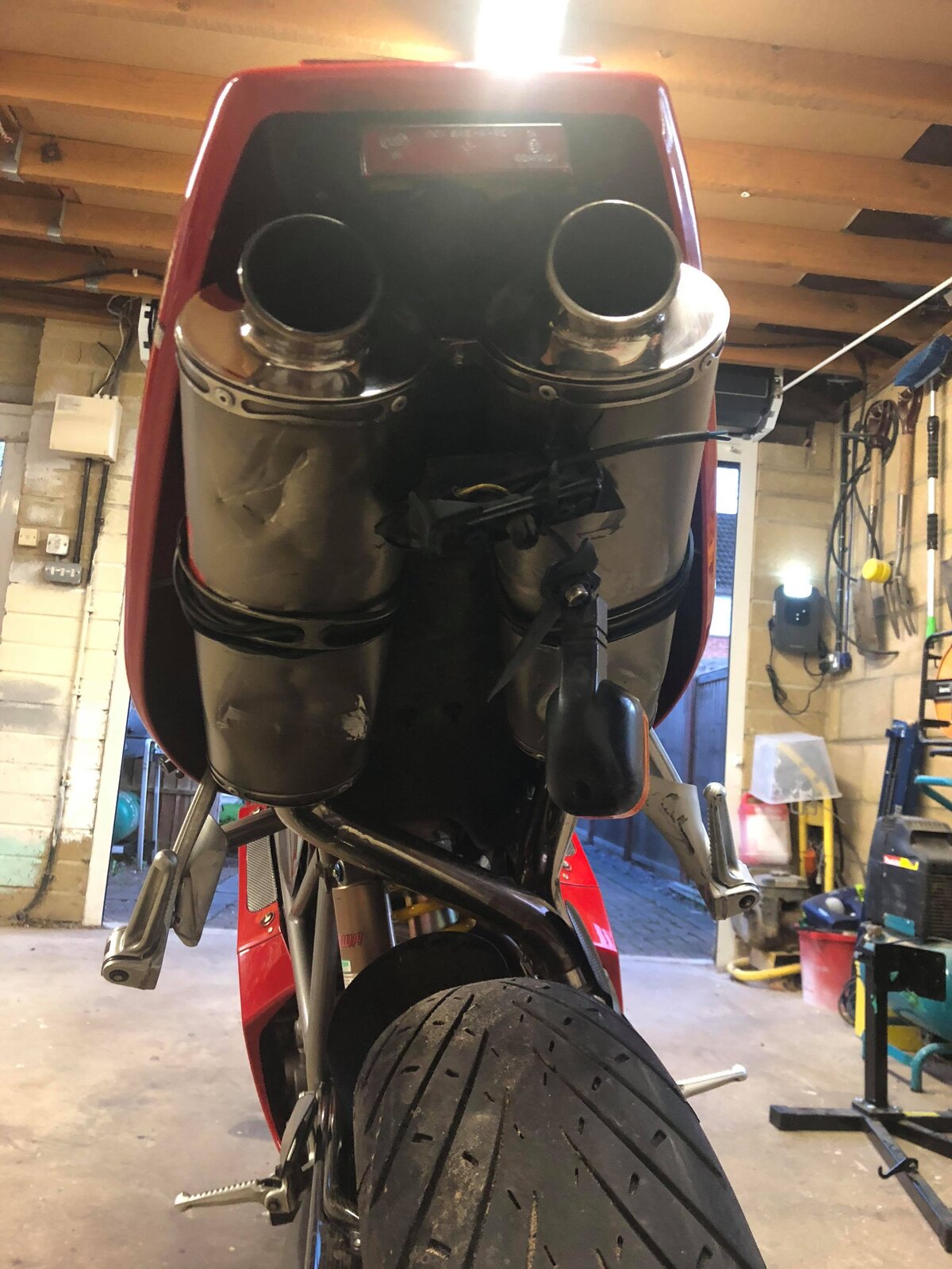

    I would be damned if I would scrap those cans. What damage there is is only underneath and by keeping them you get bragging rights too!
  3. Get the cans back to jhp for a re sleeve.

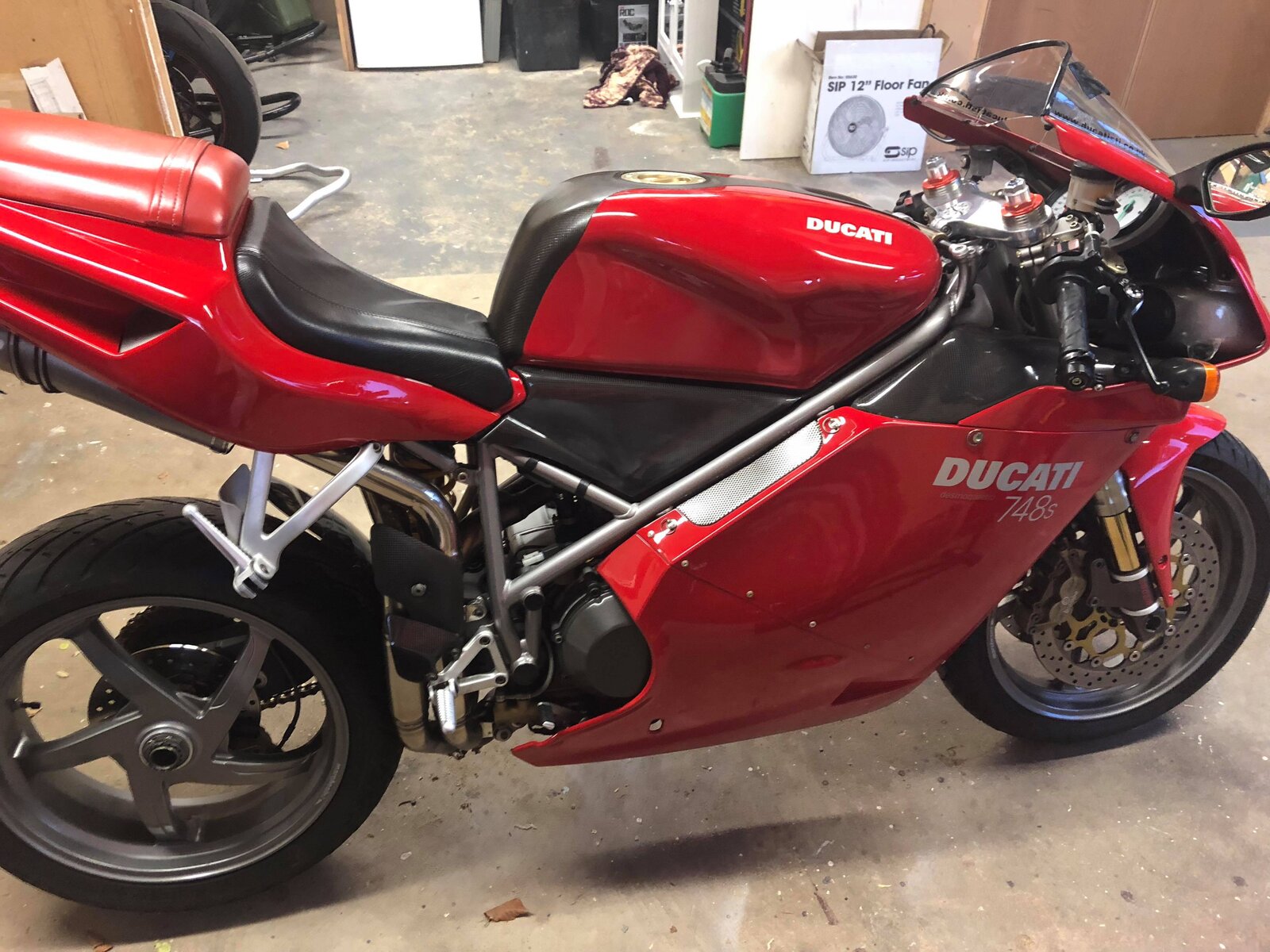

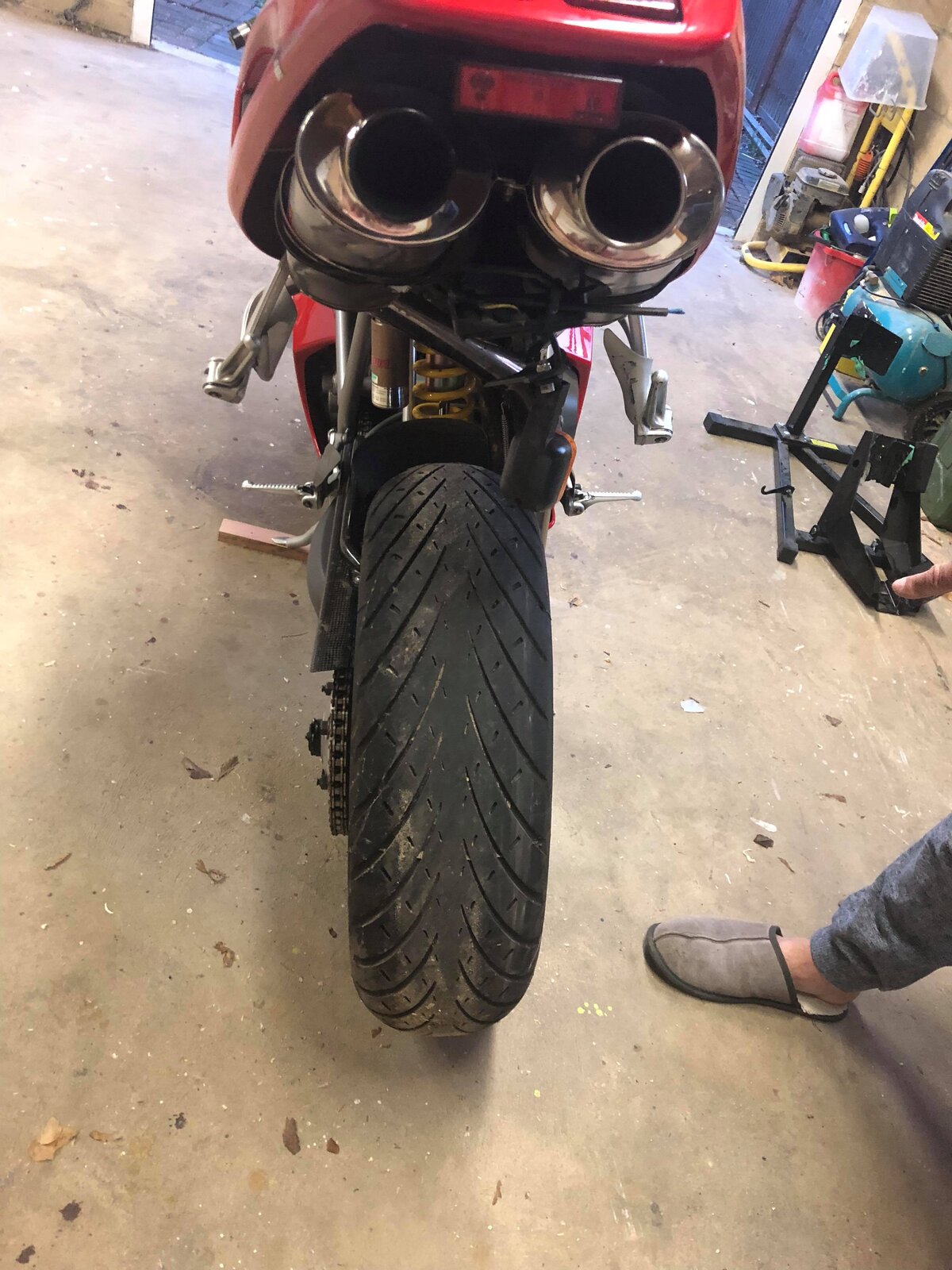

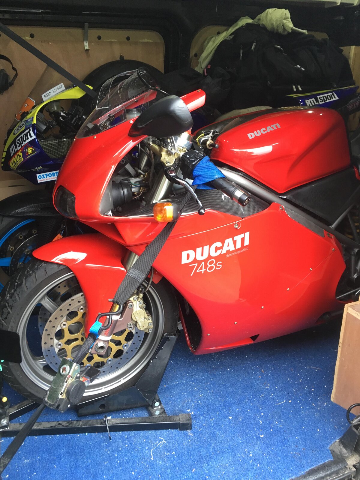

  5. The first picture makes it look like as the bike leans left on the stand, the rear wheel is not in the same alingment?

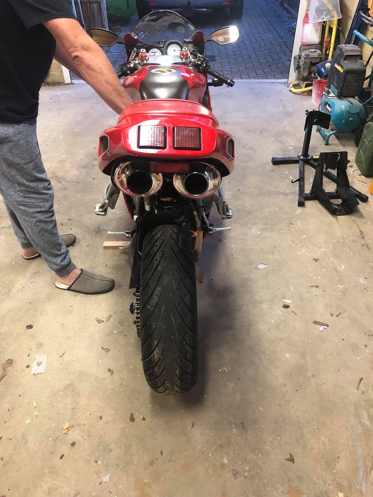

    God what on earth happened on the second picture, who suggested those slippers ? :D

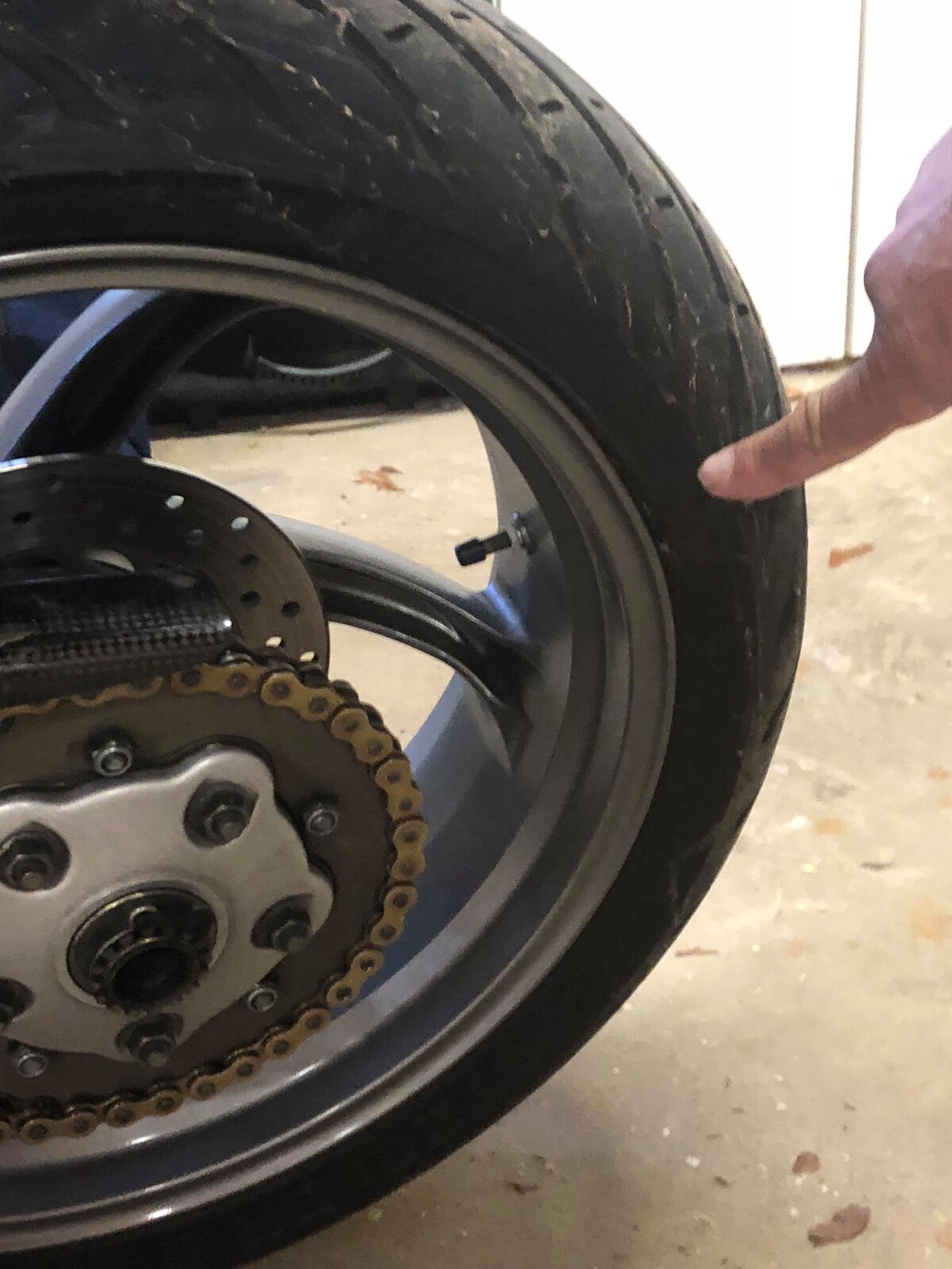

  6. That looks a lot less damaged than I’d expected, but make sure everything is checked carefully and thoroughly!
    The back wheel, wheel bearings, swingarm, swingarm pivot and engine cases appear to have been the load path, so any or all of those may have been bent, twisted, cracked or just overstressed.
    The exhaust cans don’t look bad, but check the link pipes haven’t been pushed forwards too, and that they still clear the suspension links and shock.

    I don't want to put a downer on things but after an impact which has pushed the bike 5m I would expect something to have absorbed the impact.
    The seat unit does not look level, (bent subframe?).
    The fact that bike remained upright has saved a lot more damage.

  9. The bike's babysitter said to me after he picked it up that the seat unit was definitely not right, although from what Dad was saying to me in hospital he had visions of it being completely smashed to bits ("I've got a spare one though in the garage...") - it's something! It was apparently still intact enough for the guy at the recovery compound to comment that it was a "really nice bike" :joy:
    It is also definitely leaning on the improvised stand and the rear wheel isn't quite the right shape any more. Has since been put on a proper paddock stand now one which fits has been sourced locally but I don't have any pics of it on this.
  10. The slippers wouldn't be allowed at Denzil Towers for a number of reasons, let me tell you...

    Motaliner in Maidstone should be able to straighten/fix the wheel, although I think I would definitely replace the wheel bearings and the swinging arm bearings (and maybe the SA pivot shaft) which have probably got flats/indents in them and the rear tyre. GWS.

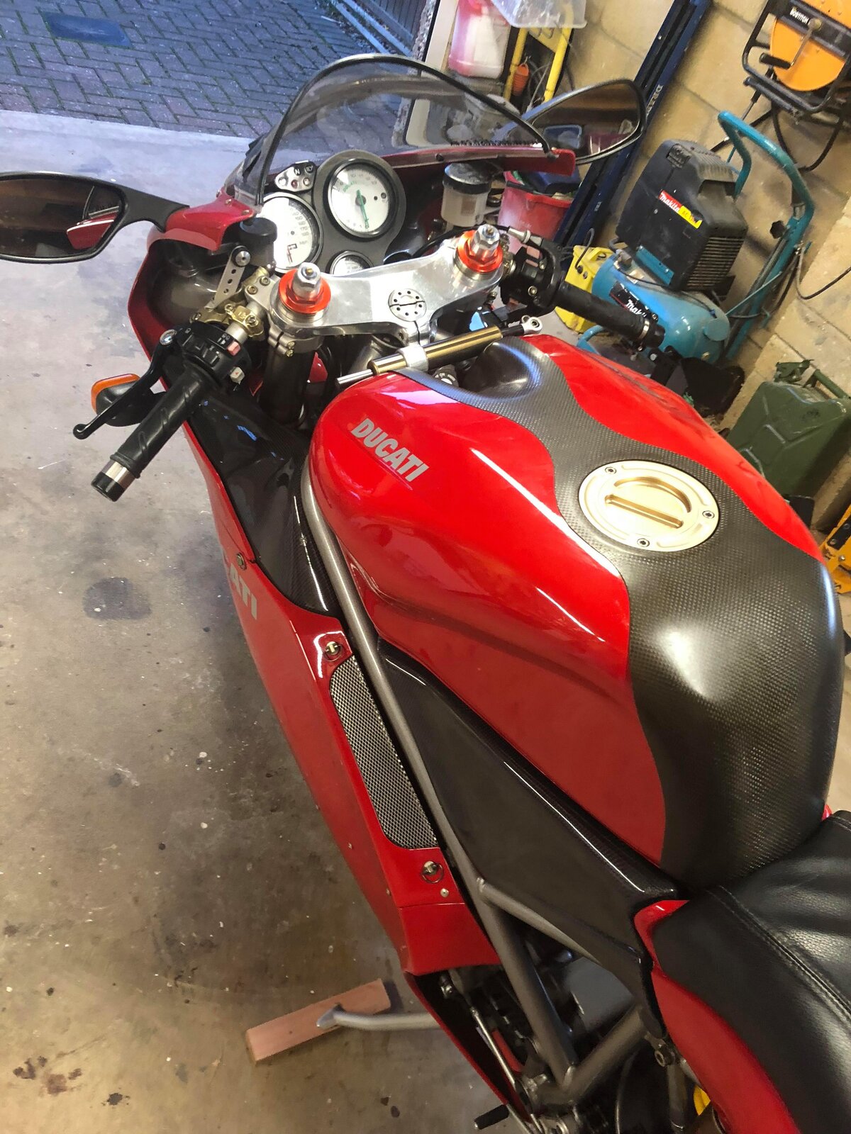

  15. I was expecting worse pictures Denzil but it looks like it is made of strong stuff just like you
