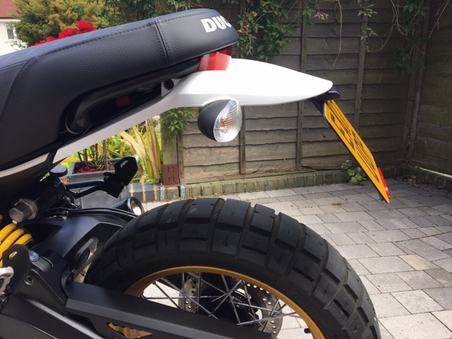

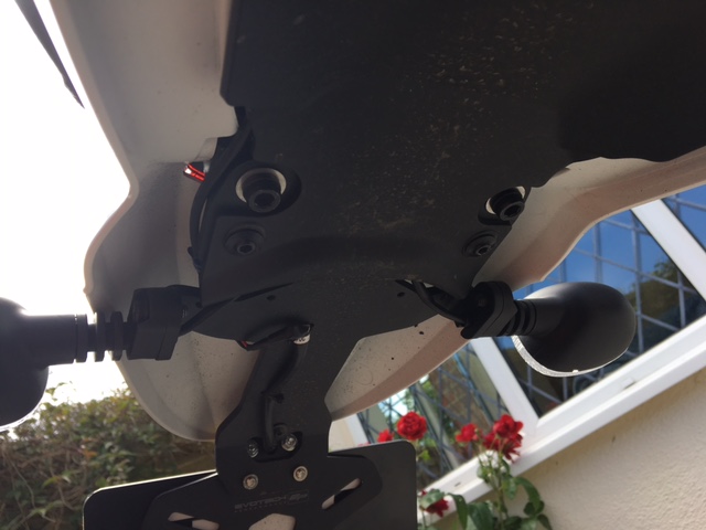

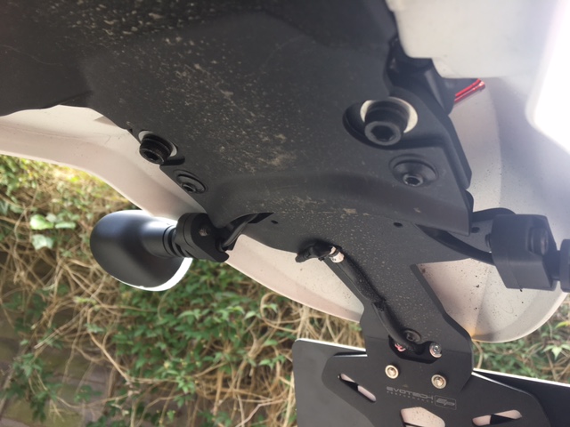

  4. Message for Boomer - pictures attached of Evotech Tail Tidy. Might tidy the wiring, the two bullet connectors were too large to fit above the inner plate so had to route them around the indicator. Will probably cut, remove and do two inline solder joints.
  5. Thanks Hatrick
    Looks good
