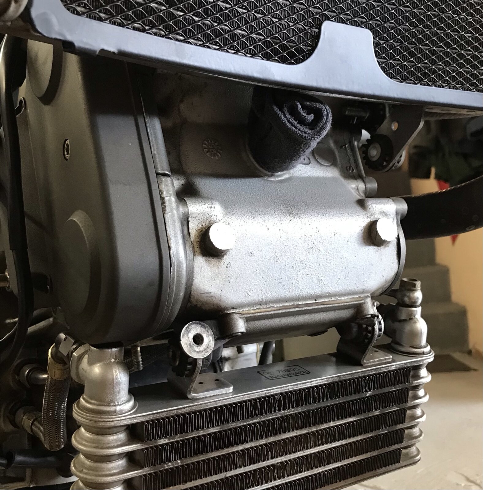

  10. On the 916 SP (94 to 96), it’s the exhaust side of the head on the horizontal cylinder that doesn’t have any casted inscriptions in order to maximize room between the front wheel and the horizontal head. 072C0E73-4F7A-48F2-89C7-67FC5854ECF5.jpeg
    Like gaining 2 millimeters. Doesn’t seem that much to me …

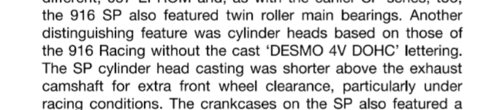

  11. FWIW, Falloon confirms the SP head was cast shorter on the exhaust side:
