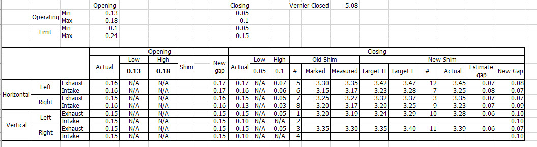

    • I made my own closing shim measuring tool as the ebay one was rubbish ... just used a cut down allen headed bolt which slotted neatly into the shim and Vernier to measure.

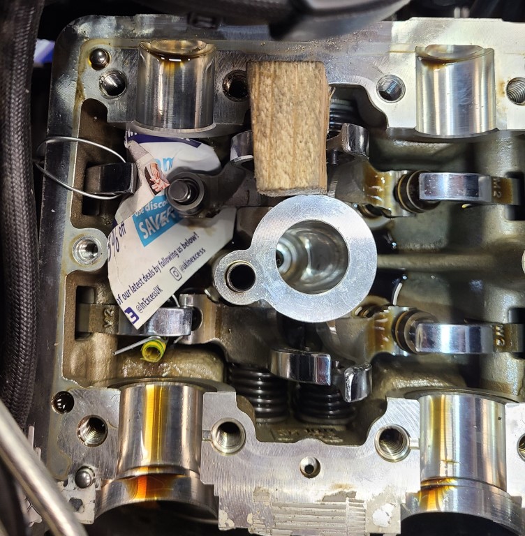

    • Use a paperclip or similar to hold any loose valves in position on the vertical cylinder when you move to the horizontal cylinder to prevent the valve dropping.
    • I used a small block of wood to wedge the closer rocker arms apart to free a hand when trying to remove/replace the tricky little collets, also a piece of card cut around the valve stem to catch the collet and some plastic tubes stuck in the oil ways to ensure anything dropped was retrievable.
    • Make a table of all the clearances and the shim measurements you remove ... I was able to swap some shims around to save buying new
    • I had trouble "seating" the collets .. you need to let the closing rocker snap the closing shim to seat it securely on that valve stem at least a couple of times - make sure it's aligned first.
