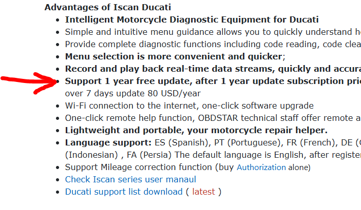

  9. Looks like a good price, suspiciously too good to be true. However, reading the blurb, and extra pages of their site, it seems to be sent from a UK warehouse so no issues with customs/VAT charges. £60 less than BMDiag. Not sure about the level of support, should you need it, would be my only concern. The phone number has a +86 country code, this is China... Don't be fooled with the obdstar.co.uk domain name, I don't think this is the same company as obdstar.com who is the manufacturer.
    It should come with one year of updates included, there after you'll need to pay if you want the latest updates. These are new models in the Ducati range that they add or any new features for your bike. As your bike has been out of production for a few years I doubt you'll be missing out. The Unit will continue to operate if you don't update it (unless they've changed something...).

  10. Hopefully you'll have ready everything - this is all I can see.
    I'd assume that as you're buying the Ducati version you'd expect it to work on your Ducati out of the box with no subs, etc extras. I bought mine 2nd-hand so unfortunately can't be more helpful. I think @Bumpkin bought new, so can maybe clarify...
  11. Yes, bought new from BMDiag. 1st year included. Came pre installed with Ducati data out of the box. Needed updating, just a case of connecting to WiFi and going through the process in the menus. It's effectively a small Android tablet.
