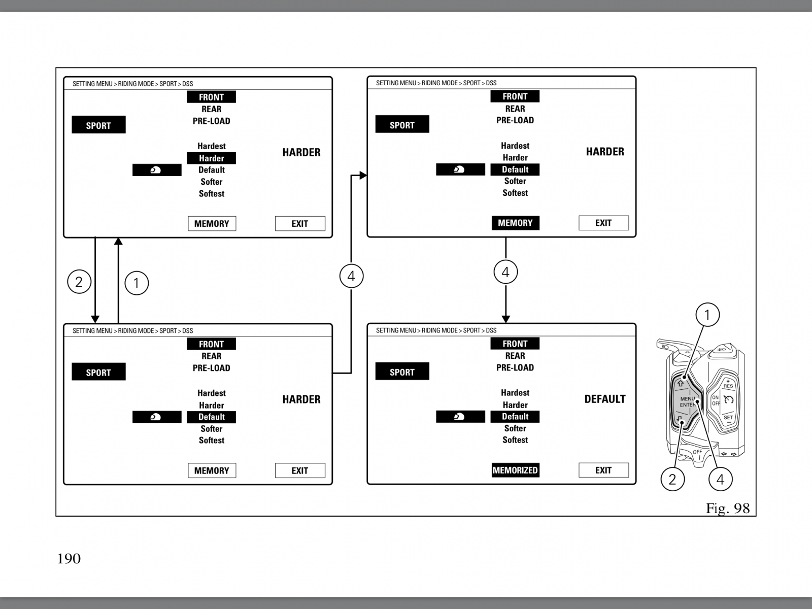

  8. My bike isn't skyhook. I'm trying to use the info in the owners manual to make adjustments as well as seeking guidance from internet sources but it's becoming confusing as not something I've delved into before. Think I'll leave it.

  11. Summary of the good advice
    -Start with preload to give you a rider sag of about 40mm (at a guess, its long travl, normally 30-40 for most bikes). You will need a mate and tape measure!
    -Add compression to slow the rate it dives. Keep addining until you notice the difference and is better
    -Liekly you'll need to adjust rebound if yiu go a long way with compression
    -If thats not enough and you cant dial it outband everything is wound right in, give it to a soecialist to change oil/air gap, then springs, then cartridges

  19. Sorry my wording was wrong, it's not actually the preload what's adjusted but the fork compression and rebound setting. That will get the result what's under discussion here, right on the spot.
