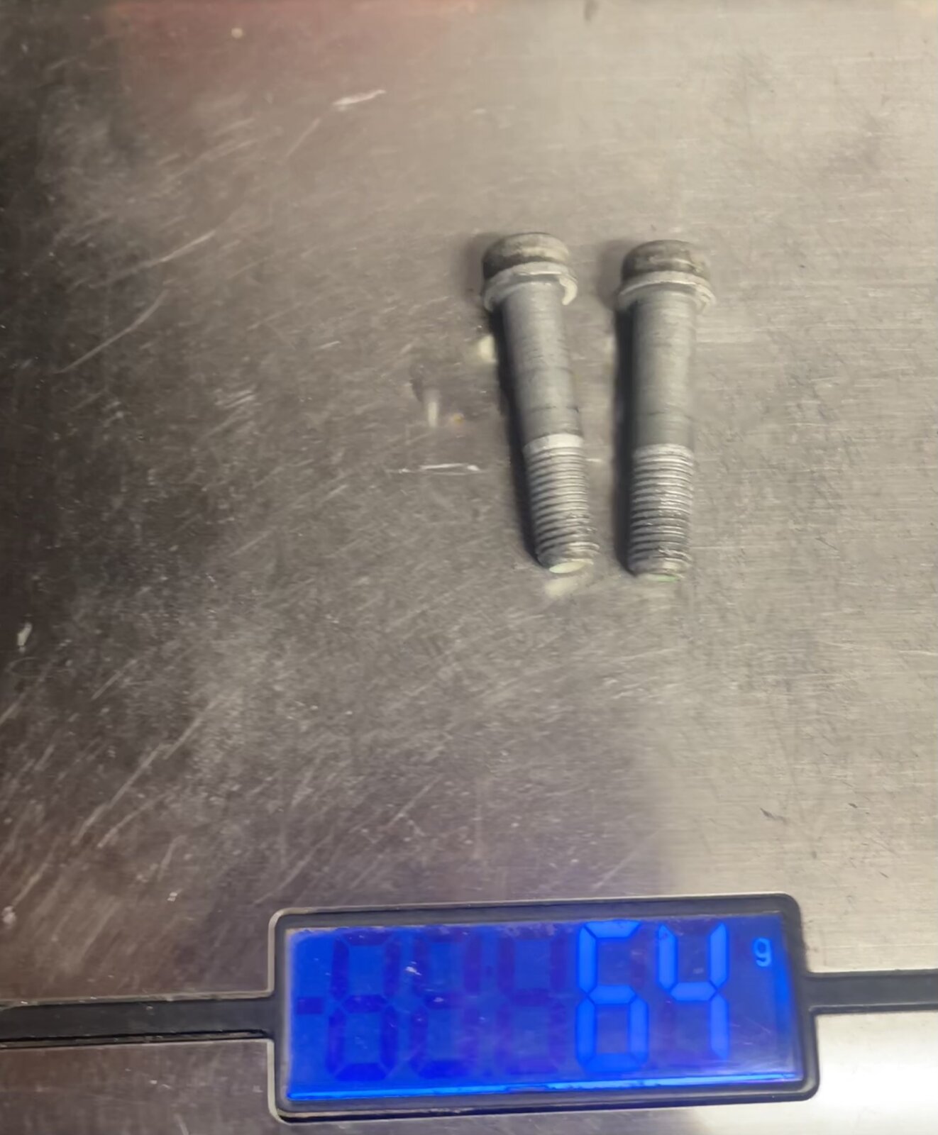

    firstly, I’m not doing this for weight saving, be far cheaper to stop eating as much and lose several stone… I’m doing it because some of the bolts need replacing as they are corroded and I like shiny new bolts

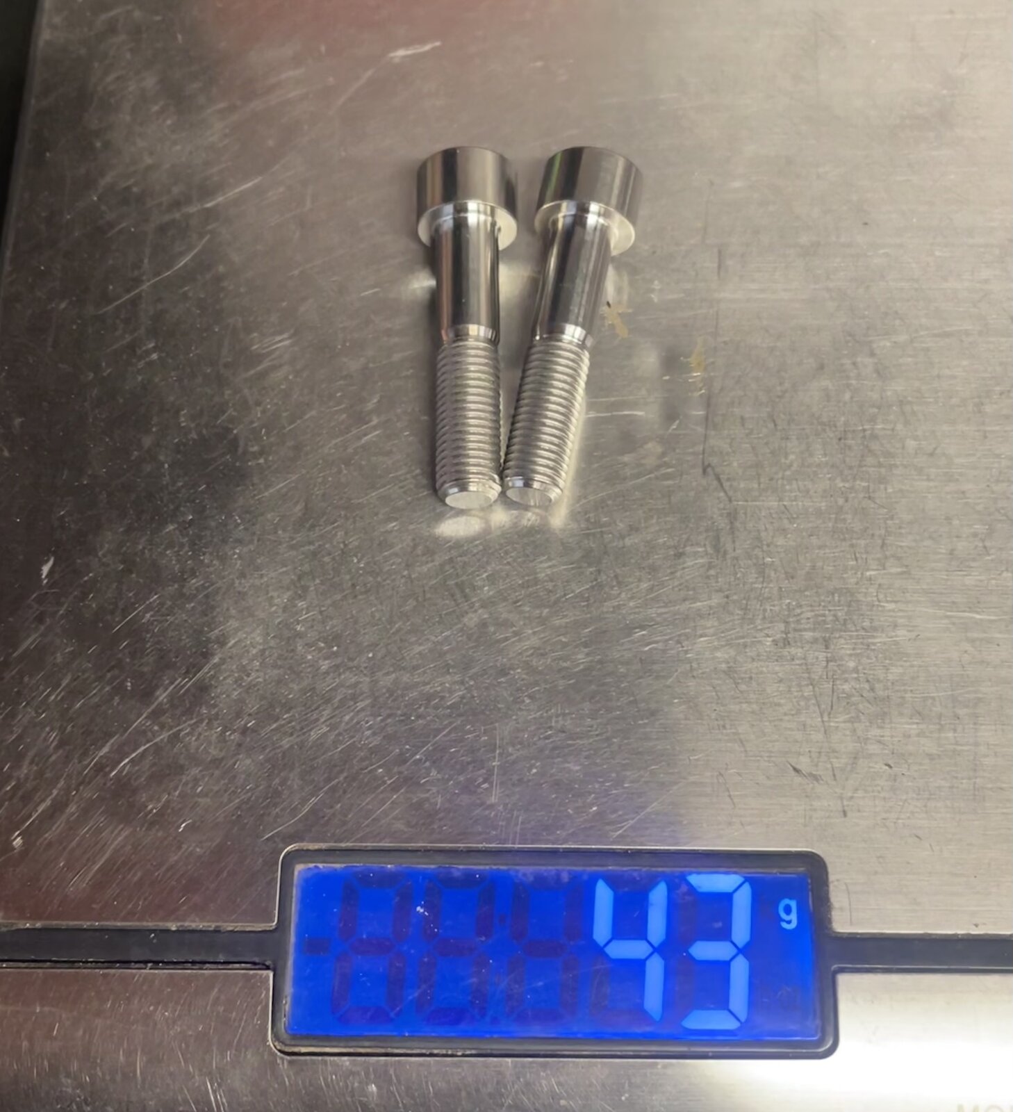

    Shock bolts -
    Out with the old bolts
    And in with the new titanium bolts. 2x M10x1.25x45
    I have association with RSR Moto, but this is the link for the bolts (£4.99 per bolt) https://ebay.us/2Vg3W4

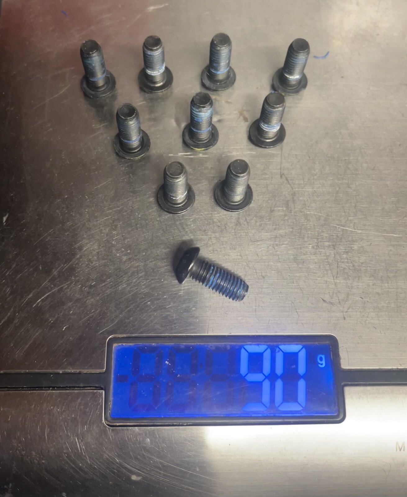

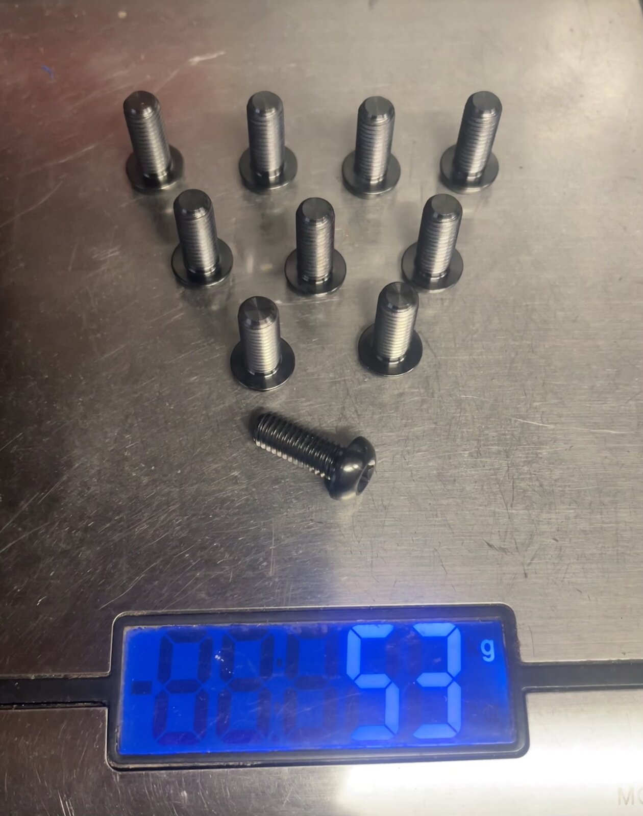

    Front Disc Bolts -
    Out with the stock bolts…
    and in with the new RSR black Titanium bolts, 30nm and a dab of thread lock
    I have association with RSR Moto, but this is the link for the bolts https://ebay.us/5B4h7f (£29.99)

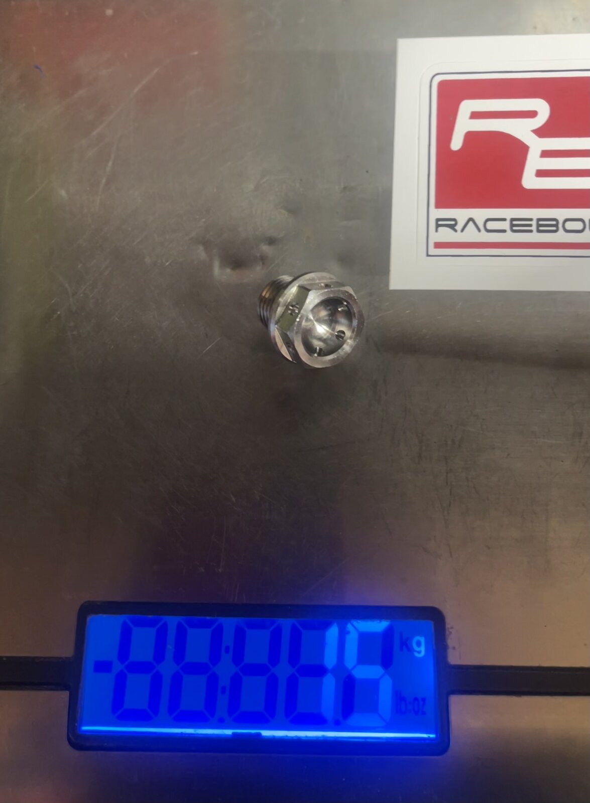

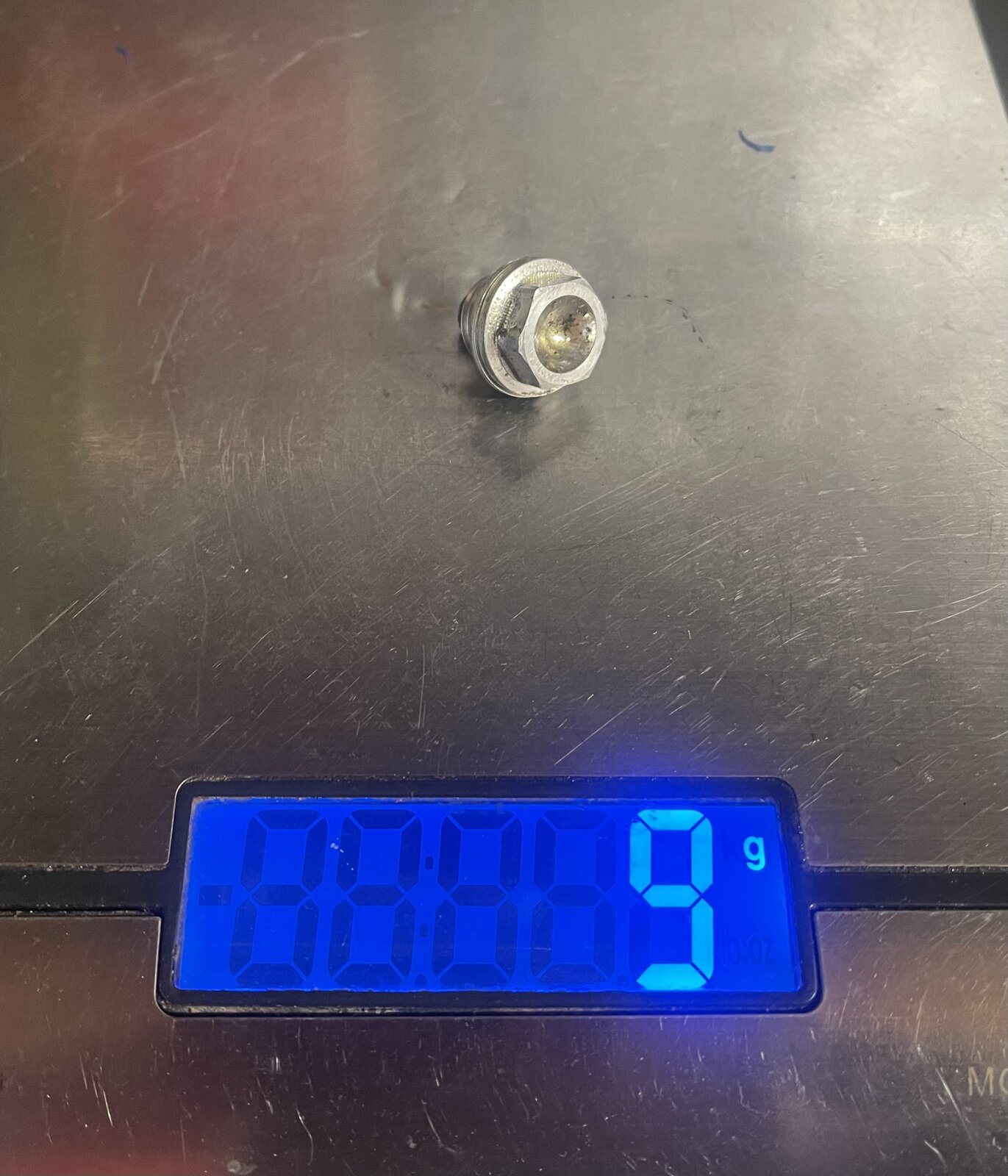

    Sump Plug
    insanely light sump plug removed
    And replaced with a magnetic titanium M12
    Race drilled plug
    I have no association with RaceBoltsUK. Bought on ebay for £25.34 https://ebay.us/ivwQG

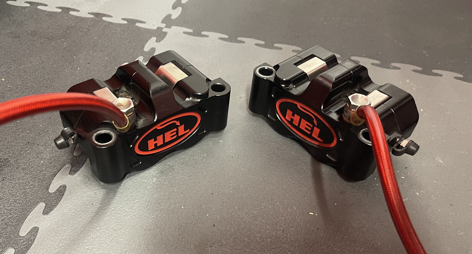

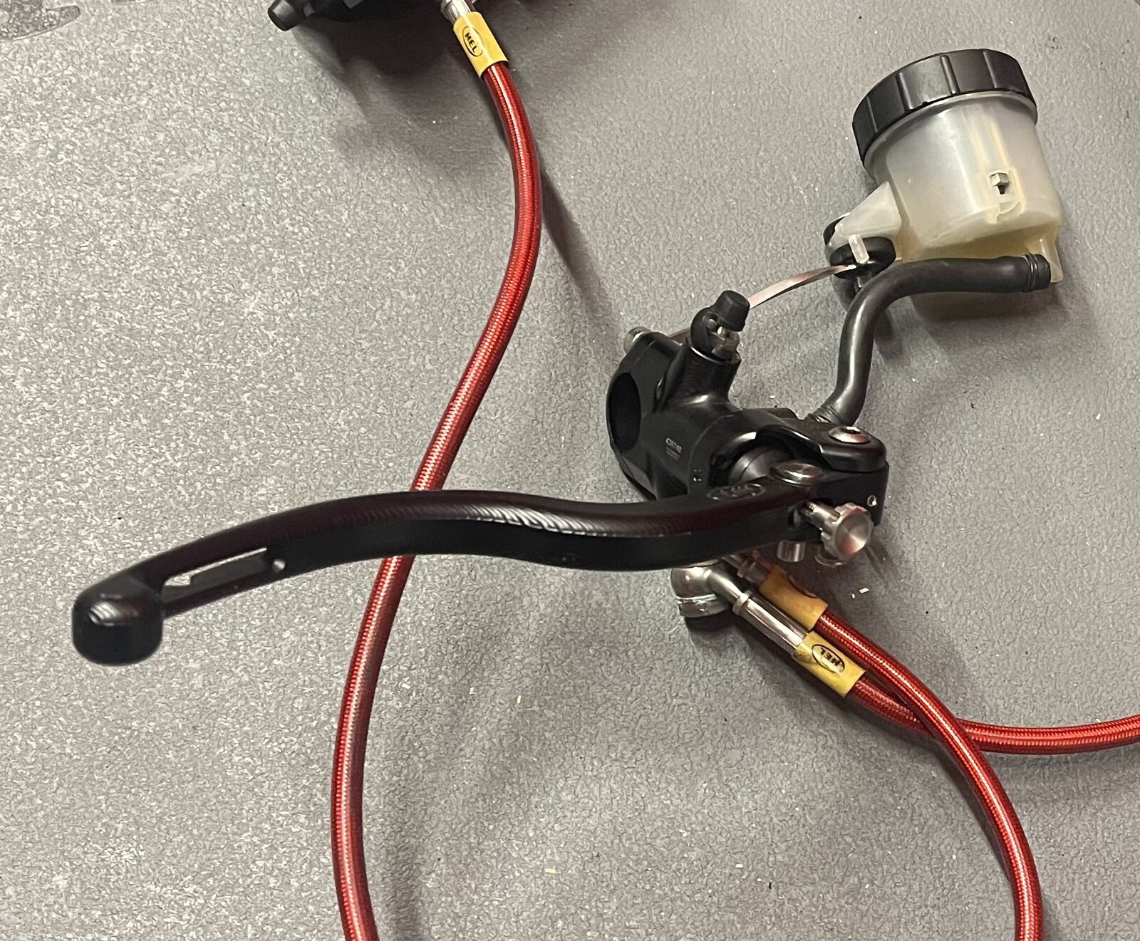

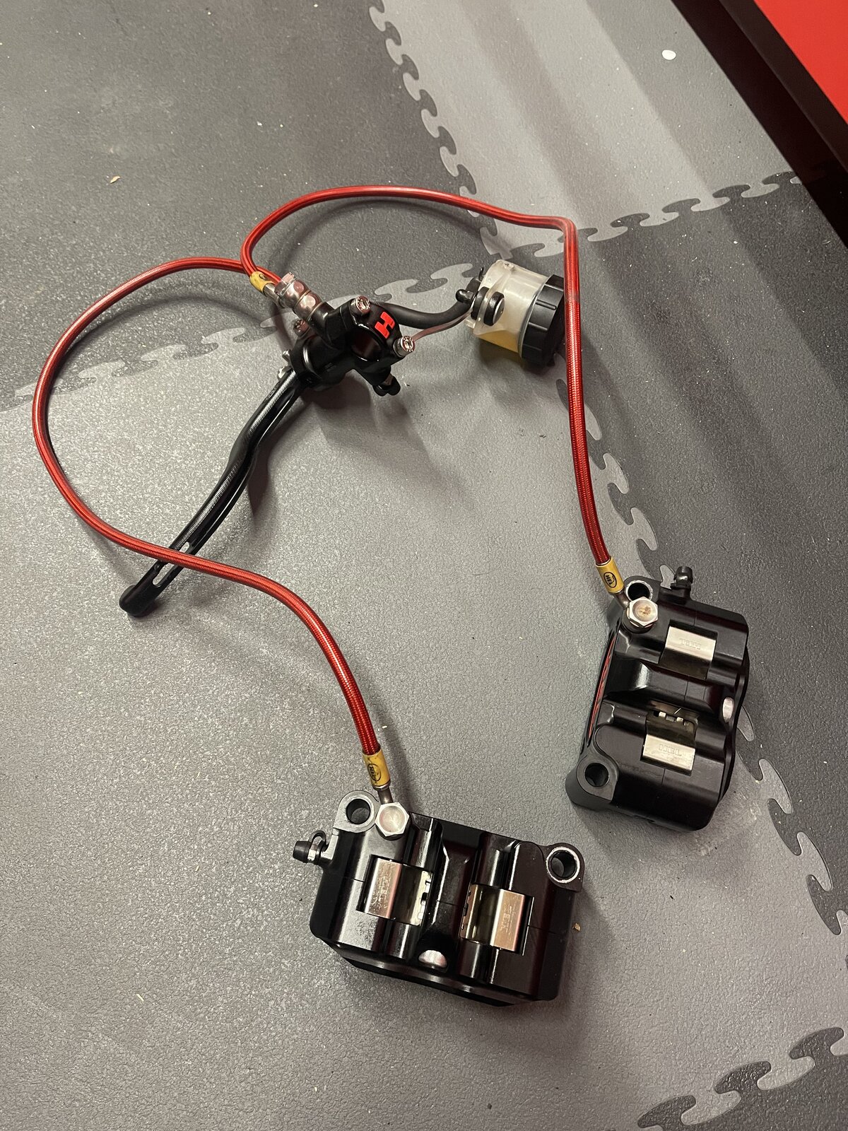

  8. Front Brakes
    Thanks to @Pablo Pirate for the Hel Performance goodies. I have no idea what Paul’s relationship is with Hel even after having a fair few bits off him in the past but if you are looking at Hel I’d recommend harassing @Pablo Pirate :upyeah:
    Sold the stock calipers on for £300
    Spent that and more on some black Hel calipers, red Hel translucent braided lines (Paul’s favourite :joy:) and a Hel black master cylinder.
    79944755-5834-41FB-B2F9-60D41E3DE661.jpeg 55E41580-140A-49C6-A7DF-33108E3CB38C.jpeg FE6C7837-E804-417E-9FDB-C36E5E9AA8A3.jpeg

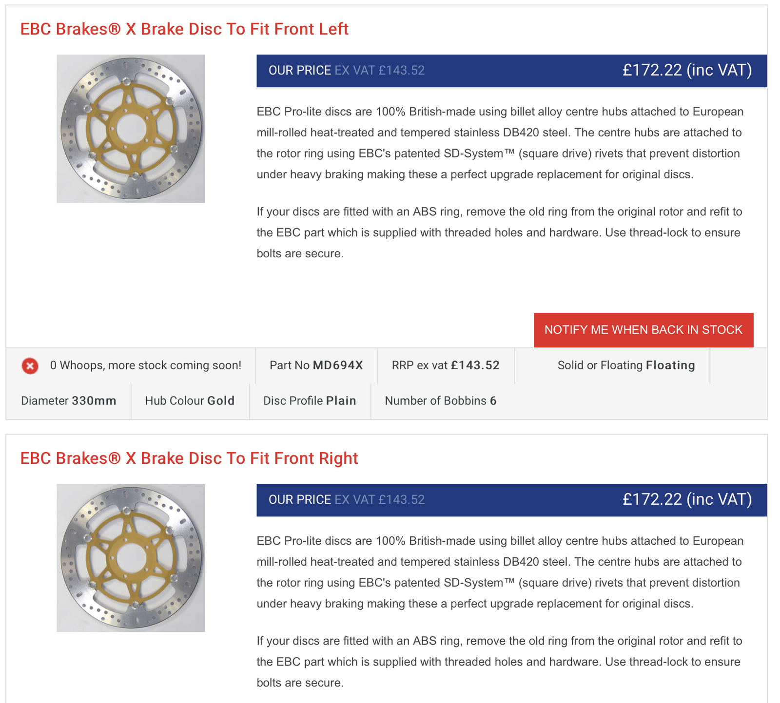

    With the EBC discs I got from Tom at
    https://www.motorcycleraceparts.co.uk/ Ive noticed that the caliper spacer needs to be 10mm minimum unlike the 5mm used with the stock calipers. But Paul got them sorted for me :upyeah:

  11. Does the brake res. come with the master now? Or did you get the bracket elsewhere?
  12. i got hel on my gsxr though not tried them yet.
  13. that’s off the V4 brembo master cylinder. They sadly don’t come with the reservoir.
  14. You rate EBC discs then? Which model?

  17. So what are you doing with the ABS.......and more importantly its contribution and involvement in things like the engine braking strategy...? which is why most in the know would advise
    not to change the size of the callipers
    not to remove the ABS
    if you intend keeping the std loom, ECU, and black box set up..
    It says they are 330mm so the difference why you need bigger spacers will be down to the callipers.
    I have to say I don't get the logic of all your brake combination.

  19. I might have missed it but what's the logic behind ditching the Stylema calipers? Surely with a Brembo RCS and maybe better discs and pads they would be about as good as you could need? Unless it's purely looks?
    I too would be interested to know what the bike will do with ABS disconnected, especially if it is indeed adjusting it's engine brake strategy according to wheel 'slip' at the front (seems like a futile effort at the point the front is already locking!). I had similar issues when deciding what to do with my R1 ABS, because some said the ABS delete screwed up the Traction control, it's b*ll*x, doesn't make any difference at all.
