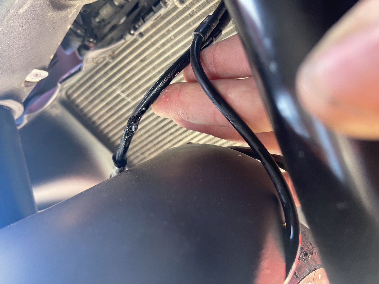

  17. My first experience of bypassing the ABS was a result of the front line catching on the front tyre at donington, fortunately split in pit lane so, I removed the rear caliper and used the rear abs line to fix the front brakes bypassing the pump.
    zero issues and got a session at the end of the day good old Matt Antony to get some pictures :punch:

    I know when jhp looked at doing the master direct to the callipers, they ended up putting a T piece in to maintain the pressure to the ABS unit..
    The pipe under the mudguard route is attrocious I grant you, but it catching the tyre will be down to fitment into the rubber grommet. I agree the two pipes around the front of the forks is a much better route (gp style) ...

    You are right about one thing, the previous owner hadn’t fixed the brake line over the mudguard correctly which had caused it to fail as it had rubbed clean through the line
