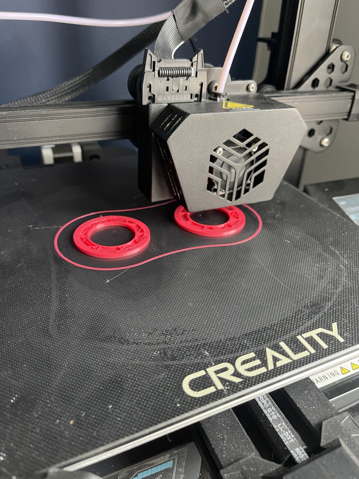

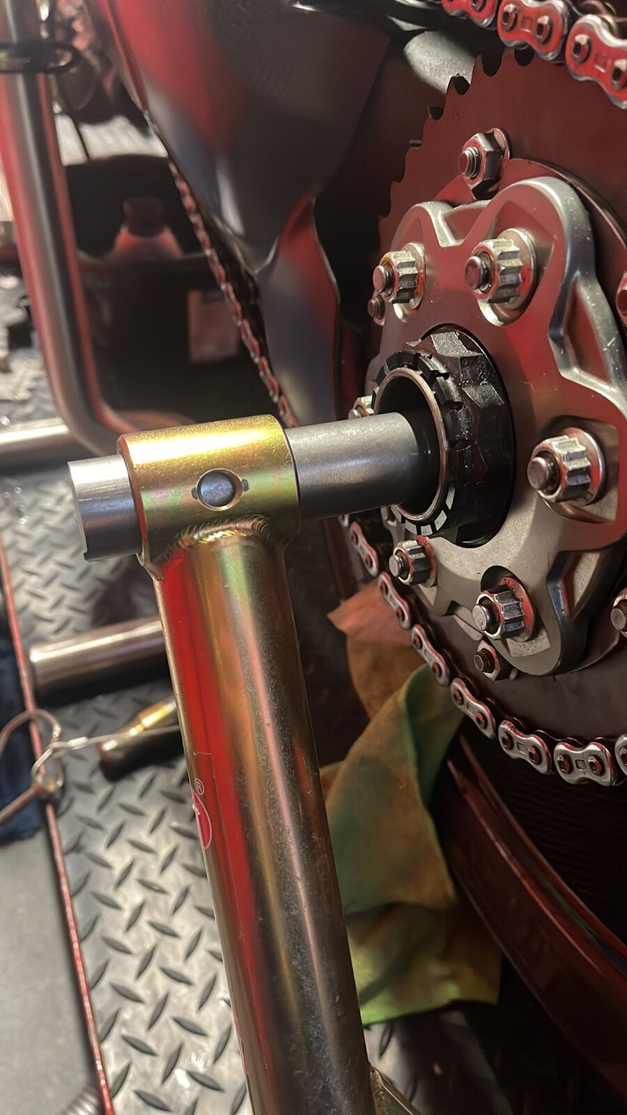

  6. Pitbull Trailer Restraint
    With the new trailer of got off tiny Ron Jolley it came with a pitbull trailer restraint system for his non Ducati motorcycle :joy:
    the pins to adapt the system to work with the V4 are around $200 with import taxes and shipping so as I need to get the bike to Nelly tomorrow to get the map off the ECU I’ve decided to make my own..

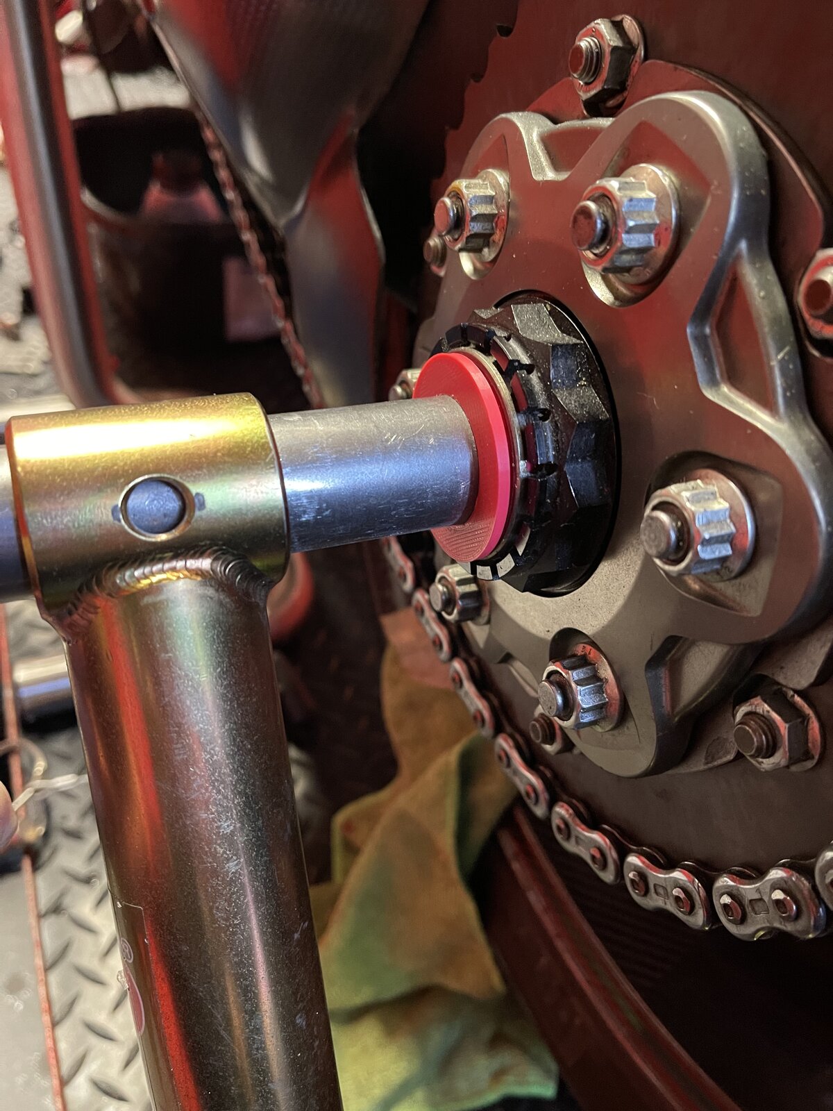

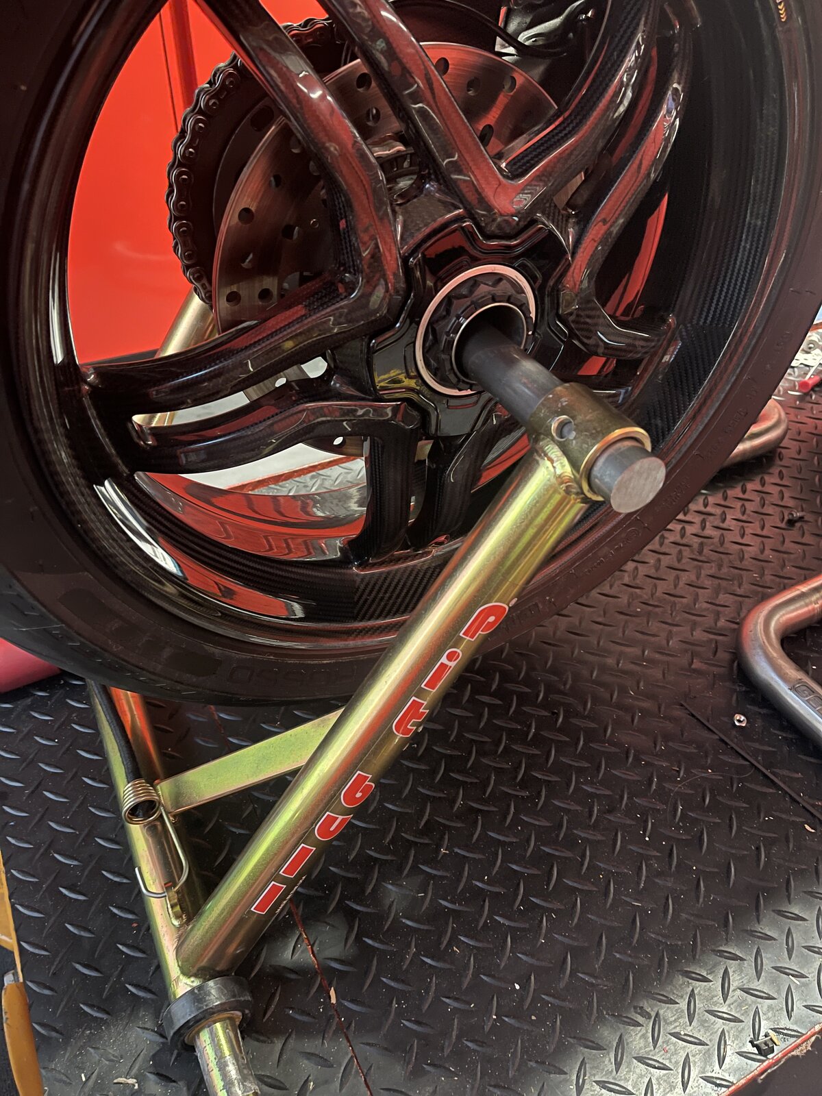

    I ordered 2x 200mm 28mm diameter steel bars (£12.53 per bar on ebay - https://ebay.us/Xd4Ke3) which fit the pitbull pin holes perfect. I’ve measured up and am printing some test sleeves to pop on the steel bar and slid into each side of the hub.
    DC6C1BE3-0D9E-4898-BD19-32F1B79775D4.jpeg ECE753B0-3FB0-444C-9295-997AA4901BFF.jpeg

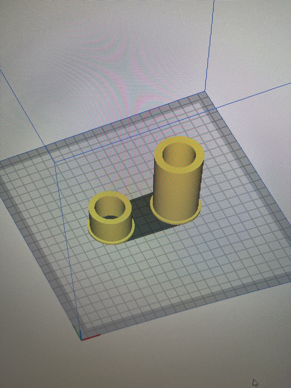

    the sleeve dimensions
    (Left) Smaller sleeve - 35mm tall, 39.9mm OD with a 28.1mm ID
    (Right) Bigger sleeve - 70mm tall, 41.9mm OD with a 28.1mm ID
    So knocked up a quick design

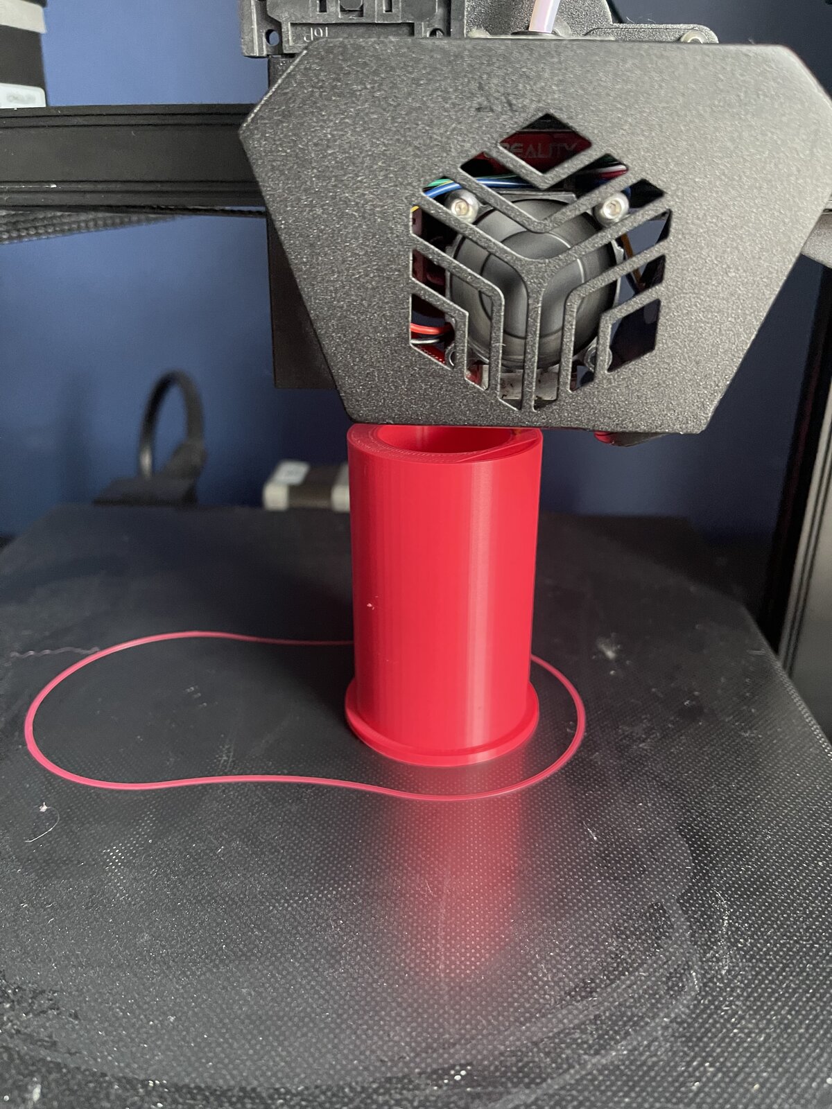

    And I’ll be back in 4 hours when they are done printing to see how they fit :upyeah:

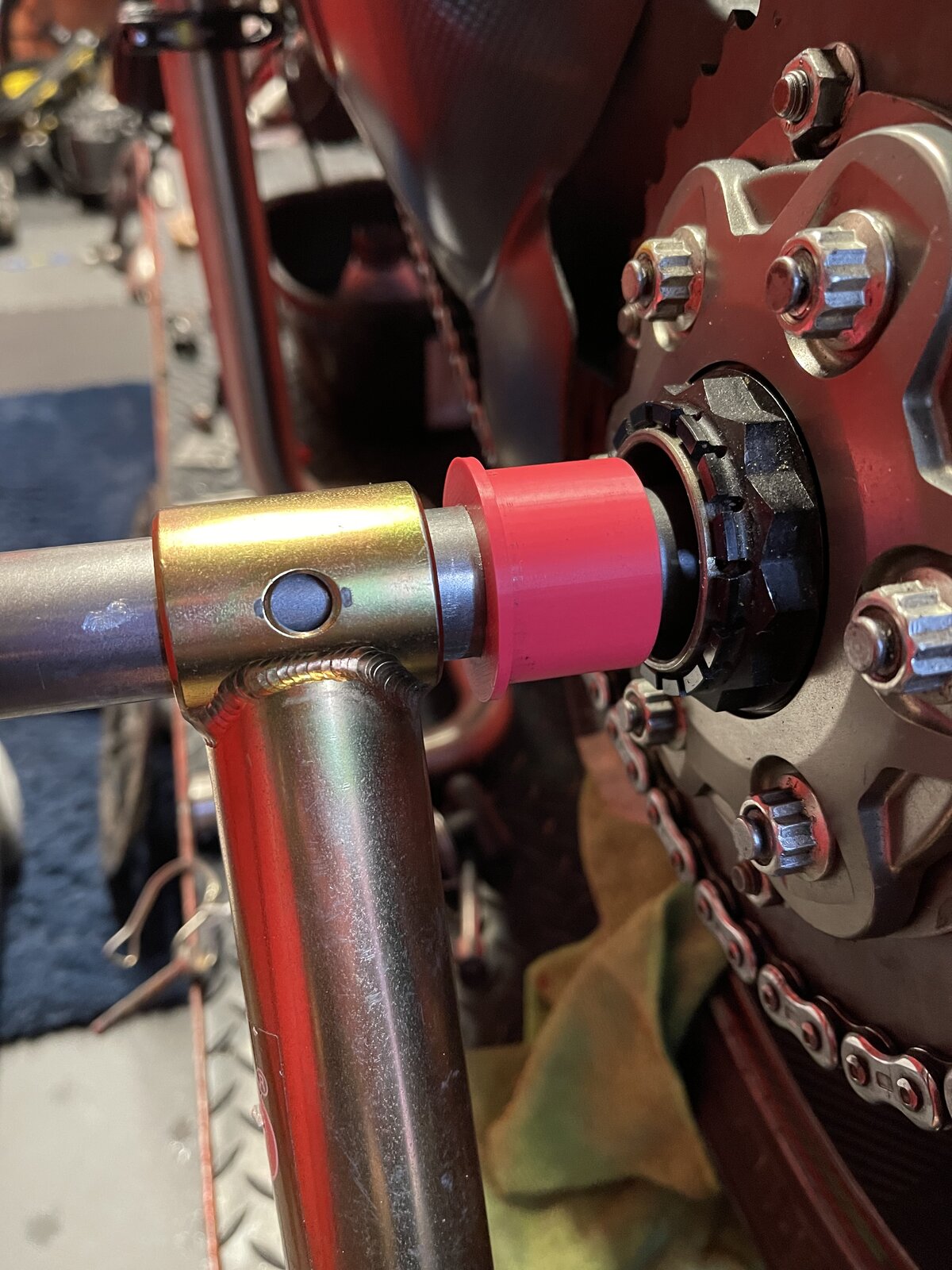

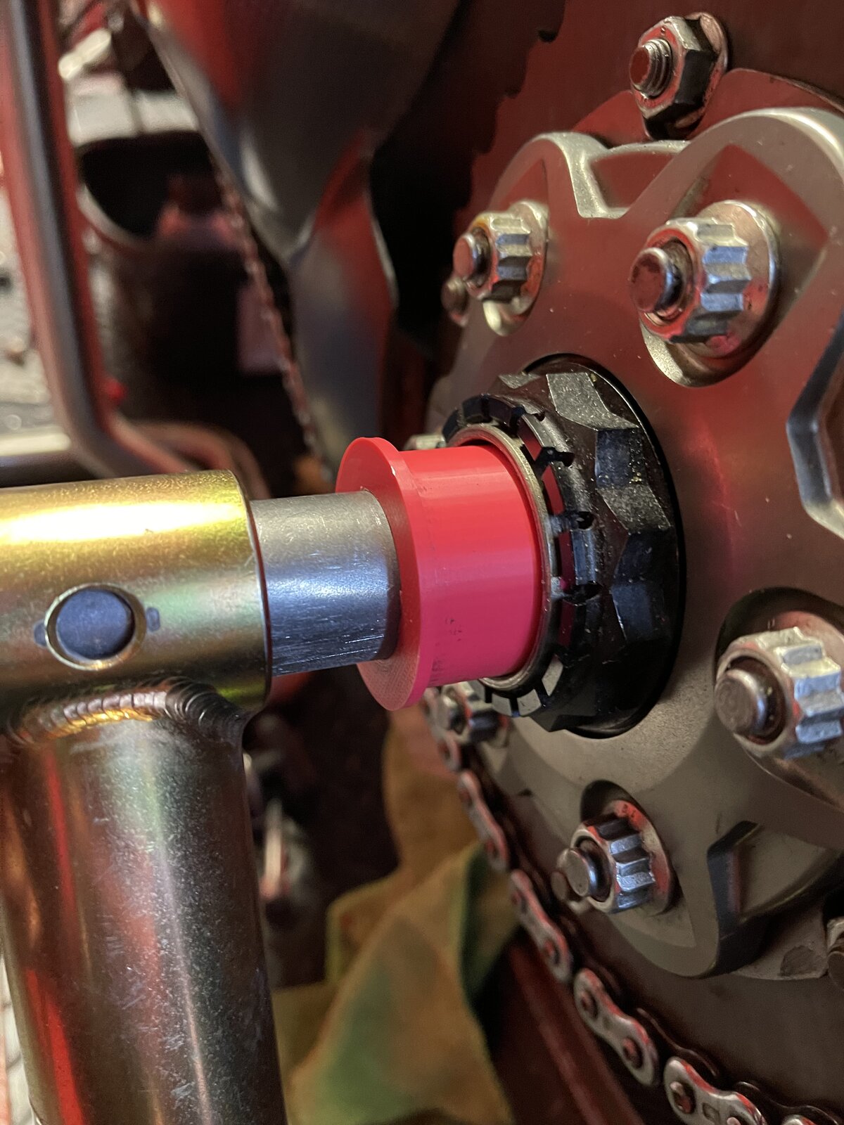

    Bit of an update, 35mm sleeve fits really well on the bar but maybe needs a slight increase in the external diameter…
    97FCA637-72B7-417D-BB8F-258FCD6E9A6A.jpeg 57DED6B0-311C-45D0-B458-7626FA31198E.jpeg 3118134B-EA44-4F38-93A3-740E7947DB0D.jpeg
    Still waiting for the 70mm :rolleyes:

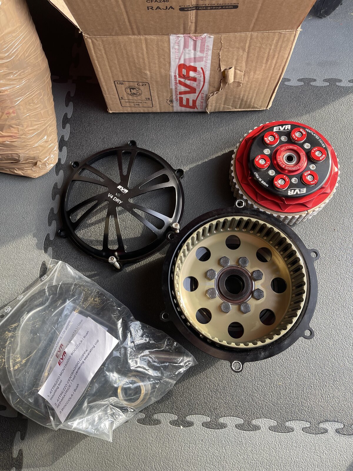

  16. Clutch Dry Clutch Conversion Kit
    Been a bit busy over the past week or so but some Italian goodness arrived today from sunny Germany…
    I’ve wanted to go a dry clutch conversion since my first V4 build but never quite got round to it. Can’t wait to get it in… is it spring yet?
    Guess that’s my weekend sorted. Might make a video of me fitting it, might not tho :joy:
    will definitely update on here when it’s in tho.

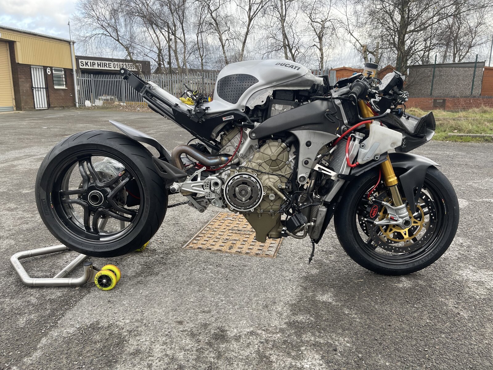

  20. Electronics

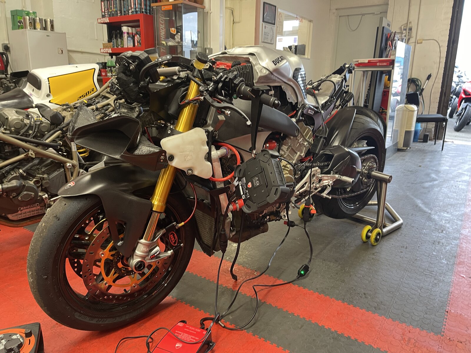

    As my build is around a 2018 base model V4 I can only get the EVO2 software update as opposed to the EVO3 available to 2020 omwards models.
    map down to @nelly at Cornerspeed to distract him from the mountain of service work he has so he can load some ducati electronic wizardry onto the bike.
    The EVO2 software upgrade for those who haven’t heard or used it is a ducati performance upgrade available from ducati. It’s not cheap but enhances the electronics and having used it before it is an incredible update.
    Upload completed and bike (well, 3/4 of a bit) rolled back into the van
    next a clutch swap :)
