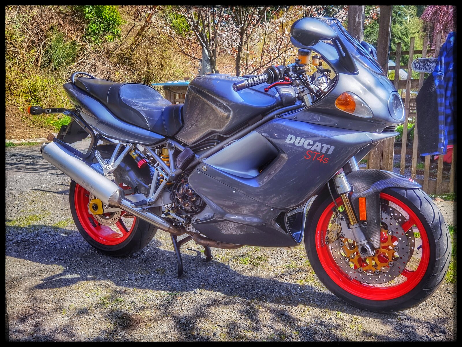

  6. A wolf in sheep's clothing. IMG_20210331_144905_edit_45575378108667-01.jpeg
  7. Hardly sheep’s clothing with those wheels, blimey they’re bright!
