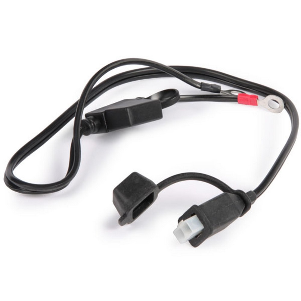

  9. Optimate cable? D'you mean the remote charge thing, thin cable with a little black connector on it? They're shit probably intermittent short bin it :upyeah:
  10. Yes it has an eyelet that connects to the optimate on one end a fuse in the middle and battery terminals on the other end. The thing is I have a new spare I bought by mistake and the spare does the same thing!?
  11. Take the battery off when storing for long periods and remove to a nice warm dry house, charge at 20% Amp rating every month with a quality charger and all should be tickety boo. Gel batteries behave very differently to the old lead acid batteries. Me thinks they need a little more TLC.:Wacky:
  12. Like this?
  13. That's exactly it. I even cleaned the contacts.
  14. Odd that both cables do it, your saying the clicking occurs with just this cable connected to the battery you haven't got the optimate connected as well?
  15. No the optimate isn't connected just the cable so I can tuck it away.
  16. Weird then all I can suggest is stick a multimeter on those extension cables & see if you can find a short, anything other than absolutely open circuit is bad
  17. Weird. How can two cables, not connected to anything else, do this...
  18. Exactly. I don't want to keep testing as I don't want to kill new batt constantly cranking and not riding. I'm thinking it must be the fuse in the cable. Although it isn't blown it must be affecting it some how.. Or the problem is some thing else completely and the cable is just the final straw
  19. They're directly connected to the batterys + & - so if there's any sort of short/resistance between the + & - it'll f'ck things up
