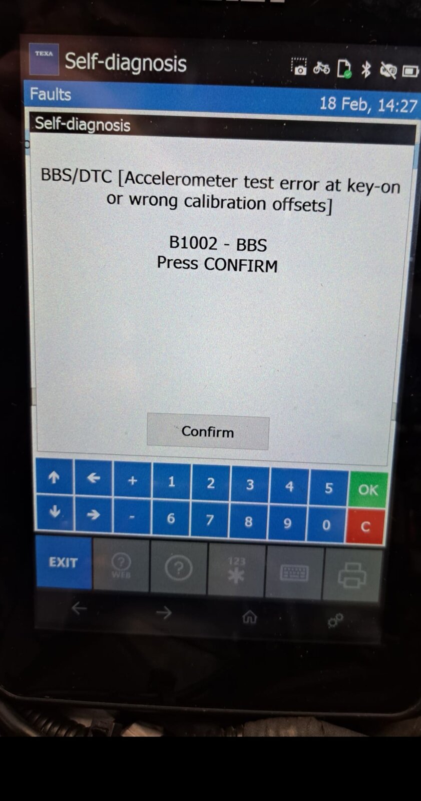

  12. Hi.. Anyone come across this fault in the photo? What does it relate to and how to fix?
    Thanks
