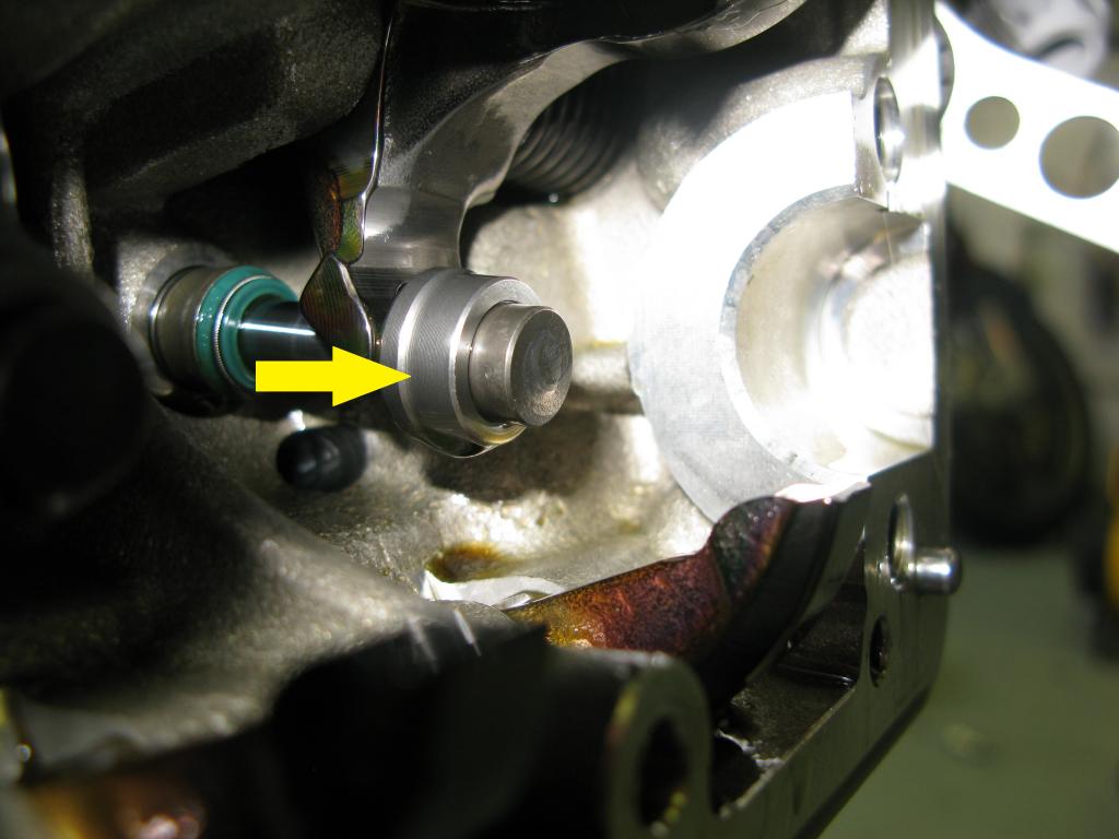

  1. I used the harmonic method using a guitar tuner on a laptop, I used Musical Tuner 1.2, I also verified it with a free App on my cell phone called gStrings, they both read the same frequency, I was surprised how easy it was to adjust the tension, I figured it was going to be difficult.
  2. In this pic the arrow is pointing at the closer shim.
