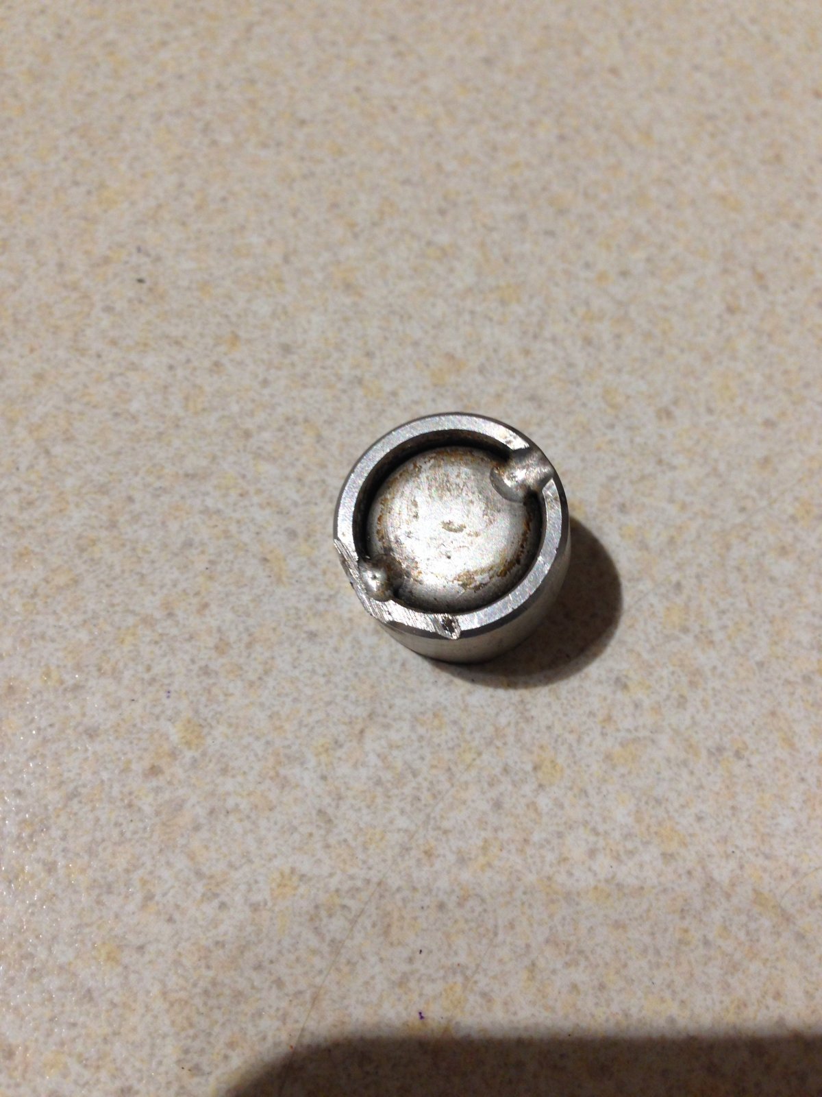

  7. Not too sure it will make much difference.
  8. [​IMG]
    Definitely a increase in noise and pops more on up shifts

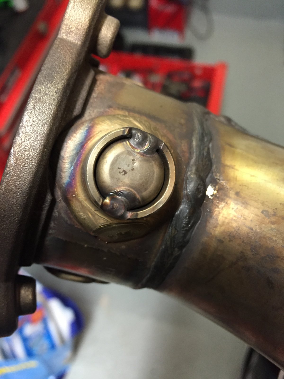

  9. How difficult was the spot welds to grind off?? Also how do you get the spindle out and then seal it up? Bolt and nut like on the video?
  10. It's a piece of piss, they're only little welds. You'll need a Dremel or similar to get in there though. The flapper and spindle drops right out, then you put a bolt with a nut and some washers on to seal it all up. Really not difficult at all, but not sure I'd want to take apart my exhaust system just to take it out if you've undone the cables already. Like I mentioned, I only did it as I had the system apart for fitting the termi's, I'm not going to do the same to my 899.

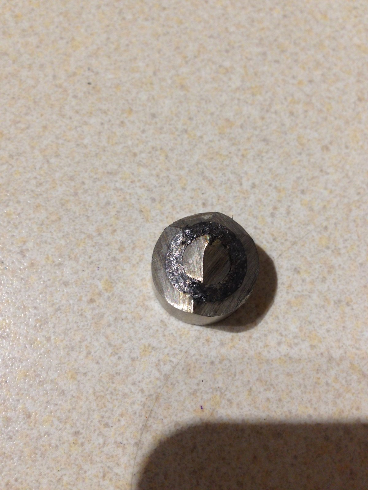

  11. It's not a difficult job today Dremel off the welds undo the screws if you can I had to grind the heads off in the end, to remove the spindle I cut it in two with the dremel and pulled the two hafts out finally sealed the hole with a M8 bolt

  17. What about the other side of the spindle? It's caped over but I can see daylight through where it's not welded
  18. Think il just take it to work tomorrow and weld both ends closed properly. Don't want to build it up and then find out it's leaking!!
  19. It's pretty solid, doesn't need welding :upyeah:
