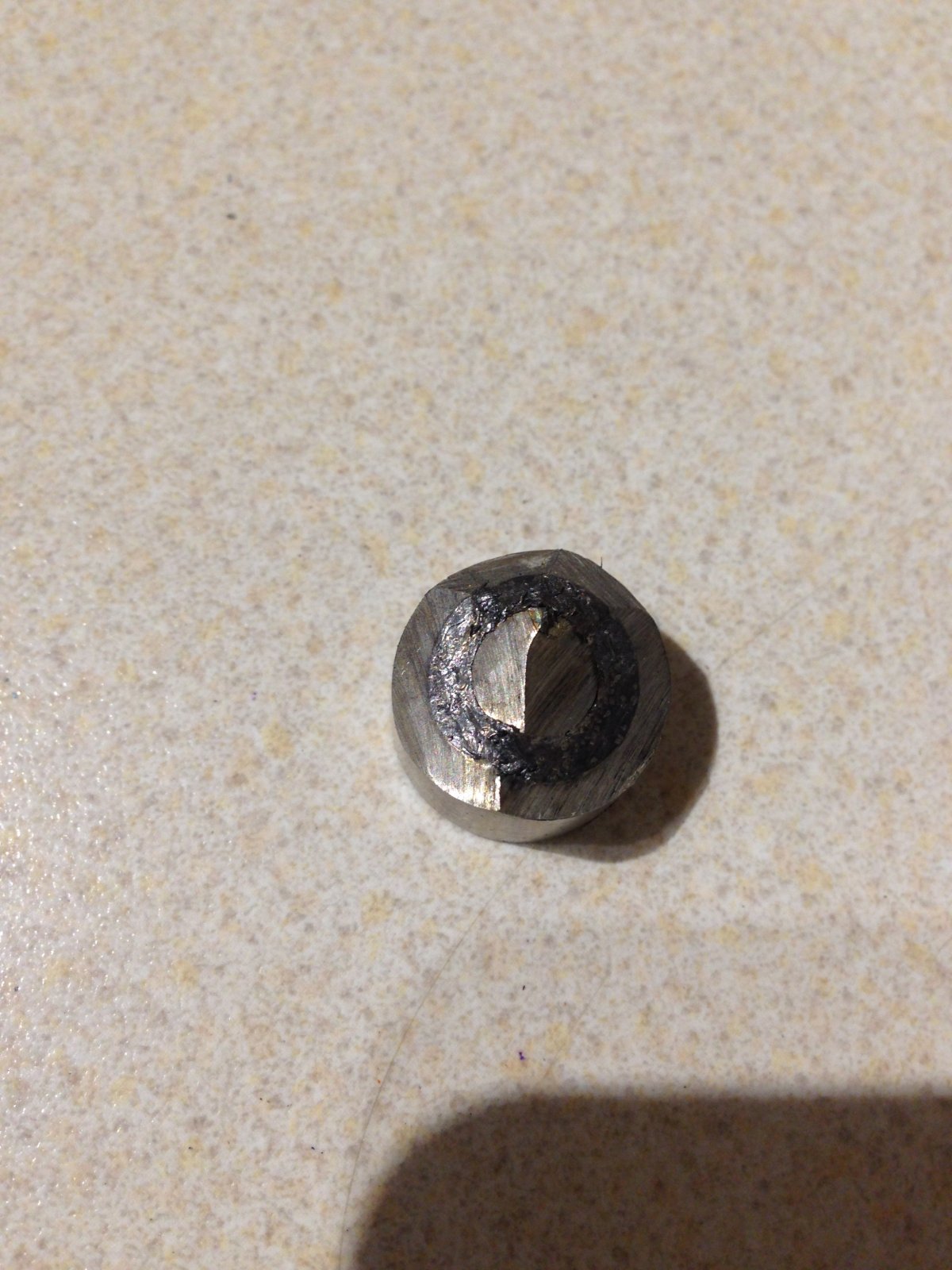

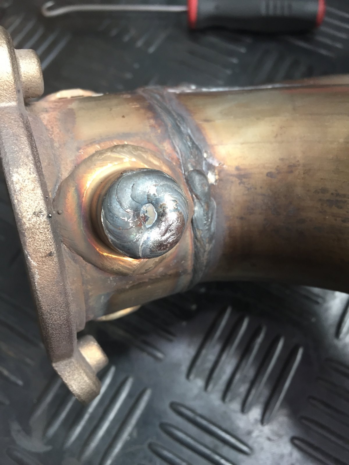

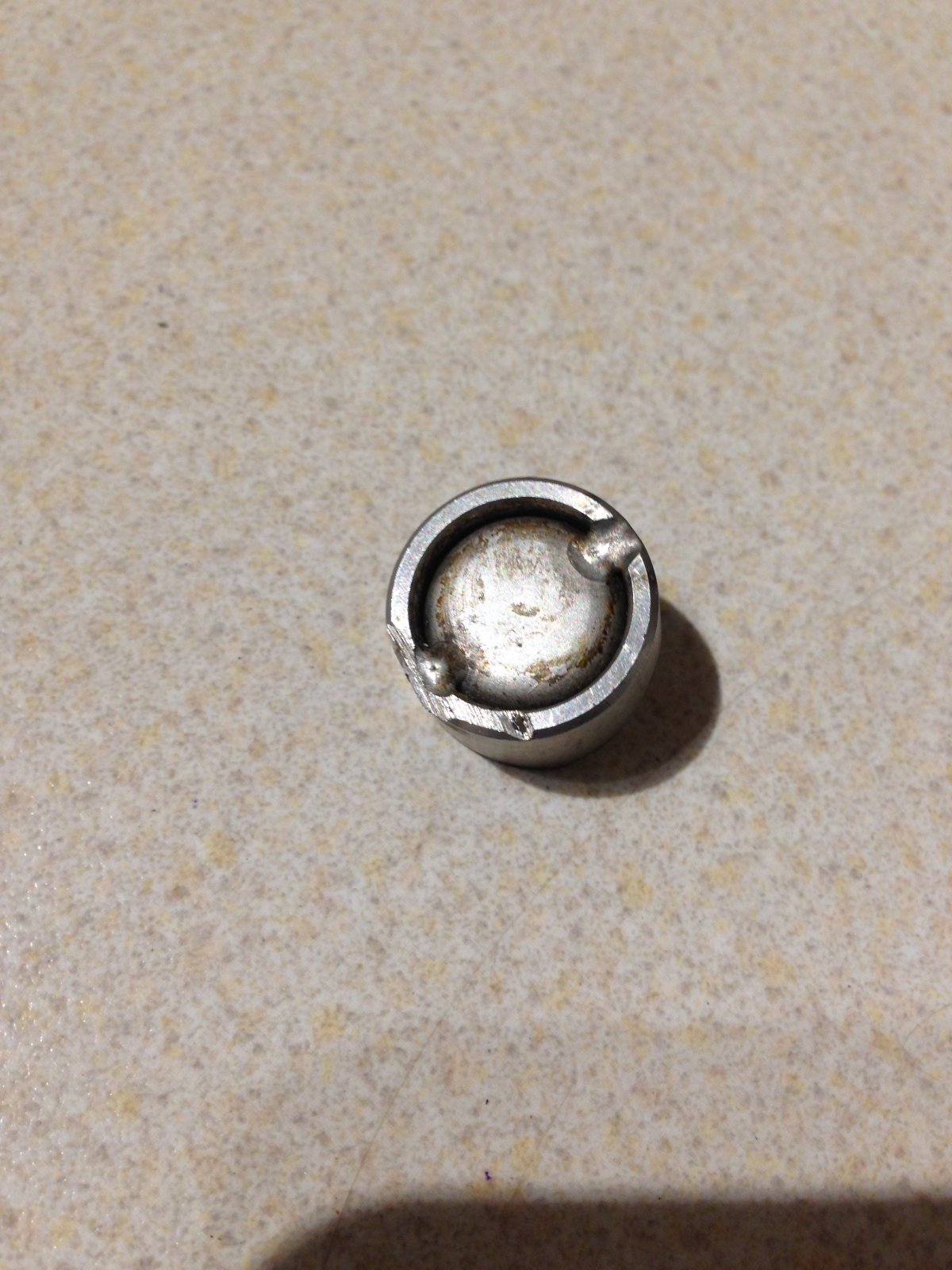

  1. That's because you have left a section of the spindle and graphite gasket. From an engineers view the only way to do it properly is the cap and weld.
  2. Actually I didn't leave anything really cos I cut the whole lot out :), still gas tight with spindle & bush removed
  3. Yous must be a better fit than mine then..... I can see daylight between the cap and boss
  4. You're probably right this was an older 1098 system, sloppy tolerances on the newer models :)
  6. Tip my hat to you sir..
    That is a good weld:upyeah:
