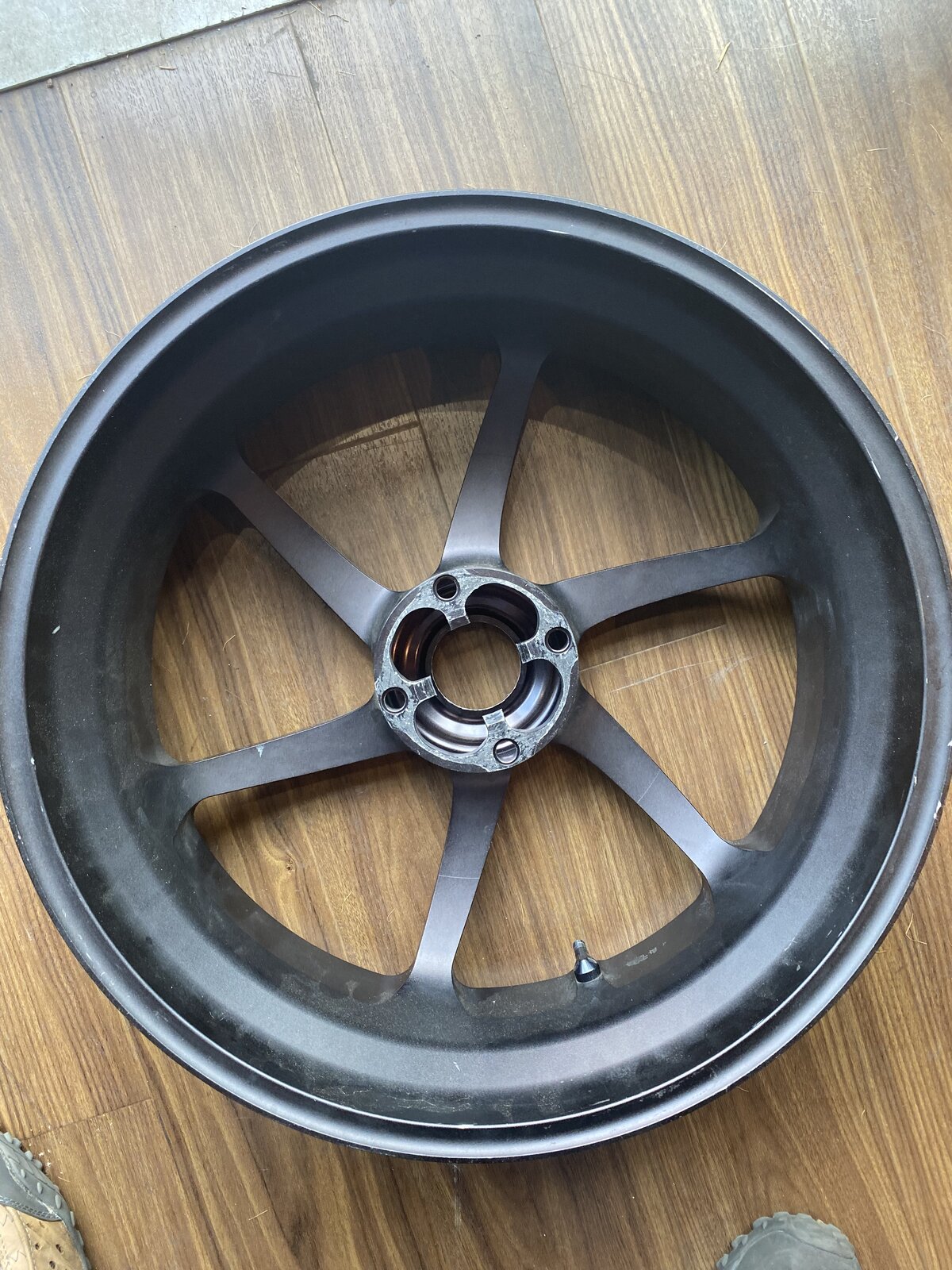

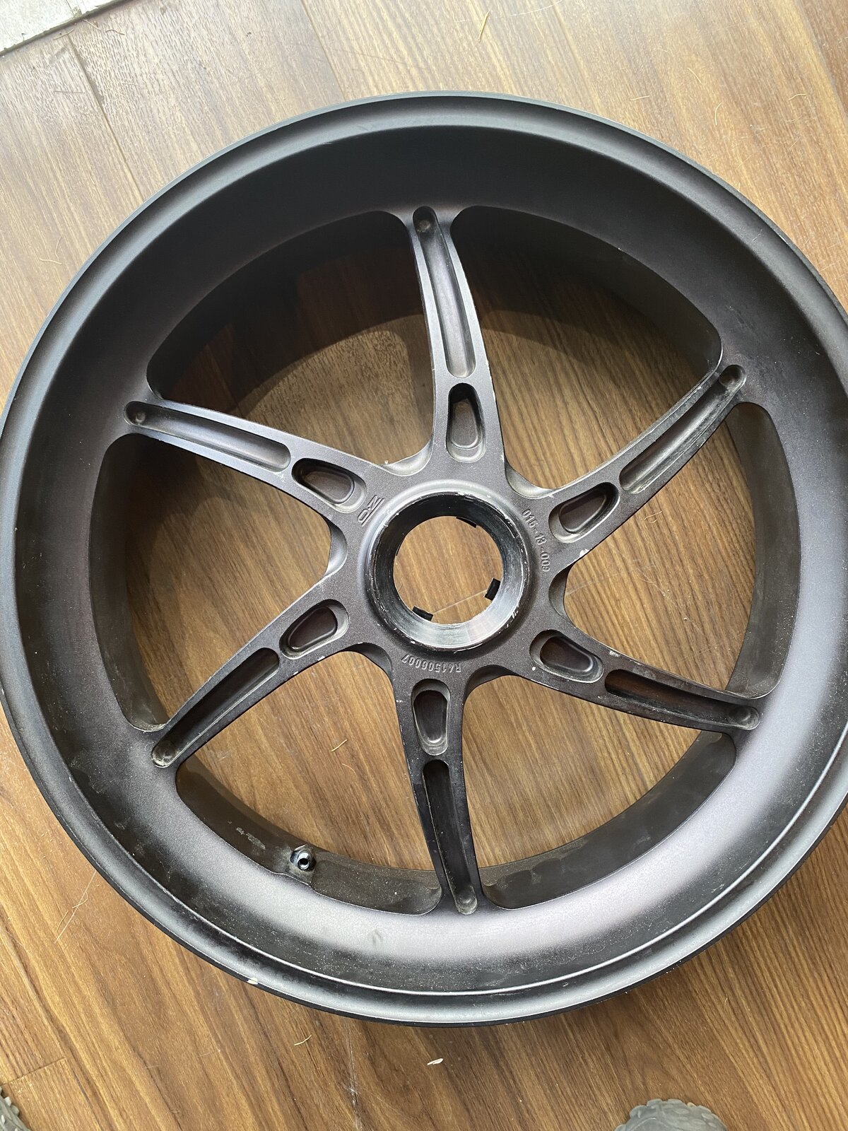

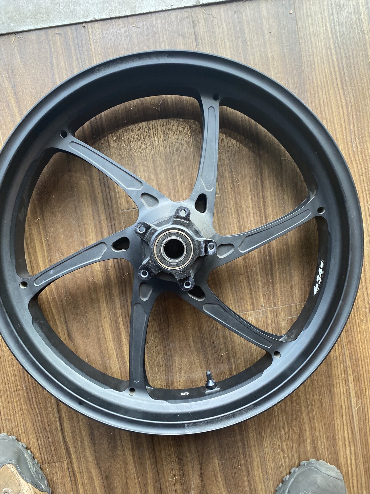

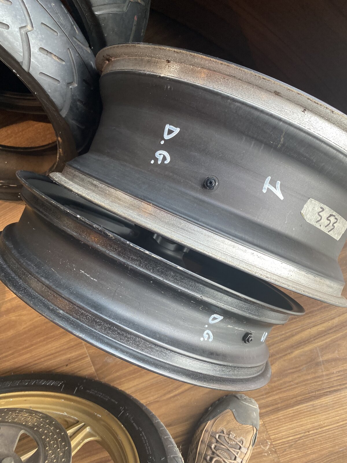

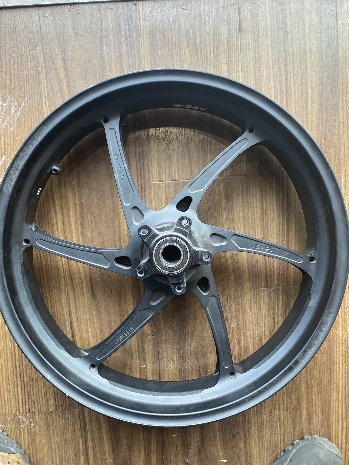

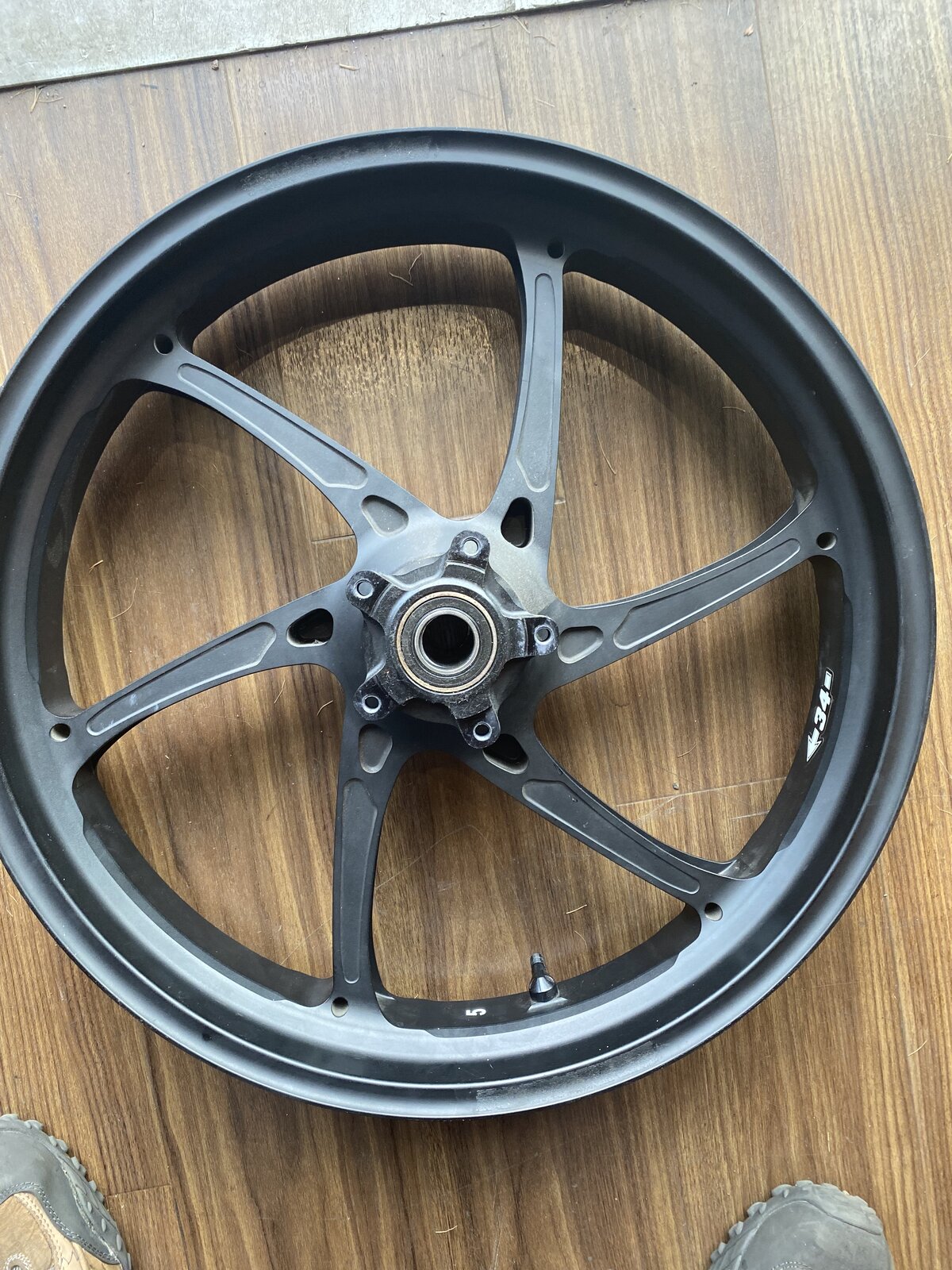

  6. Does the cautionary advice given during the course of this thread apply to forged magnesium wheels also?
    I’ve been offered some Oz Cattiva wheels for a decent price. They are claimed to be ex WSBK (Davide Giuliano - I had to Google him) Love the look of them but concerned about their durability.
    I heard Dave Hewson very briefly mention the mileage he had on a set of wheels in a recent YouTube vlog, but he didn’t expand further.
    CCD241D8-A9B2-45A4-B35B-835D6F8A0140.jpeg AB9EA7E0-BBA6-45B0-A9CD-BFFF0898497E.jpeg B91F1CD5-03F1-43B5-97D0-6E1A401A5FBD.jpeg 858CD3BE-D254-48C2-86BF-5CBE91BC8574.jpeg BB426DE5-BE50-49D1-9D66-243D77B88A3C.jpeg

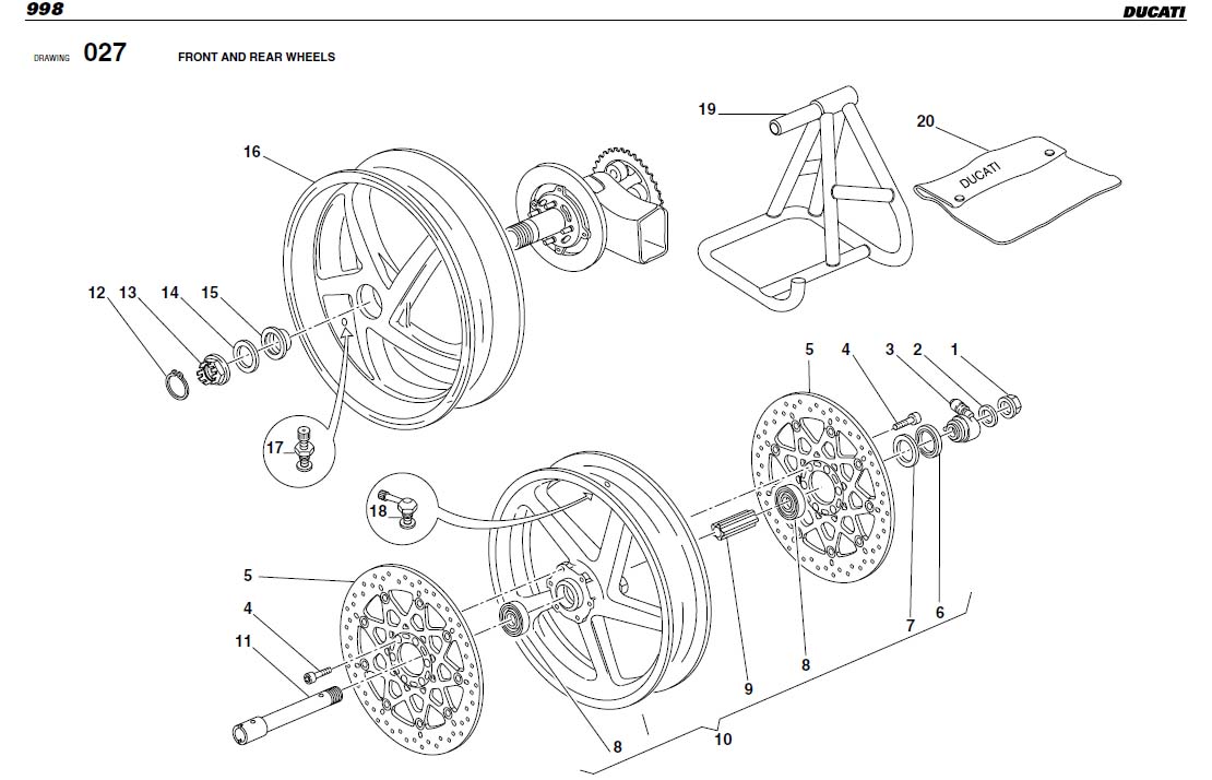

  7. These wheels don't include bearings, which is fine. What do I need from this parts diagram?
    I'm guessing qty (2) of part 8, qty (1) of part 9, and qty (1) of part 7.
    Part 6 is described as "Seal ring (sarchesini only)" (note the typo!) so I assume it's not needed for Marvics?
  8. Walk away. Genuine ‘race’ wheels are life limited and are returned to the manufacturer for NDT (at around 1500km in the case of OZ IIRC) before being reused or melted for recycling. Andy
    • Useful Useful x 2
  9. That’s interesting and helpful to know. I knew they where coming off a track bike, but I was not aware the where full on race wheels until earlier today. Looking on the Oz website, they spec the Cattiva as for road use, but I guess they supply higher grade? “not for road use” kit to those worthy.
  10. My understanding is they use the name of the closest road approved equivalent as a marketing tool. I know the Piega R is marketed as for racing but you only need to look at the bikes they fit to realise there's a bit of licence used. Andy
