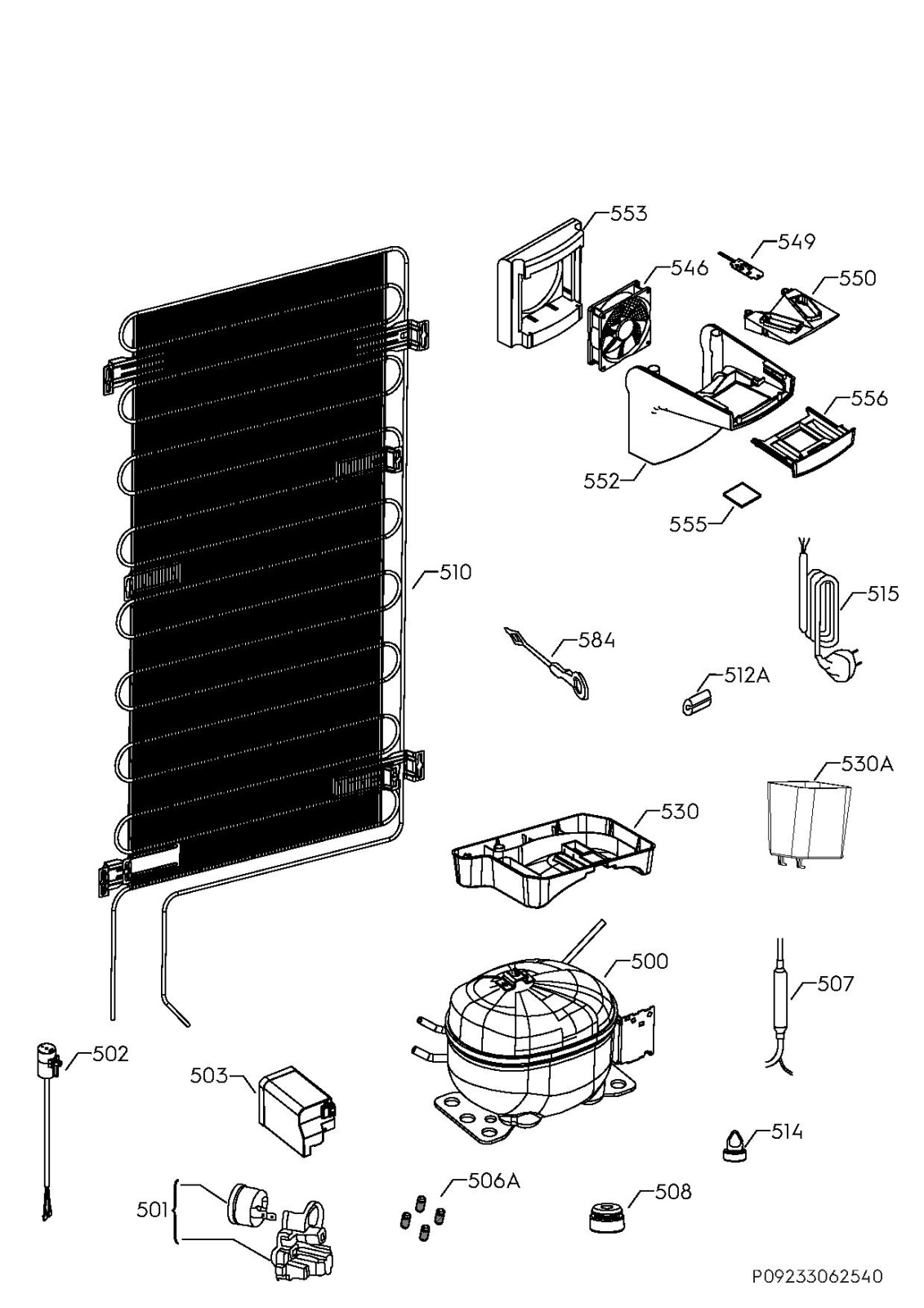

  5. I'm not a fridge mechanic, and would baulk at AEG's £169 fixed repair price to fix a LED, but looking at the AEG spare part looks like there could be some challenges fitting the new one, once the original part is removed, depending on how the wires are connected.

    The parts diagram shows the LED (549) sits in a tray (550) that sits in the housing (552), so perhaps you could search for better images of these parts to see if you can figure out how they are assembled.

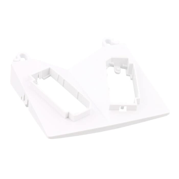

  7. Looking at that diagram doesn't it look like 550 has locations for two LED panels? if that's the case, and they're not wired in series, it points more to the switch that the LED.
  8. It does indeed, but the parts list is pretty vague about quantities required.
    The AEG website has quite a detailed parts list with photos of individual parts, and that suggests two LED modules, as you say, and if so, less likely to be an LED unit unless there was a power spike?

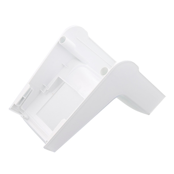

    Looking at the diffuser, the two formed slots at the top front (behind the cover panel EJ has already removed) seem to locate on a protruding hook like part in the fridge housing visible in the installed photos, suggesting the decorative cover disengages/engages by moving it fore/aft, rather than up/down, but I'd also try a feeler gauge between the fridge body and the two cylindrical fittings (which also look like a retaining feature preventing for/aft movement) on the diffuser, before giving the item a pull to see if it moves forward.
    Also looks like the LED holder has two formed clips, one on either side, adjacent to each LED slot, so perhaps you could get something in to release these clips and remove the LED carrier from the diffuser which may help, all depends on how long the LED wires are...

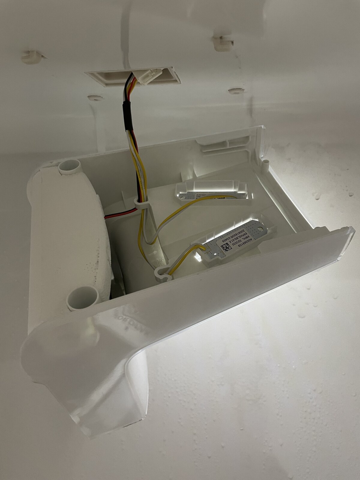

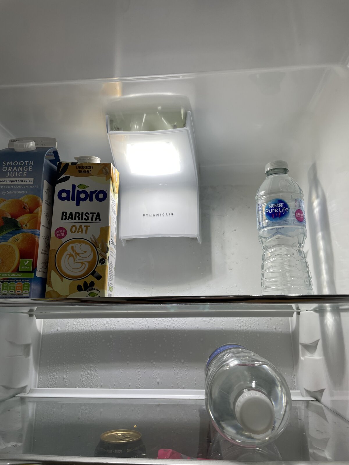

  11. It has two led panels. They work intermittently. Sometimes both. Sometimes one. Sometimes both then flicker off. I can’t see where the switch is yet.

    I have tried to get a feeler gauge up behind the conveyor and it goes all round apart from the two cylindrical barrels. I think it must be screwed to the roof. No obvious rout in from underneath either. Investigating more there doesn’t appear to be a traditional switch for the light. It must be run from the control board. I’ve tried to get into that and failed there too.

  14. Two concealed access holes up to a pair of torx drive screws. T20.
    Only thing now is I’m not sure it’s the leds themselves. I think it’s the control panel. I’m shit at electrics but have a multimeter. How do I test the leds please? Idiot proof instructions would be appreciated. :cool:

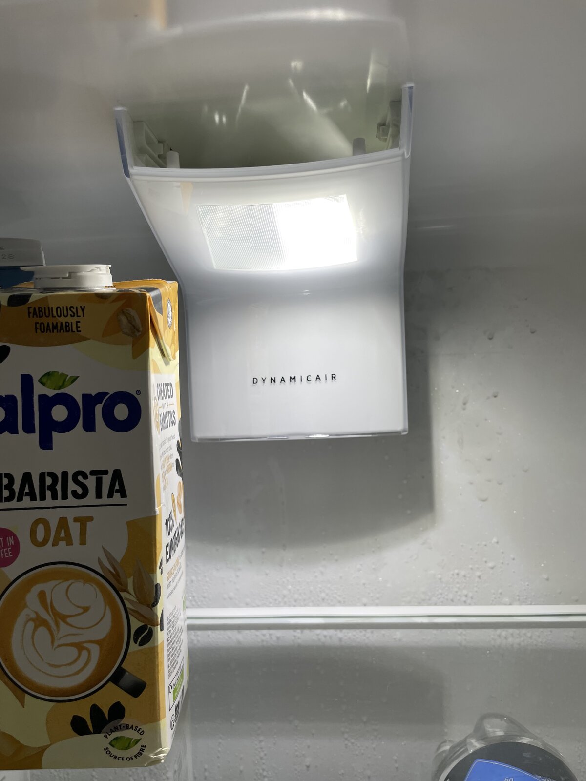

  16. Both LED's clearly working OK there!
    I think the chances of an intermittent failure of both LED's in a similar timeframe is remote, so would switch the fridge off, disconnect it from the mains, and then remove the light assembly at the white connector block. Visually check the harness for condition and give both sides of the connector block a clean with contact cleaner, and reconnect the connector but leave dangling. Switch on the power and see if it works. You could pop a mobile phone in the fridge on video record so you can see what happens when the door closes (saves drilling a hole in the door, or even getting inside the fridge!).
    If it works, the reassemble and see how it goes.

  18. Yeah. Both work then one stops or both stop. I’m going to try and inspect and clean first as you say.
