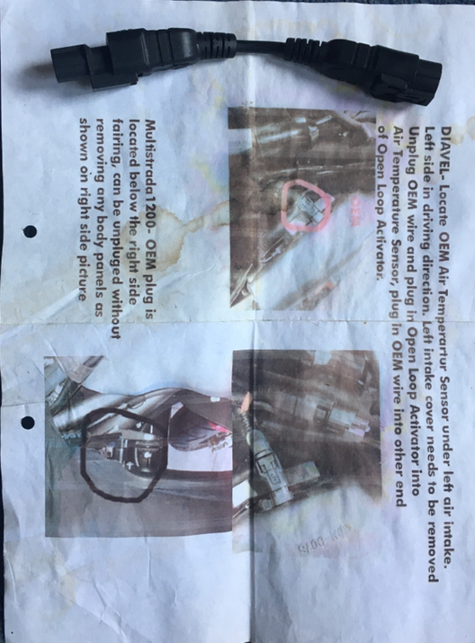

  1. This is an air temp modulator. Tricks the bike into running a little smoother. 63F37DF1-8FB2-4977-8C6D-194268596CD6.jpeg

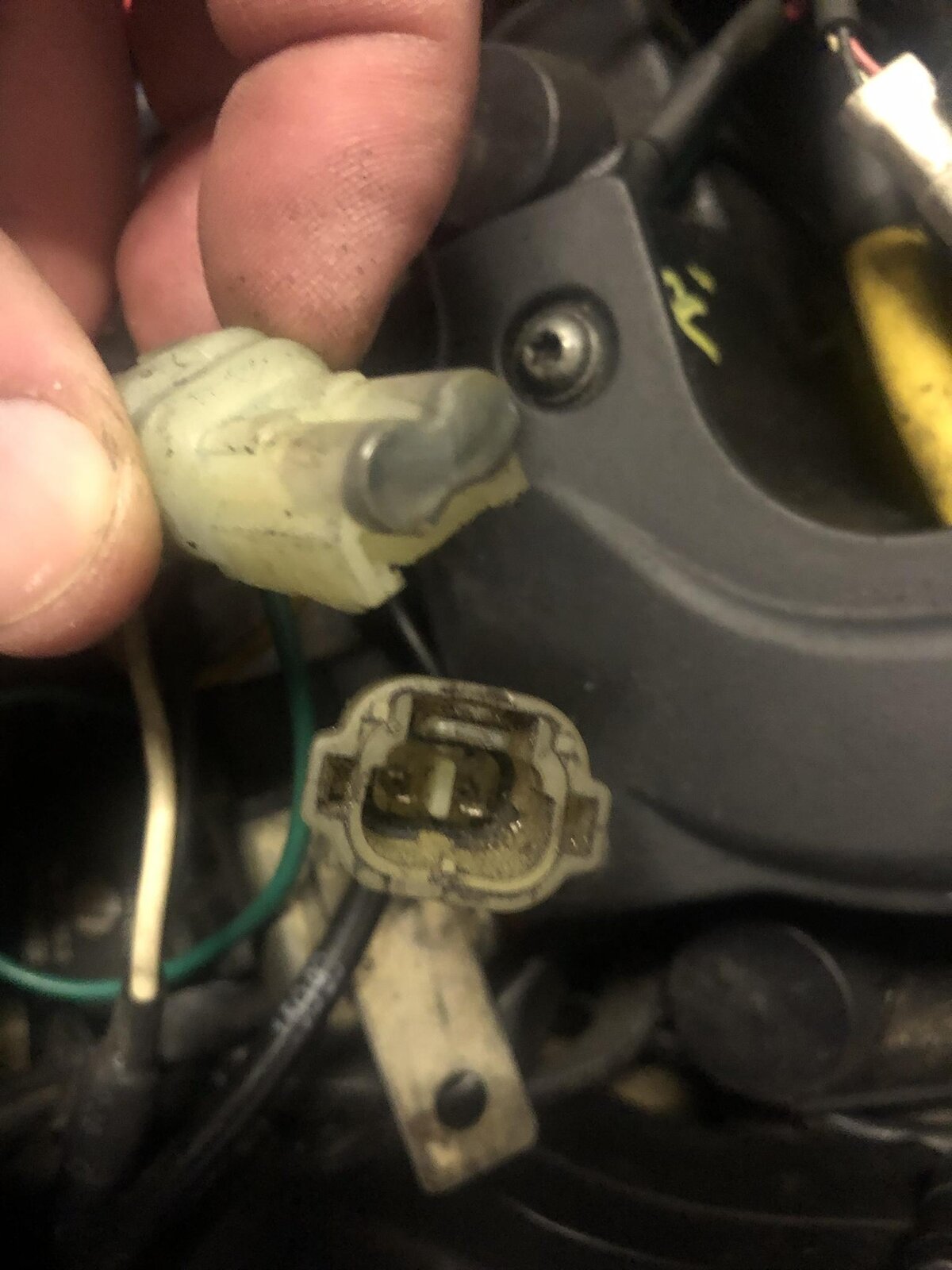

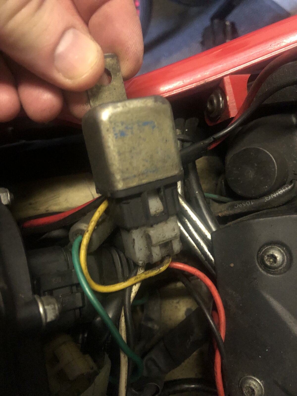

  11. Still trying to diagnose this, can anyone tell me what this relay is? It had a broken wire.
    Also, what is this connector? Both at the base of my fuel tank.
  12. Bumping this, I’d love to know what these are. I have a fuel gauge bypass fitted.
