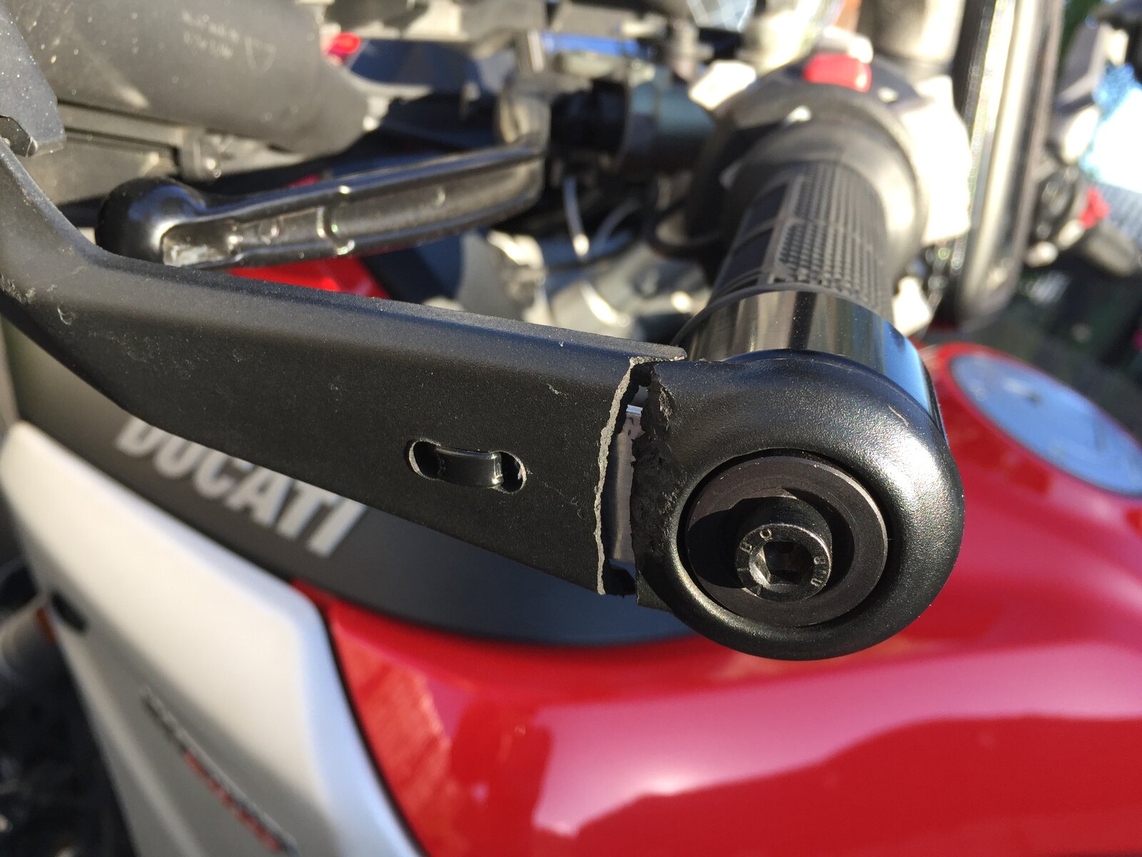

  4. I have now joined the broken hand guard club :pensive:
    Wheeling the bike out of the garage saturday, and didn't notice the side stand had been flipped back a bit. Consequence was the bike got leant up against a sheet of polystyrene that was stood against the wall of the house.
    Bizarrely I think if it wasn't there the hand guard wouldn't have broken, but the bar end pushed into it, and the guard snapped right by the bar end o_O
    I don't want bark busters, but looking at the bar end things at present.

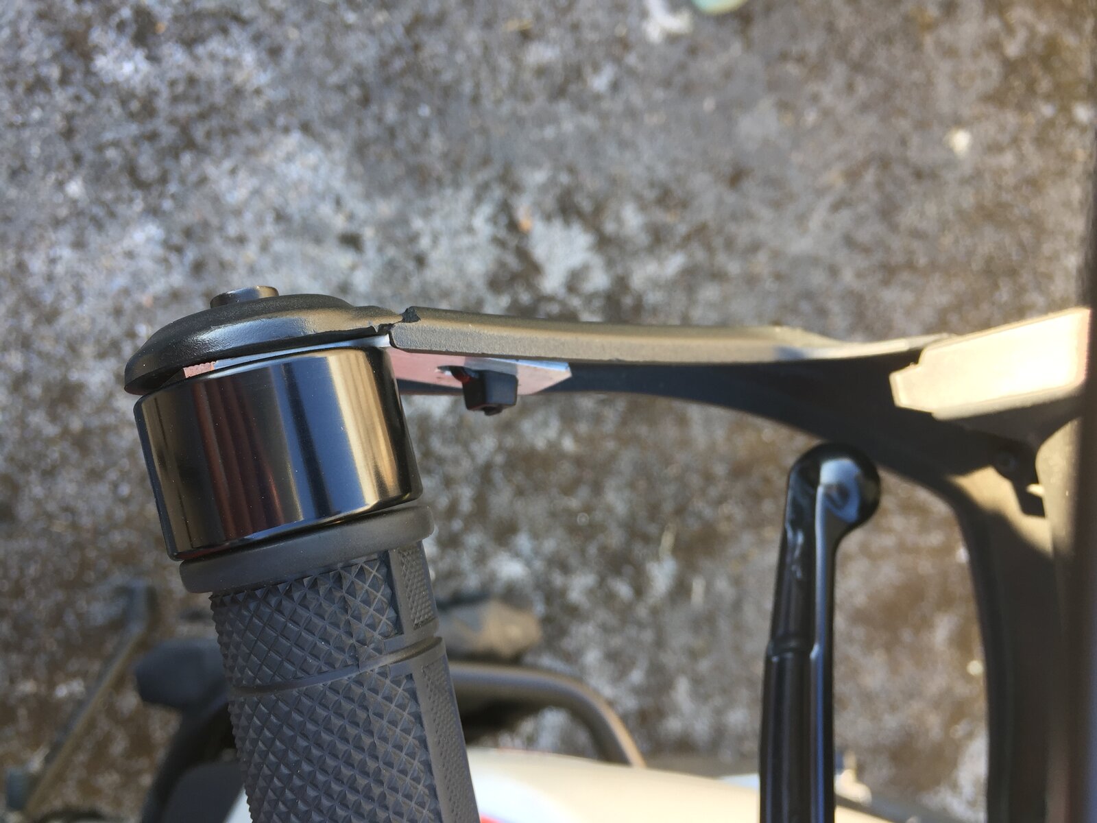

  12. Some pics of my repaired hand guard. Excuse the filth and dead stuff; I did about 500 miles this weekend, and haven’t had time to clean it yet.
  13. Incidentally, the ally repair is bent due to the subsequent drop! I now always carry cable ties, electrical tape, and some hefty pliers, in case the gear lever needs adjusting again.
  14. The break at the end looks similar to mine.
    I've made a template for now to make a plate to go inside the plastic, similar to you repair.
  15. You might find the brass threaded inserts inside your handlebar will want shaving down a bit - the bar end screw barely engages, so the addition of an extra thickness of material means the screw might not engage at all.
