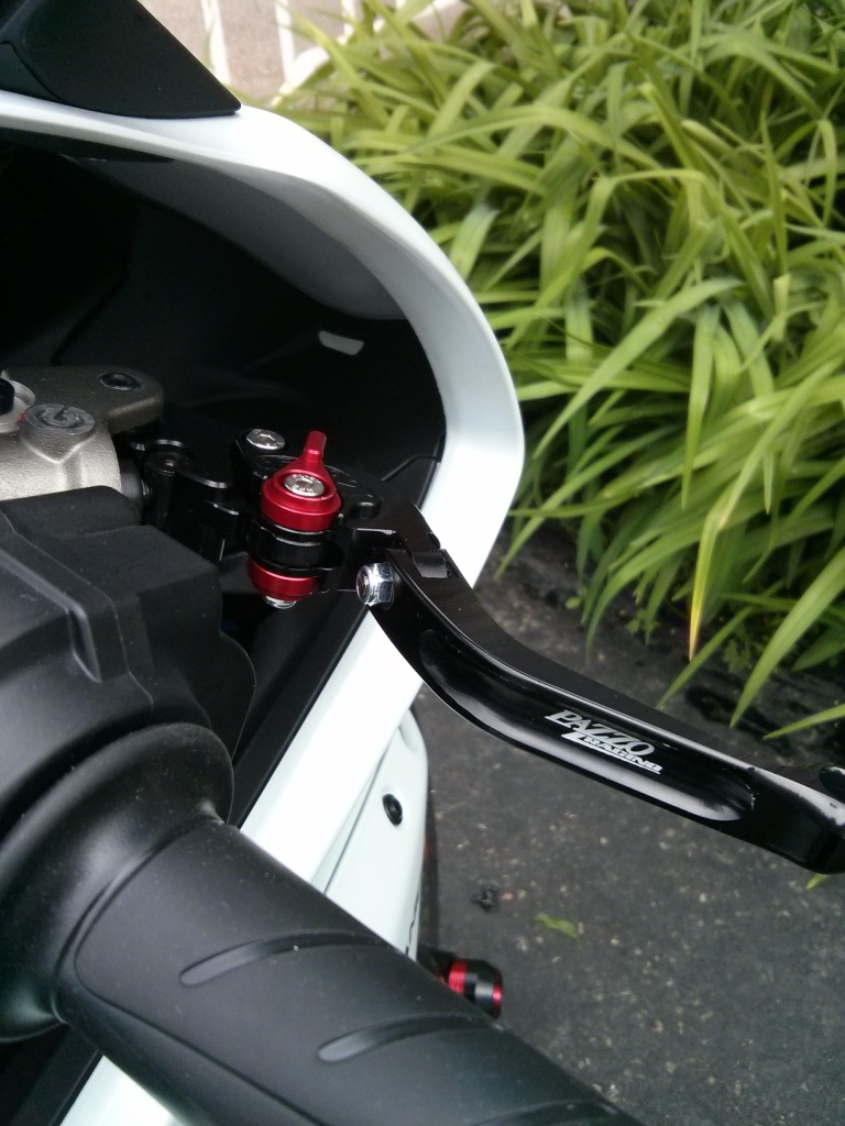

  7. I agree, they're not that expensive to replace. What I don't like about them is the poor engineering design as the clutch and brake reservoirs are attached to them.
    If lever protection is your objective, you won't find better than the folding type such as shown.
    Most quality lever manufacturer have such a model. I have ported these Pazzo's from my Panigale to my Multistrada.
