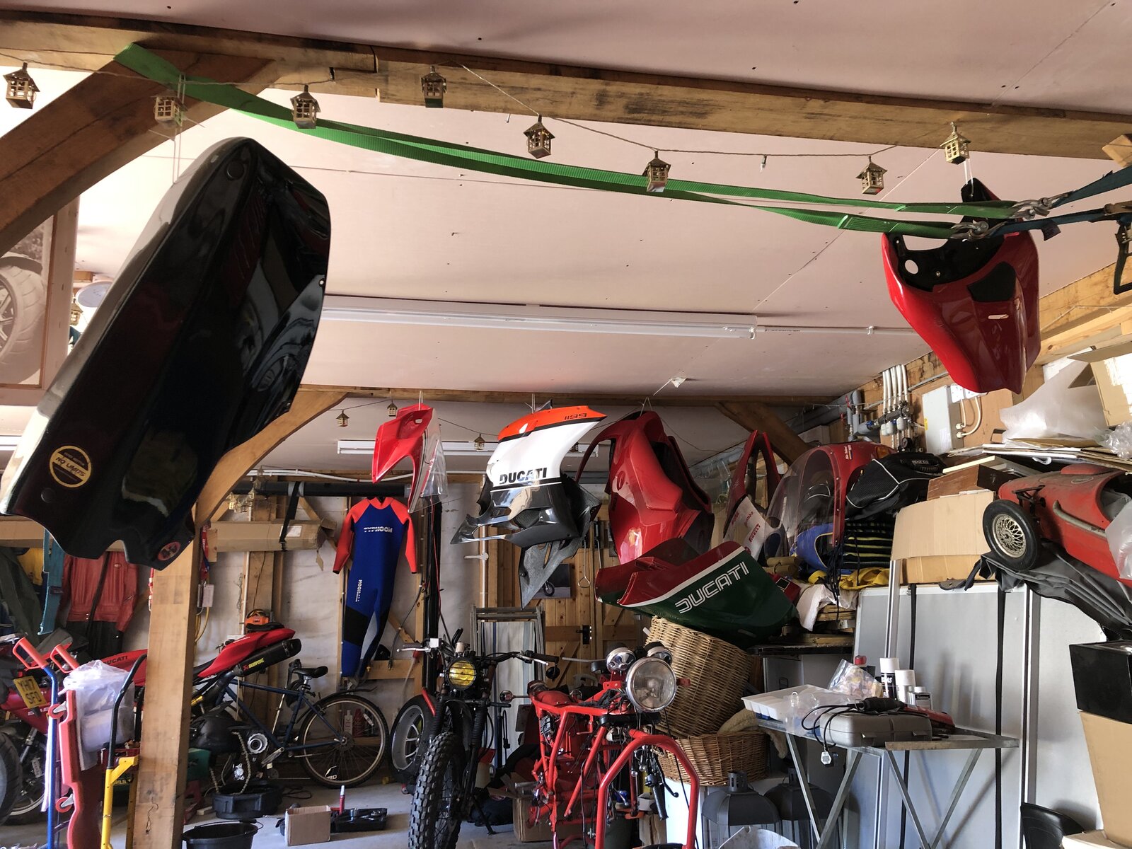

  6. When you spend as much time in the gravel as I do, it helps to have some spares hanging around.....:p
