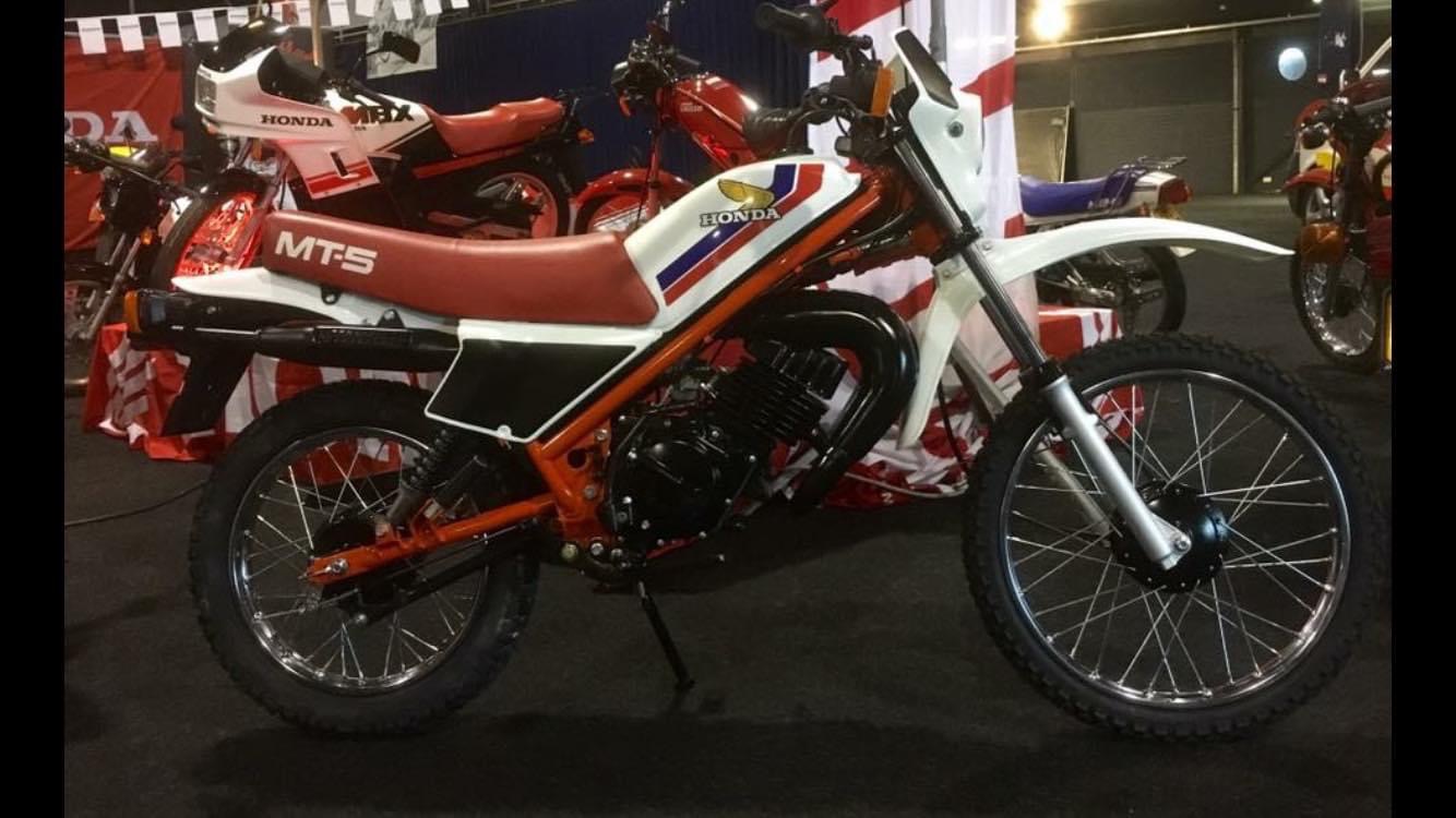

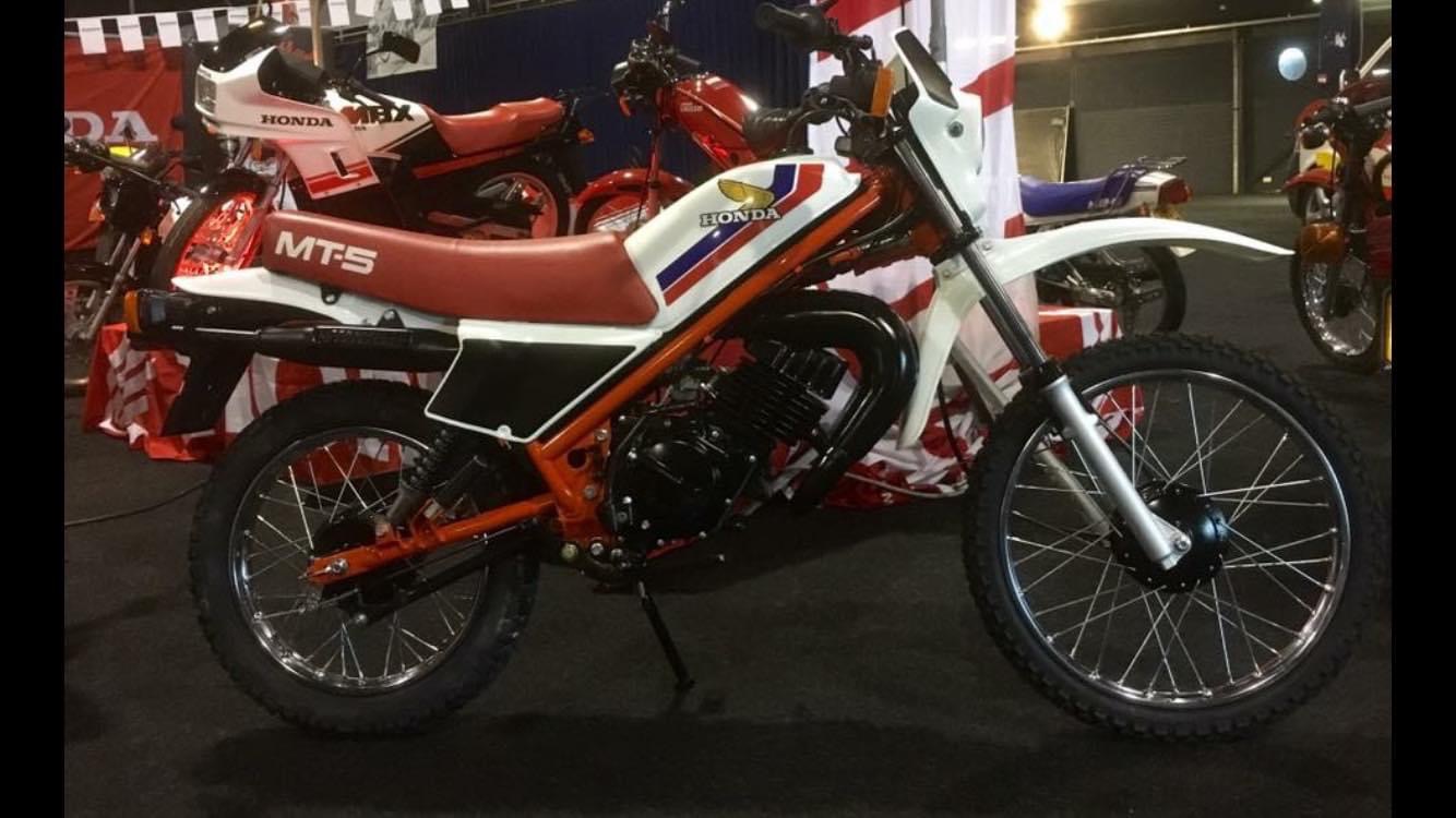

  6. Things have only changed a little bit in the last 35 years then :grinning:
    I had my own version at 16! I’m glad it never had any mechanical issues because my Dad isn’t very handy!
  7. The MT was a better bet than the MB.
