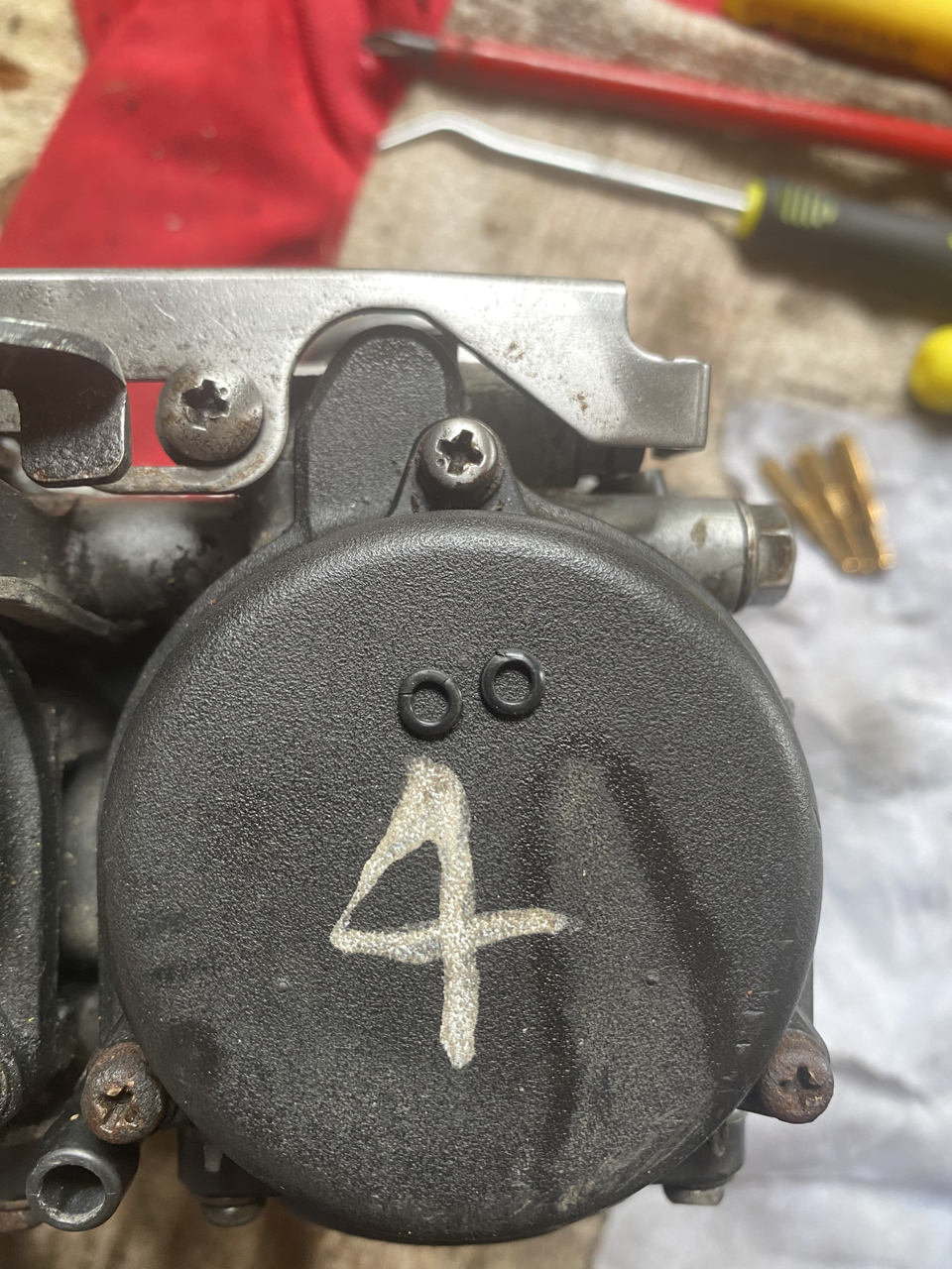

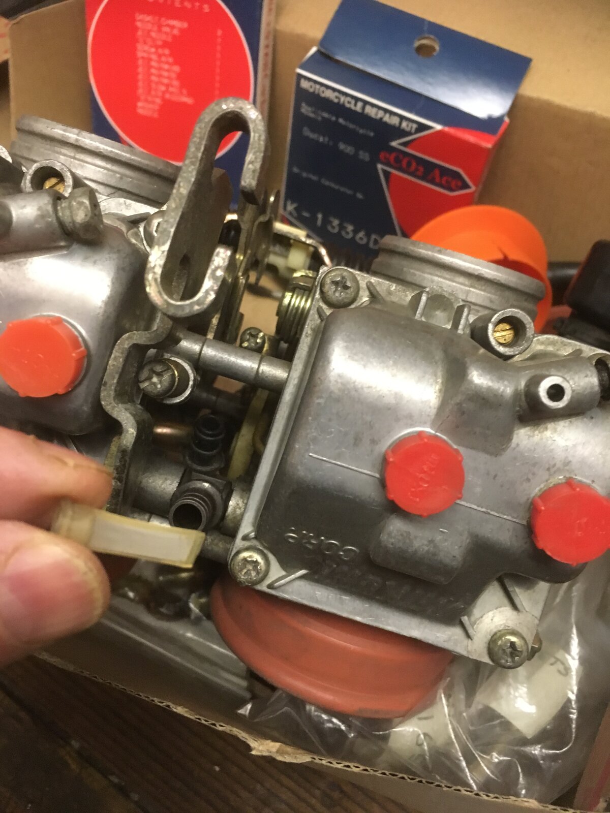

    I had a similar issue on a bank of 4, couldn't get the bike to idle cleanly it was always a little lumpy. Also the fact the revs didn't drop quickly enough when the throttle was closed indicated there was an air leak and it was running lean on the slow/idle circuit. I must have stripped those carbs down 3 times and rebuilt them but I never noticed the very slight damage to the o-rings until the final strip down. Lesson learned.
    I since bought a magnifying glass and made myself a promise that the next person who wants the carbs on their 25+ year old bike being balanced or some carburation issue sorted is going to be told I'm not doing it unless I can completely and utterly strip the carbs, including separating them, and fit new o-rings, gaskets, jets, needles etc etc throughout. Yes, it will add expense (time and parts) to the job but otherwise I've learned I could be chasing my tail. Those o-rings do go brittle with age IME.

    @West Cork Paul posted some useful photos of small "O" rings , above , which he politely describes
    as having " very slight damage ".
    Personally I'd be thinking totally and utterly ruined ( I was going to use an "F" word there )
    My point is that there are often quite a few of those little buggers inside carbs .
