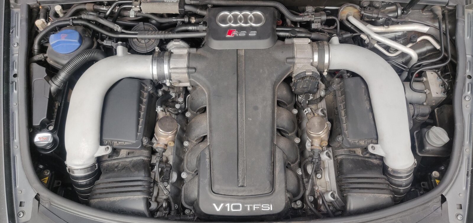

  4. Thanks. Part of it is how easy it is to work on Vs stuff like a V10 RS6 or V10 Phaeton. It's annoying but I can have the floats off and on again in about 20 minutes. Airbox moved, oil cooler lowered and they are right there. Getting to the injectors on this is a lot more work. Or doing the cams on the Phaeton. Step 1: remove engine and transmission (I didn't)

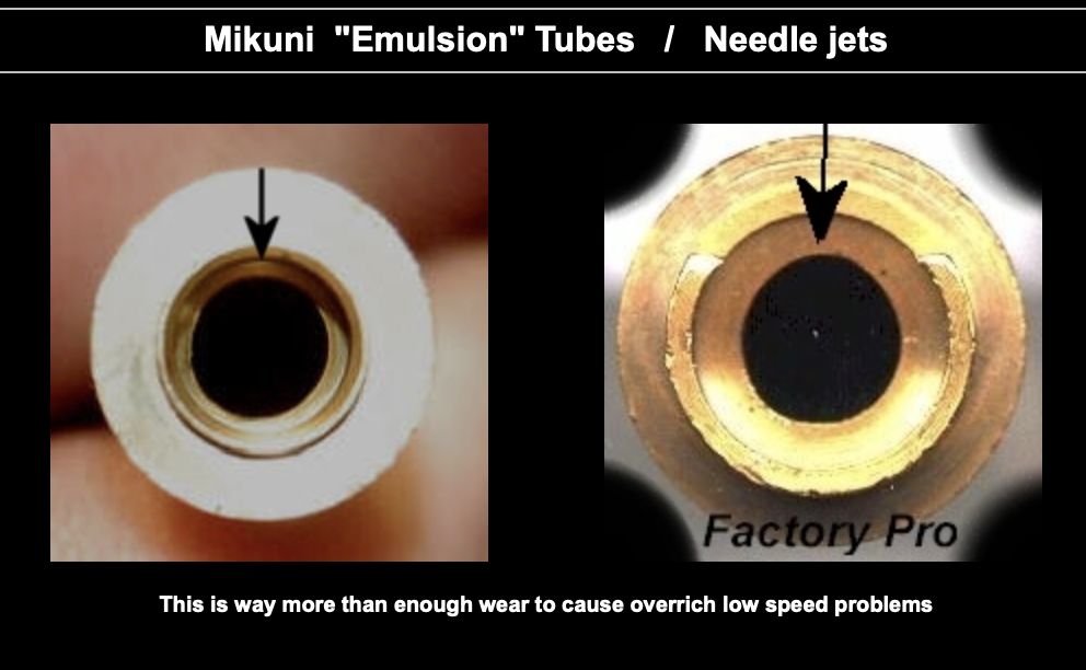

  11. I 've also been watching this thread and I'm impressed with your persistence Cammy. I owned a '95 900SS for about 5 years a while back. The carbs are the same apart from marginal changes in the jet sizes. My bike had Bos open cans and I ran it with a Factory Pro Stage 2 jet kit. All that really did was change the needles to a different taper and the springs above the slide were less strong, presumably so that the slides reacted quicker to a change in throttle opening. Factory Pro jets, unlike Dynajet, use the same sizing numbers as Mikuni. The bike ran fine with the standard 140 size main jets.
    However at around 18,000 miles it started to run poorly at smallish throttle openings, with a flat spot when opening up from a closed throttle. I found I could tune this out by leaning the pilot mixture but then the idle was crap.
    The cause was worn emulsion tubes (needle jets) which is a very common problem with Ducatis running Mikuni carbs.
    I fitted new emulsion tubes and all was fine again.
    I ran this bike a 14mm float height (some folks prefer a different level) and with the pilot screws 3.5 turns out and it was one of the sweetest running carburated bikes I've ever owned.

  13. Thanks Derek! That sounds very much like my problem. I'll pull them apart and see what's in there/how they look the week after next.

  14. This is the text from below the picture that Derek posted - I copied it to make it easier for people following the thread to find:
    It seems that you shouldn’t just replace the jets but also the plastic slide guide to prolong the life of the new jets.
    “Top Left side - This is a picture of the needle jet area of an emulsion tube from a stock 38mm CV Mikuni carb as installed on Ducati, Yamaha TDM/TRX 850, YZF750, FZR1000, etc..
    It has approximately ~5000 miles or 8000k usage on a Ducati or TDM 850 - WITH A STOCK Aluminum NEEDLE.
    Notice that the center hole is noticeably worn at the "V", the 12 o'clock position, which would be towards the engine, as installed in the carburetor.
    This causes 2 conditions. First, it allows more fuel to enter the carburetor, as in using a needle with a small base diameter AND the fuel that enters the carb - it enters in larger droplets, resulting in poor combustion.
    We carefully check needle jet condition on the vehicles when we create and install carb recalibration kits.
    If you install a kit and it is much too rich at low rpm, and lowering the fuel level 1mm doesn't fix it, check the needle jets for any wear - it's not uncommon.
    Additional:
    Eventually, in the 36mm horizontal mount and 38mm downdraft Mik's, the carb body plastic insert, where it holds and guides the slide from rattling back and forth, will wear out - allowing the slide to rattle and bang the needle fore and aft in the needle jet orifice - causing accelerated NJ wear. This wear is biased towards the lowered slide position - as in idle and low rpm areas - as in "in-town", "stop and go" driving.
    The gist of that is that you may only get 5,000 miles out of your needle jets in your VL / VS bike that you use for cruising 4th Street and hanging out at McDonalds - but your long distance , highway cruising buddy might get 25,000 miles before mileage deteriorates to 25mpg or worse.
    I haven't heard of anybody who has got the "60,000 miles" that some Tech Bulletin claims is normal with a stock needle...... I WILL change this if I ever find that person who made it to 60,000 miles on his/her VS / VL and has the original needle jets/emulsion tubes. In fact - I'll GIVE any carb needle jet rebuild to any VL 1500 owner who makes it to 60,000 miles on the original needle jets! Marc
    Slide Guide Wear:
    Example: The original needle jet lasted 5,000 miles in your usage. After replacing the worn emulsion tube / needle jet, they only lasted 3,000 miles or less. That's because the slide guide slot in the carb body is worn - not because of the emulsion tube or needle is bad.
    Even Suzuki knows that - even though their highly optimistic estimate of 60,000 mile life with a stock needle is based on perhaps a VL1500 or VS1400 run at high speed on a highway.
    A "step" inside of the needle seat in the carb slide?
    It's there in virtually every Mikuni CV carb. It's supposed to be there.
    It's to try to keep the needle bearing onto only one side of the needle jet - otherwise, the needle bangs back and forth onto both sides of the needle jet at idle and low rpm, instead on only one side.
    Of course, if one "notches" the plastic needle shim, they are lowering the needle about 2 clip positions and that will lean out the mixture, but that doesn't really permanently fix anything.”
